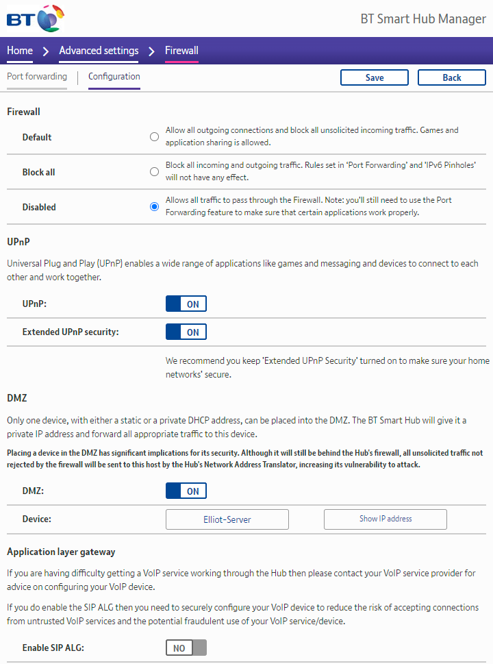

Carlo 4561 Posted February 22, 2023 Posted February 22, 2023 2 hours ago, kingmustard said: I just had a friend play a video until the issue occured. Logs attached. There is no remux log as it's was all Direct Play/Stream (though, as I said, the issue occurs with every type of video file). embyserver.txt 98.39 kB · 0 downloads hardware_detection-63812612947.txt 160.68 kB · 0 downloads I'm not sure what you're trying to show here but these are not settings I would ever recommend anyone use. Turn on your network firewall as it's your main source of protection. Turn off UPnP as it allows any device on your network to open and forward internet traffic to any inside device. With the DMZ server setup you are intentionally pushing all traffic not already forwarded to this server vs stopping it at the WAN. You're literally exposing every port on this computer to the Internet for anyone to hack as will. You should close up all the holes and then run a few different virus, malware and exploit checking software on every device in your LAN as they've been open to exploit.

kingmustard 14 Posted February 22, 2023 Posted February 22, 2023 8 hours ago, cayars said: I'm not sure what you're trying to show here but these are not settings I would ever recommend anyone use. Turn on your network firewall as it's your main source of protection. Turn off UPnP as it allows any device on your network to open and forward internet traffic to any inside device. With the DMZ server setup you are intentionally pushing all traffic not already forwarded to this server vs stopping it at the WAN. You're literally exposing every port on this computer to the Internet for anyone to hack as will. You should close up all the holes and then run a few different virus, malware and exploit checking software on every device in your LAN as they've been open to exploit. If you read the included embyserver.txt, there appears to be many PortMapper errors, so I included a screenshot of my router setup.
Carlo 4561 Posted February 22, 2023 Posted February 22, 2023 4 hours ago, kingmustard said: If you read the included embyserver.txt, there appears to be many PortMapper errors, so I included a screenshot of my router setup. You need to make changes to improve functionality as well as greatly improve security. Basically you need to remove the DMZ so you don't redirect all incoming traffic to a machine not setup for DMZ use. For best security of your network you want to disable UPnP as it makes it easy for any script or program to exploit your network. Unload the PortMapper plugin in Emby Server as it won't be able to be used with the changes just made. Now with a much hardened firewall in place not allowing any inbound traffic that wasn't first initiated from your LAN you will need to setup Poort Forwarding manually for a single port or two that allows traffic to your Emby Server. This knowledge base article walks you through what's needed for Emby use: (assumes firewall is active, no DMZ and UPnP is disabled). https://support.emby.media/support/solutions/articles/44002137137-remote-setup Hope that helps for security, remote Emby use as well as cleaning up the log files. This also removes any casting issues the DMZ might have caused if any. If you still have issues with casting to the CC after this we will have easier to read log files as well as know it shouldn't be network related.

kingmustard 14 Posted February 23, 2023 Posted February 23, 2023 18 hours ago, cayars said: You need to make changes to improve functionality as well as greatly improve security. Basically you need to remove the DMZ so you don't redirect all incoming traffic to a machine not setup for DMZ use. For best security of your network you want to disable UPnP as it makes it easy for any script or program to exploit your network. Unload the PortMapper plugin in Emby Server as it won't be able to be used with the changes just made. Now with a much hardened firewall in place not allowing any inbound traffic that wasn't first initiated from your LAN you will need to setup Poort Forwarding manually for a single port or two that allows traffic to your Emby Server. This knowledge base article walks you through what's needed for Emby use: (assumes firewall is active, no DMZ and UPnP is disabled). https://support.emby.media/support/solutions/articles/44002137137-remote-setup Hope that helps for security, remote Emby use as well as cleaning up the log files. This also removes any casting issues the DMZ might have caused if any. If you still have issues with casting to the CC after this we will have easier to read log files as well as know it shouldn't be network related. That fixed the Chromecast Ultra issue for me! I have no idea why it did but it did 1

kingmustard 14 Posted February 23, 2023 Posted February 23, 2023 (edited) 8 hours ago, kingmustard said: That fixed the Chromecast Ultra issue for me! I have no idea why it did but it did @wordlover Try adjusting your router settings and see if it works, as it did for me. Edited February 23, 2023 by kingmustard
