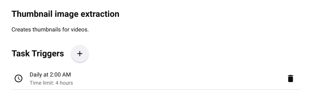

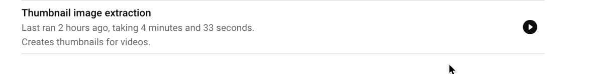

johoja12 4 Posted November 4, 2022 Author Posted November 4, 2022 1 minute ago, Luke said: When is extraction configured to occur? It runs everyday at 2am - but i also triggered it a few hours ago manually as well Screenshots attached
Luke 42245 Posted November 4, 2022 Posted November 4, 2022 When is it configured to extract in emby library setup?
johoja12 4 Posted November 4, 2022 Author Posted November 4, 2022 Just now, Luke said: When is it configured to extract in emby library setup? As a scheduled task
