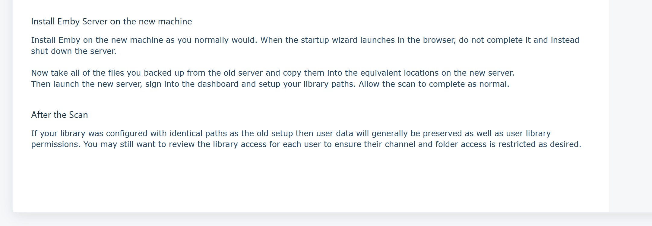

TheBigTeam 1 Posted November 5, 2022 Author Posted November 5, 2022 So I restarted today. I am following the instructions. However it says to copy the backup files to the new server, yet I am unable to paste them into the directory.
TheBigTeam 1 Posted November 5, 2022 Author Posted November 5, 2022 Anyone know how to grant permission to be able to paste my backup files? It is not allowing me to paste them. Unfortunately on the guide it says to copy and paste them but nothing if you run into this.
SamES 1084 Posted November 5, 2022 Posted November 5, 2022 (edited) I'm not quite sure which files you are copying. From this guide (Emby Backup :), which option are you trying to perform? Use the Server Configuration Backup Plugin How to Backup Manually I thought you were going with option 1 and restoring users and user data as per Luke's recommendation. Did you configure the backup location in the plugin (use your Backup Location)? Make sure the 'emby' linux user has permissions to this path and the folders/files If you get this right, then the backups will appear Edited November 5, 2022 by SamES
TheBigTeam 1 Posted November 6, 2022 Author Posted November 6, 2022 6 hours ago, SamES said: I'm not quite sure which files you are copying. From this guide (Emby Backup :), which option are you trying to perform? Use the Server Configuration Backup Plugin How to Backup Manually I thought you were going with option 1 and restoring users and user data as per Luke's recommendation. Did you configure the backup location in the plugin (use your Backup Location)? Make sure the 'emby' linux user has permissions to this path and the folders/files If you get this right, then the backups will appear This is what I am trying to accomplish. I cannot figure out why I am not allowed to copy and paste the files over to my new Emby Server. I am running Pop_Os, which is Ubuntu based.
SamES 1084 Posted November 6, 2022 Posted November 6, 2022 I know it’s not your immediate issue, but I’m not sure that manually migrating the library is a good idea when changing OS if you’re using the Plugin then you shouldn’t have to manually copy anything. That’s why I’m confused at what it is that you are trying to copy and paste.
