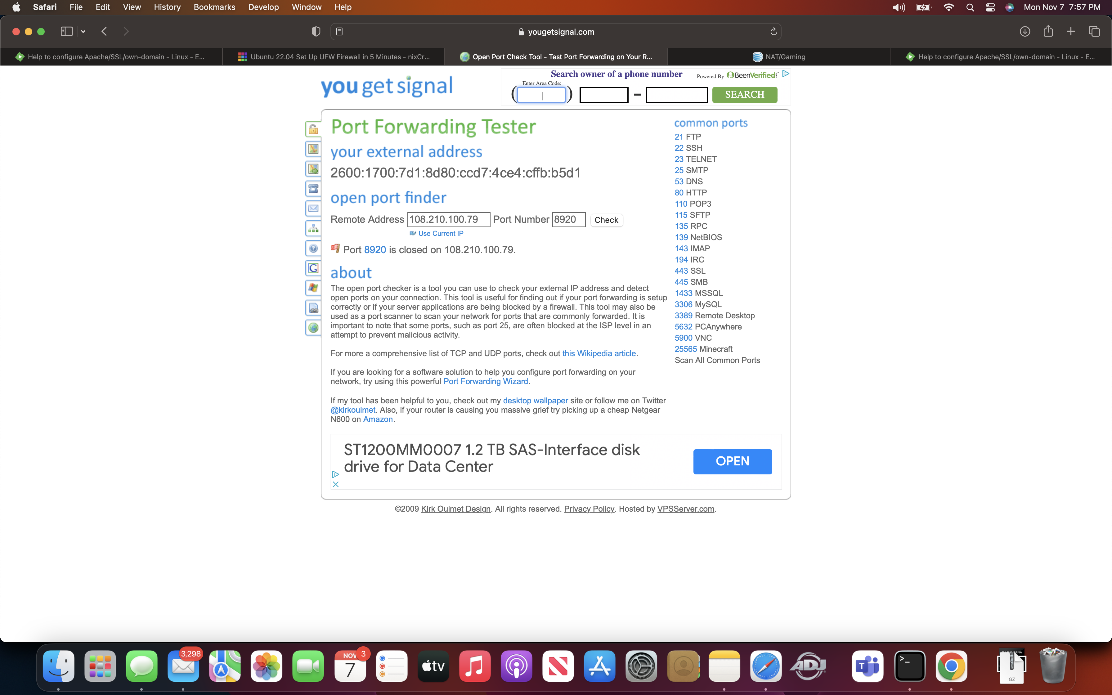

Painkiller88 250 Posted November 7, 2022 Posted November 7, 2022 (edited) i tried to open your server using the domain in your vhost config. opening with http://yourdomain -> nothing works opening with https://yourdomain -> gives me 503 service error opening with http://yourdomain:8096 -> works for me and gets me to the login page after a few seconds after seeing the logo opening with https://yourdomain:8920 -> nothing works So i checked your open ports: 80 -> is closed (not a problem) 443 -> is open but is not your emby port 8096 -> is open -> this is why i can connect using normal http 8920 -> is closed -> this is what you wanna open to get a secure connection to your server So open the ports 8920 and point it to your emby server, and check if it is working. If it is still not working: I also think there is a problem with your vhost config for *443 try replacing https with http, i know you wanna have the secure connection here but i checked a apache sample config for this and i saw, in both configs 80 and 443 for proxy_pass they use http source: https://www.digitalocean.com/community/tutorials/how-to-use-apache-http-server-as-reverse-proxy-using-mod_proxy-extension if this is working try to close the 8920 port because normally with a reverse proxy you shouldn't need to open all the ports. So as you can see, there are many ways to reach your goal, just try them and choose what you like the most. INFO: try accessing your remote address from your phone outside of the wifi, some modems does not allow you a loopback to access the public ip from inside the network. I hope i could help a little bit Edited November 7, 2022 by Painkiller8818

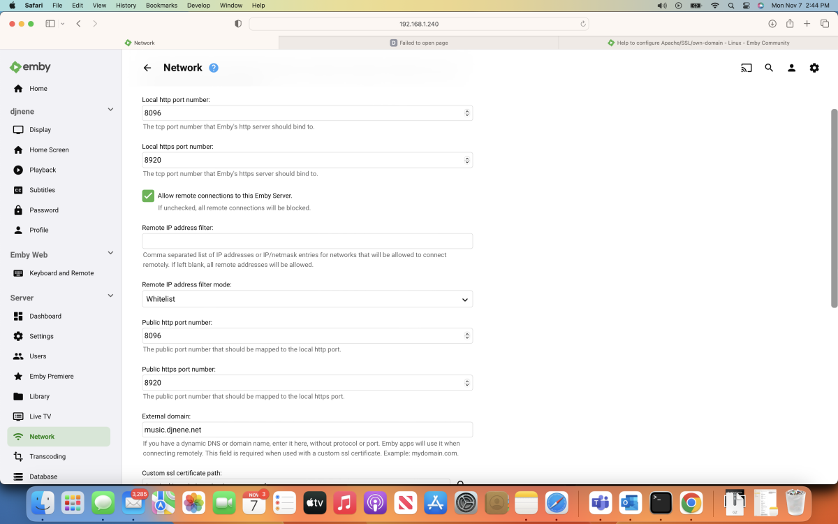

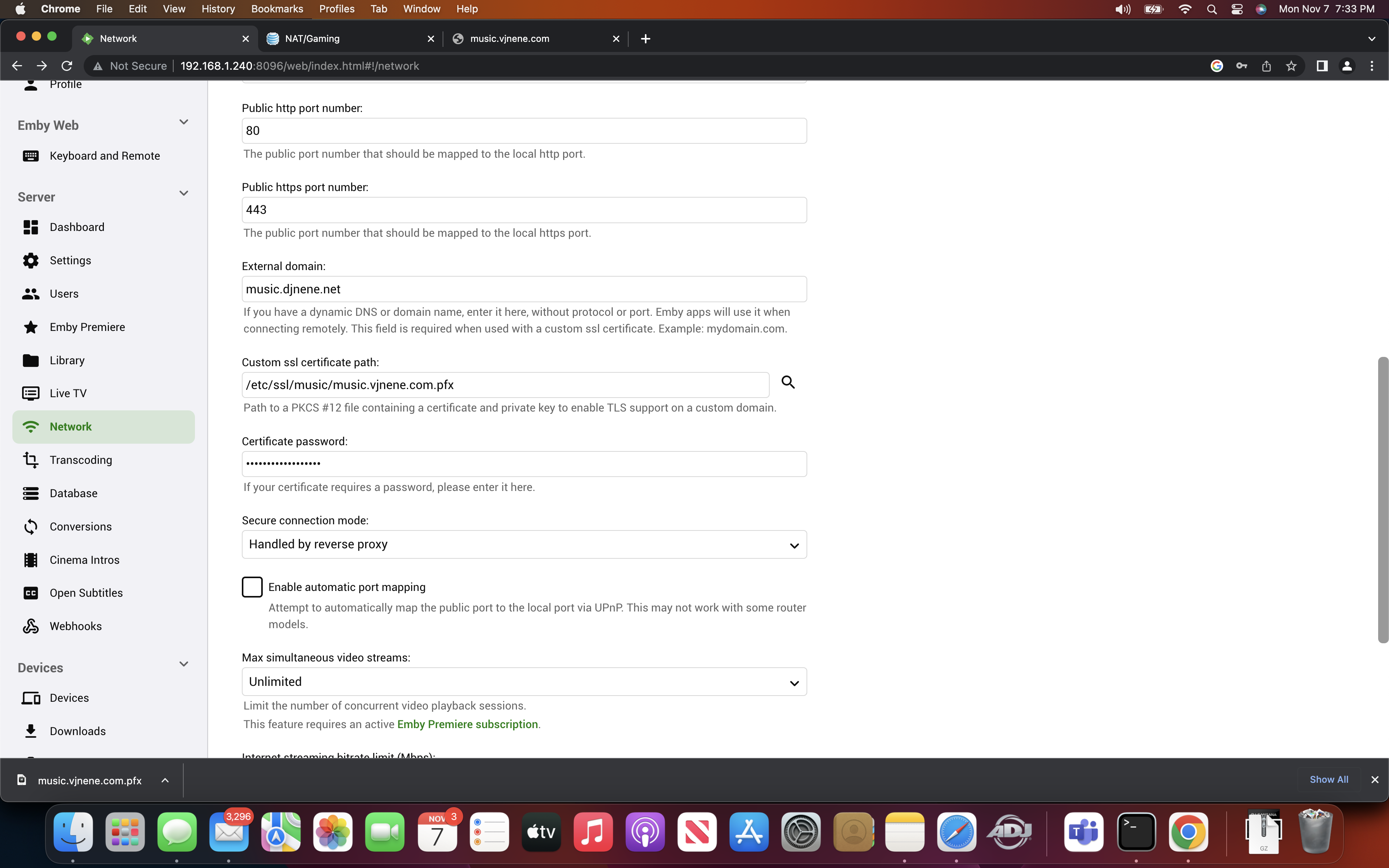

Q-Droid 1011 Posted November 7, 2022 Posted November 7, 2022 The public ports in Emby network settings need to match your virtual host ports and the WAN side ports. The local ports are fine. The https proxy pass should be referencing the http port. Actually both of the proxy sections in the virtual host should be referencing the http port unless you setup a certificate in Emby AND tell Apache to not validate the cert. If you really want to have end-to-end encryption it is doable but more complex, usually not needed. Emby should be configured to Secure Connection Mode - Handled by reverse proxy. Without a certificate setup in Emby it won't listen on 8920.

vemilla 1 Posted November 8, 2022 Author Posted November 8, 2022 Q-Droid I have try opening my port 8920 on my server by doing sudo ufw allow 8920/tcp and I have even opened it in my router firewall just for testing purposes. when I check if the port is open it says is closed. Don't know what I'm doing wrong?

vemilla 1 Posted November 8, 2022 Author Posted November 8, 2022 I have recreated the pkcs #12 pfx file reload it to my server. changed the user ownership to emby:emby w/ 644.

Q-Droid 1011 Posted November 8, 2022 Posted November 8, 2022 Now it's listening on 8920 so you're past the pfx problem. Your server should be responding on port 8920 internally and if your port forwarding is right then you should be able to access remotely using your domain. You won't get SSL support on port 8096 as it's the http port. If you didn't change the proxypass directive from https to http it's likely why you get this error. Now, are you using Apache for a reason, as in you already use it for other things? If this is something new to you and you're trying Apache because you came across some examples online then I would recommend trying Caddy instead. It is orders of magnitude easier to implement. But even Nginx will have more useful Emby specific examples available.
