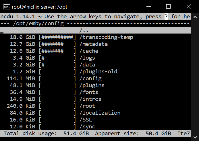

ShadowKindjal 21 Posted January 11, 2023 Author Posted January 11, 2023 3 hours ago, rbjtech said: So that network equipment should not have any IP queue issues. Is see you are just using http - is this via emby directly (port forward) - you are not using any Reverse proxy etc My emby server is behind an nginx reverse proxy 3 hours ago, rbjtech said: A quick look at the log has revealed that you are low on disk space for the transcoding folder - is this on the SSD ? Yes, this is on my boot SSD. I have to monitor my disk space because the transcoding-temp folder doesn't always delete old files. I currently have files in this folder dated back to November. It's been creeping up and I just need to clear it out again but it's annoying. I believe I've reported this issue in the past. 3 hours ago, rbjtech said: You had what looks to be 26 x transcoding sessions in parallel - if all of these were writing to the SSD then there may be a good chance of it struggling. I'm unsure what OS you are using - but something like Performance Monitor in Windows will show the disk queues in real time (the blue line on my disk #8 below) - if this goes above 2 - then this signifies the disk is the bottleneck. In my case, I transcode to the O drive (and nvme SSD) - I see no queues at all (it stays at zero) but this is just a single transcode, not 26 transcodes - Disk H: is a SATA disk. I think you'll just need to monitor things as you get loaded and watch for areas of concern - do some screen captures of this and it will certainly show where the hot spots are. You can look at all areas with this tool - disk, network, cpu etc - all will be monitored in real time. Thank you for this insight. I ordered a gen 4 NVME SSD (WD SN850X) that I will be installing before the week is up. Hopefully that will resolve my bottleneck issues. In regards to my OS, my setup is Ubuntu 18.04 but my whole stack is configured with docker-compose. I'll have to research a similar utility to measure queue times in Linux. 3 hours ago, rbjtech said: You are also running a PersonNfoprovider refresh at the same time ? I would schedule this for out of hours. I think you're referring to the metadata scan event? If not, please elaborate. I currently scan my metadata folder nightly at 1:00am.
rbjtech 5335 Posted January 11, 2023 Posted January 11, 2023 6 minutes ago, ShadowKindjal said: My emby server is behind an nginx reverse proxy ok - worth checking this config to optimise the latency - - as in the back of my mind, I think this has a lot to do with it .. 8 minutes ago, ShadowKindjal said: Thank you for this insight. I ordered a gen 4 NVME SSD (WD SN850X) that I will be installing before the week is up. Hopefully that will resolve my bottleneck issues. In regards to my OS, my setup is Ubuntu 18.04 but my whole stack is configured with docker-compose. I'll have to research a similar utility to measure queue times in Linux. The nvme on a different PCIe bus will undoubtably help - but unless you are surpassing the SATA3 bandwidth (for the current SSD) in your transcode streams + all the other workload on that SSD - then I'm not convinced.. Fingers crossed. 1
ShadowKindjal 21 Posted January 11, 2023 Author Posted January 11, 2023 15 minutes ago, rbjtech said: ok - worth checking this config to optimise the latency - - as in the back of my mind, I think this has a lot to do with it .. A lazy man's way to diagnose this would be to access the server over the local IP if it acts up again, right? 15 minutes ago, rbjtech said: The nvme on a different PCIe bus will undoubtably help - but unless you are surpassing the SATA3 bandwidth (for the current SSD) in your transcode streams + all the other workload on that SSD - then I'm not convinced.. Fingers crossed. If this fixes it I will forever be grateful. Thanks again!

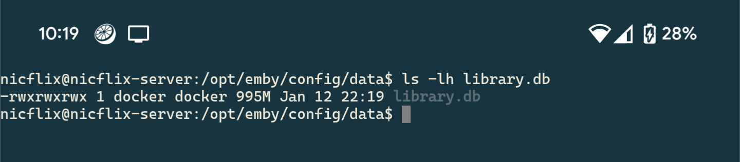

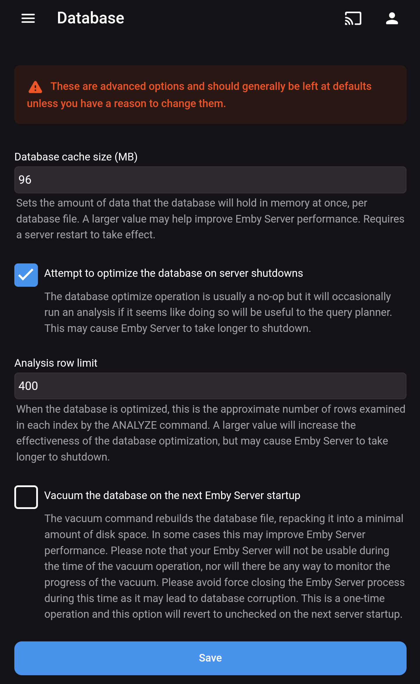

Happy2Play 9800 Posted January 13, 2023 Posted January 13, 2023 @ShadowKindjal What us your library.db size and your Database cache size (App settings-Database)?
ShadowKindjal 21 Posted January 13, 2023 Author Posted January 13, 2023 2 minutes ago, Happy2Play said: @ShadowKindjal What us your library.db size and your Database cache size (App settings-Database)? library.db is 995 megabytes and my database cache size is 96 megabytes
Solution Happy2Play 9800 Posted January 13, 2023 Solution Posted January 13, 2023 (edited) @ShadowKindjal Best practice if you have the RAM is to set the DB cache size to 1.5 to 2 times the database size. Edited January 13, 2023 by Happy2Play 1
ShadowKindjal 21 Posted January 13, 2023 Author Posted January 13, 2023 5 minutes ago, Happy2Play said: @ShadowKindjal What us your library.db size and your Database cache size (App settings-Database)? I'm noticing in other forum posts you've mentioned that the cache size should be 1.5 to 2 times the size of the database. Does that mean i need to increase mine to two gigs?
ShadowKindjal 21 Posted January 13, 2023 Author Posted January 13, 2023 Just now, Happy2Play said: @ShadowKindjal Best practice if you have the RAM is to set the DB cache size to 1.5 to 2 times the database size. I have plenty of available RAM. I'll up it to 4GB if that won't cause any issues.
Happy2Play 9800 Posted January 13, 2023 Posted January 13, 2023 1 minute ago, ShadowKindjal said: I'm noticing in other forum posts you've mentioned that the cache size should be 1.5 to 2 times the size of the database. Does that mean i need to increase mine to two gigs? If you have the RAM yes that should help with performance and also when was the last time you vacuumed the database? 1 minute ago, ShadowKindjal said: I have plenty of available RAM. I'll up it to 4GB if that won't cause any issues. 2 in theory should be plenty but don't know of any drawbacks of setting it to high.
ShadowKindjal 21 Posted January 13, 2023 Author Posted January 13, 2023 7 minutes ago, Happy2Play said: If you have the RAM yes that should help with performance and also when was the last time you vacuumed the database? It's been at least a year.... Possibly longer..... It's a pretty big server with 140TB of data. 5000 movies and 1000 tv series. I'll vacuum my server in the morning. 1

ShadowKindjal 21 Posted January 13, 2023 Author Posted January 13, 2023 11 hours ago, Happy2Play said: If you have the RAM yes that should help with performance and also when was the last time you vacuumed the database? Vacuuming the server dropped the size from 995 megabytes to 866.
