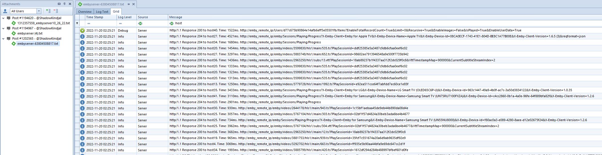

ShadowKindjal 21 Posted November 20, 2022 Author Posted November 20, 2022 Here is said log file. Users noticed streams were buffering. I attempted to browse the site but pages took a long time to load so i restarted the server. embyserver-63804508817.txt

rbjtech 5345 Posted January 10, 2023 Posted January 10, 2023 Just looking at the latest log - I see some very large network latency in responding to the clients - are the clients very remote ? As an example - here I see average latency ranging from 930ms to 4500ms Are you sure this is not a network issue ? As a comparison - my remote connection latency is ~15-20ms ..
