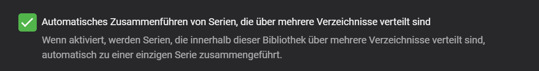

I have a TV library with two folders. Option "Automatically merge series that are spread across multiple folders" is ticked.
I have a series that's spanned across two folders in the same library. That series appears only once when querying /Items.
My issue is that internally, Emby has two series ID for that series, as can be seen on the episodes: their SeriesId differ. When querying for the series list, one of those IDs is hidden and we only see the other one in Emby response.
My request to you would be to provide a new option to not merge series so that every individual series shows up in the response.
