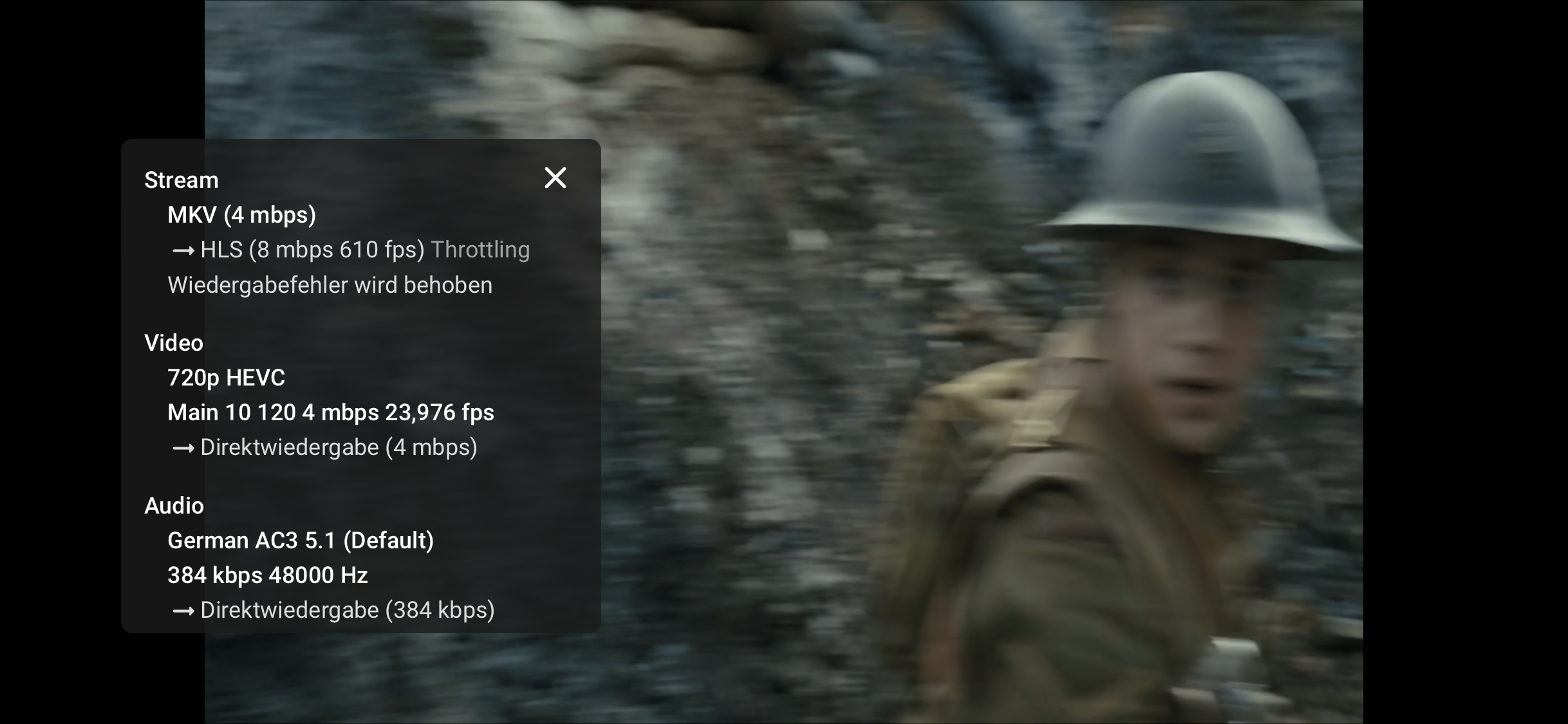

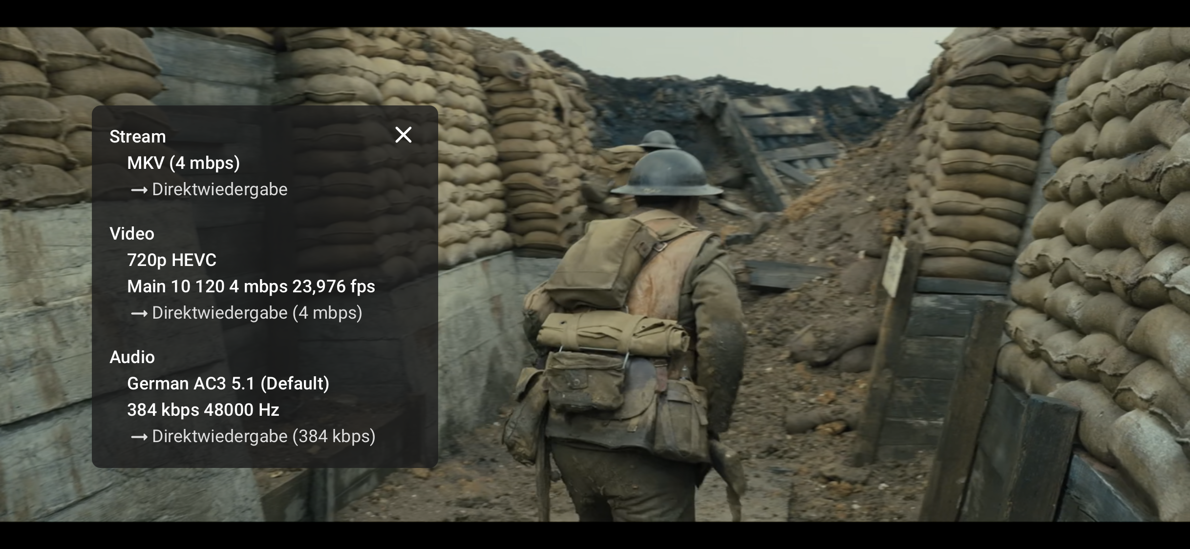

MrWGT13 24 Posted October 26, 2022 Author Posted October 26, 2022 Started playback and there is "the error" with 720p 10mbps selected. During playback I switched to 720p 8mbps and error is gone. Gerd
MrWGT13 24 Posted October 26, 2022 Author Posted October 26, 2022 I tested a little further. Other anamorphic movies in e.g encoded 1280x816 are shown with correct aspect (1920x816) These movies stream directly MKV, video and audio Movie 1917 shows "playback error are fixed" (translated from german) and is played with wrong aspect ratio. Toggling video playback quality during playback fixes error and MKV, video and audio are directly streamed CPU is high on any movie for a few seconds. Tops shows ffmpeg with high cpu but after 10s cpu in very low. So it looks for me that it's not a video/audio transcoding issue it's a "mkv should be streamed" issue with some movies but toggling video quality in ios app fixes current playback => tried to clean mkv with mkvtoolnix keeping just video and audio but did not solve issue Anyway i would be great to find a solution without toggling quality. Is a sample required? Thanks Gerd
