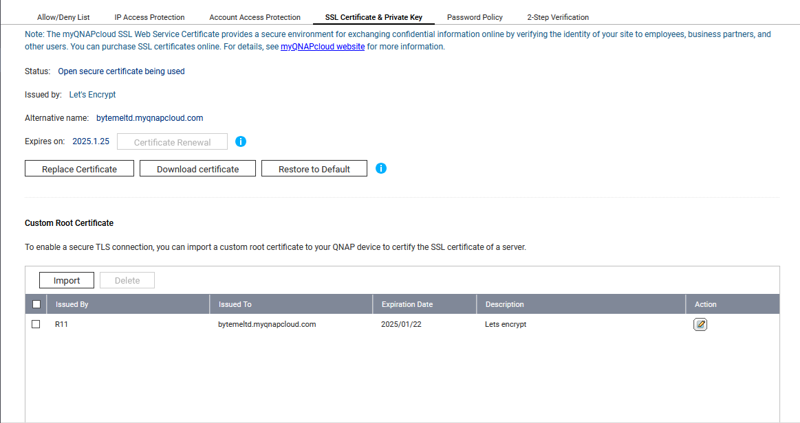

renefw 2 Posted 3 hours ago Posted 3 hours ago Until recently, I had QTS running on my QNAP NAS systems. This guide worked perfectly then. I've since updated all my QTS systems to hero h6.0.0.****. Unfortunately, I haven't been able to get the script to run since then. I learned from QNAP support that under QuTS Hero it's no longer possible to let the certificate be converted automatically, as was previously possible with QTS, because the Let's Encrypt certificate is no longer stored under a fixed path. My hope was that I could manually download the automatically updated certificate using the QNAP Control Panel under Security, SSL Certificate & Private Key, and that at least the conversion to a p12 certificate would then happen automatically. Unfortunately, I can't get it to work either. I'm not getting any error message. The log file also always shows that the certificate key hasn't changed, even though I've updated the CRT and key files. I saved all scripts, certificates, and the log file in a folder I created myself, named SSL-Certificate. Since QNAP renamed the cert file to SSLcertificate.crt and the corresponding key file to SSLprivatekey.key, I modified the CertRenew.sh script as follows. Quote now="$(date)" cd /share/SSL-Certificate [[ -z `find SSLcertificate.crt -mmin -60` ]] if [ $? -eq 0 ] then echo "Zertifikatschlüssel hat sich nicht geändert - $now" >> /share/SSL-Certificate/check-p12.log else cd /share/SSL-Certificate openssl pkcs12 -export -out emby.p12 -inkey SSLprivatekey.key -in SSLcertificate.crt -passout pass:mykey echo "Neues Zertifikat.p12 bei $now erstellt" >> /share/SSL-Certificate/check-p12.log fi My SSL certificate folder looks like this. What's wrong with the script? It's not recognizing that the SSLcertificate.crt file has been renewed, and therefore the certificate and key have changed, so that the emby.p12 certificate should also be updated as it should be. The CertRenew.sh script is running correctly as a cron job every hour, and I can see in the check-p12.log that the key supposedly hasn't changed. Could someone please give me a tip on how to automatically update my emby.p12 certificate using the script? This should happen as soon as I download an updated SSL certificate via the Control Panel and save the contents of the extracted ZIP file to my SSL-Certificate folder, overwriting the SSLcertificate.crt and SSLprivatekey.key files, including the SSLIntermediateCertificate.crt file, with the updated data. I don't think the latter file is needed for this update. Looking at the first two files, I see that the validity period of the certificate (crt) has been updated to the end of June this year, and the contents of the key file are also different.
