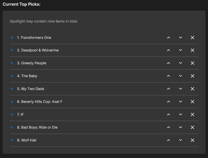

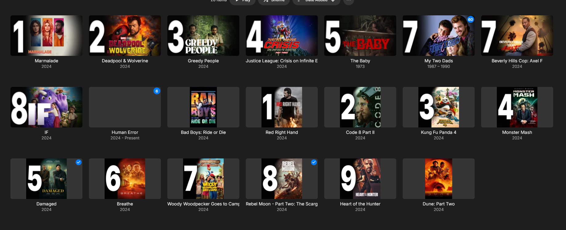

kjhedges 67 Posted October 22, 2024 Posted October 22, 2024 I use TopPicks as a Movie Top 10 kind of thing. I normally select the movie for the TopPicks to display and everything good. Today, I tried to change the Top Picks Items, but something seems to be going wrong. Above is my selection of movies to add to Top Picks. I then Update Top Picks and also Run the scheduled Task Update Top Picks. This is the result for Top Picks. It has put 2 TV Series in the list which I didnt add and also has previous Top Picks items. Any ideas welcomed
chef 3811 Posted October 26, 2024 Author Posted October 26, 2024 (edited) On 10/22/2024 at 9:49 AM, kjhedges said: I use TopPicks as a Movie Top 10 kind of thing. I normally select the movie for the TopPicks to display and everything good. Today, I tried to change the Top Picks Items, but something seems to be going wrong. Above is my selection of movies to add to Top Picks. I then Update Top Picks and also Run the scheduled Task Update Top Picks. This is the result for Top Picks. It has put 2 TV Series in the list which I didnt add and also has previous Top Picks items. Any ideas welcomed Okay. Thank you for reporting this. Please try to remove the entire list of items and run refresh on the empty list. Then add your items back and run refresh again. Please let me know how you do. Edited October 26, 2024 by chef
kjhedges 67 Posted October 26, 2024 Posted October 26, 2024 @chef I tried as you said, but it still had the items there even though none were in top picks list. I then went /emby/data/top-picks and manually deleted the items in there and done a refresh on the Top-Picks library, then Top-Picks was empty. So I then added some new items to Top-Picks in settings and refreshed again and I now have the correct items in the Top-Picks list. Somewhere, the permissions seemed to have changed, and the items couldn't be removed by Top-Picks I then changed a couple of items in Top-Picks and refreshed and everything seems to be working correctly. 1

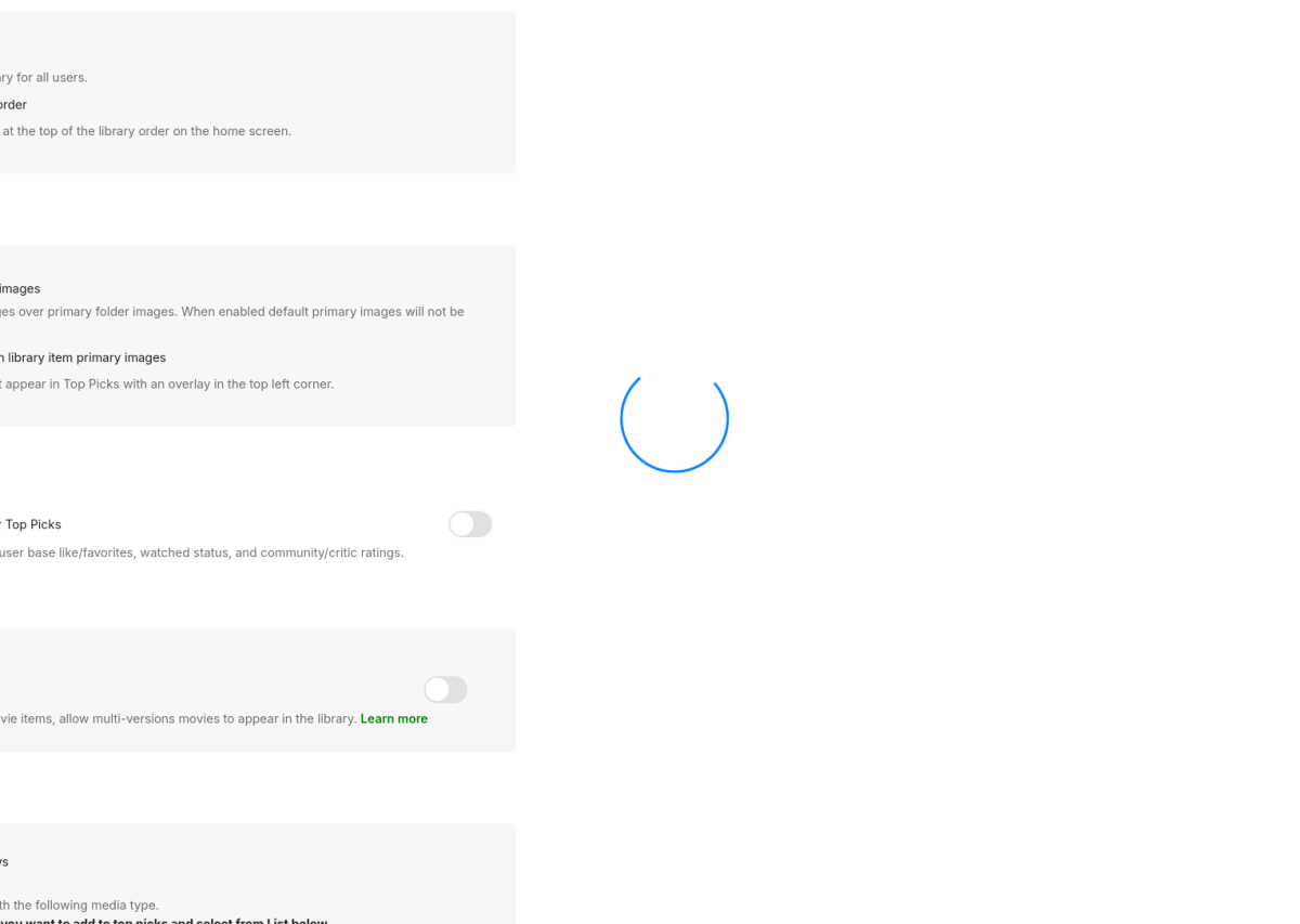

Suliamu 41 Posted October 28, 2024 Posted October 28, 2024 (edited) On 10/19/2024 at 8:40 AM, Suliamu said: Yip it also stopped working for me. When i try to update the top picks i get forever spinning and nothing gets updated. Restarting server doesn't help. Keeps spinning. But worse of it is that now all libraries are not longer visible in the backend. Shows "0 libraries". Restarting server also doesn't help with this. I will have to uninstall the plugin for now sadly. Hopefully there will be a fix soon. I've by now tried basically everything, besides reinstalling emby. Removing the plugin, removing the library, reinstalling, restarting, removing files in /emby/data/top-picks, i have tried every combination, but i always get same symptoms: After restart i can go to my libraries in setting. They show. When i open the settings-tab for the plugin, i only see a forever turning blue circle. The bottom button to update the top-picks-library does nothing. After i visited this settings-tab of the plugin, my libraries don't show up anymore in the library-view in settings. The most striking thing is that this worked until at least the last update without problems. Can you advise maybe any fix on file-system base since nobody else seems to have those problems it seems? Could it be that there is a bug with a certain amount of libraries? I have 14. Added couple some time ago. I am not exactly sure if the update broke it or adding those new libraries. Thanks in advance Edited October 28, 2024 by Suliamu
Bottles51 75 Posted October 30, 2024 Posted October 30, 2024 @SuliamuYou are not the only one with this problem. For me if I add a movie manually to the list it will stop the loading spin. Then to update Top Picks I go to Embys Scheduled Tasks and update Top Picks from there. That my work around for now. I create my list manually and have not tested anything else. Hope this helps. 1

chef 3811 Posted October 31, 2024 Author Posted October 31, 2024 Okay, I have found an issue. I just have to figure out what changed the task library. That will stop the constant load of the config page. 1

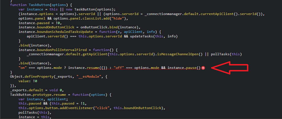

chef 3811 Posted October 31, 2024 Author Posted October 31, 2024 (edited) @Luke, Hello sir. I think I am have found something in taskbutton.js. My initial findings: there is a condition referring to the instance of the TaskButton's "resume" method, which seems to have been removed or changed. I haven't looked at TaskButton in a long, long time, but it is causing a loading issue with my configuration page. Thanks again, edit: sorry it doesn't matter, I can handle this error... not a biggie! Edited October 31, 2024 by chef
chef 3811 Posted October 31, 2024 Author Posted October 31, 2024 (edited) Okay I've fixed the loading issue. Before I update the catalog, I'd best try to fix some of the other stuff. If you want to test it, please try this : Emby.TopPicks 1.0.0.61b.zip (Please remember to clear the browser cache to load the new js properly.) - config page to load properly td: - error checking list creation on the config page. (kjhedges) - what to do when missing thumbnail (Quincarter) default: image - check emby's form elements, and style components (name may have changed): Textbox, Select Edited October 31, 2024 by chef 2

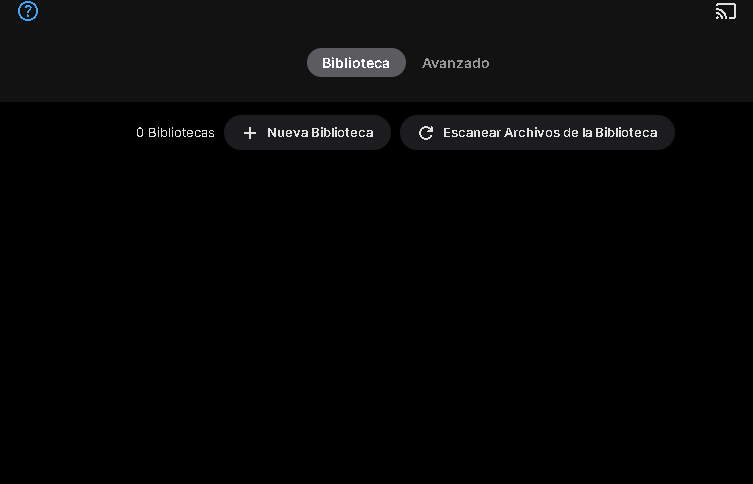

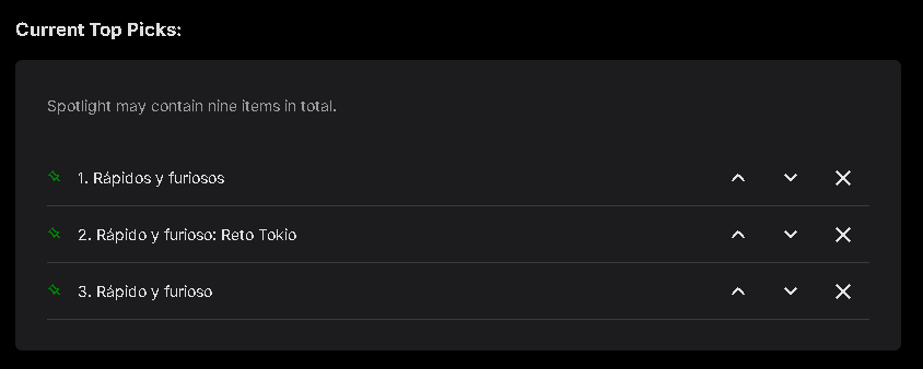

Angel273 9 Posted October 31, 2024 Posted October 31, 2024 Aun sigue tieniedo errores no los muestra en el inicio si agrega aparentemente las peliculas pero desaparece labliblioteca 1

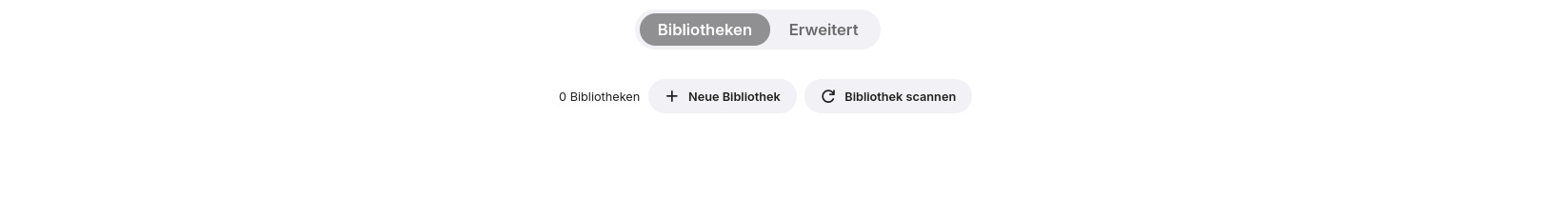

Suliamu 41 Posted November 1, 2024 Posted November 1, 2024 Hey there, thanks again for your support. I installed the latest plugin-version 1.0.0.62 and unfortunately there is still no functionality for me. I can put items into the list. This works and there is no constant loading anymore. But the button to "Update Top Picks" is unfortunately non functional. Also the library overview in the server-settings again is fully empty unfortunately. When i go to my normal library-view of Movies, all the selected Top-Picks have the little label in the corner, so that at least works. But the library, the plugin created, that shows on the start page, is also empty.
chef 3811 Posted November 1, 2024 Author Posted November 1, 2024 43 minutes ago, Suliamu said: Hey there, thanks again for your support. I installed the latest plugin-version 1.0.0.62 and unfortunately there is still no functionality for me. I can put items into the list. This works and there is no constant loading anymore. But the button to "Update Top Picks" is unfortunately non functional. Also the library overview in the server-settings again is fully empty unfortunately. When i go to my normal library-view of Movies, all the selected Top-Picks have the little label in the corner, so that at least works. But the library, the plugin created, that shows on the start page, is also empty. I see that as well. This is because the task button library may have changed in the core. I'm currently looking into it further. 1
chef 3811 Posted November 2, 2024 Author Posted November 2, 2024 (edited) I found the button issue. I know what happened. The core developers on the Web interface fixed the taskButton library file location issue... finally. LOL. We use to have to add the path for "components" to the taskButton library when defining it.It seems we no longer have to do that... I think. That's nice. EDIT: although that change has happened, it is not the cause for the task button to error. Edited November 2, 2024 by chef 1
chef 3811 Posted November 2, 2024 Author Posted November 2, 2024 I am having a heck of a time with taskButton library. I think I have to temporarily disable the button on the plugin in page, and you'll have to run it from the scheduled task page. At least until I can figure out how taskButton is working now. I can see that auto organize utilizes that library. I'll see what it does now, and hopefully understand it enough to implement it in Top Picks. 1 2
