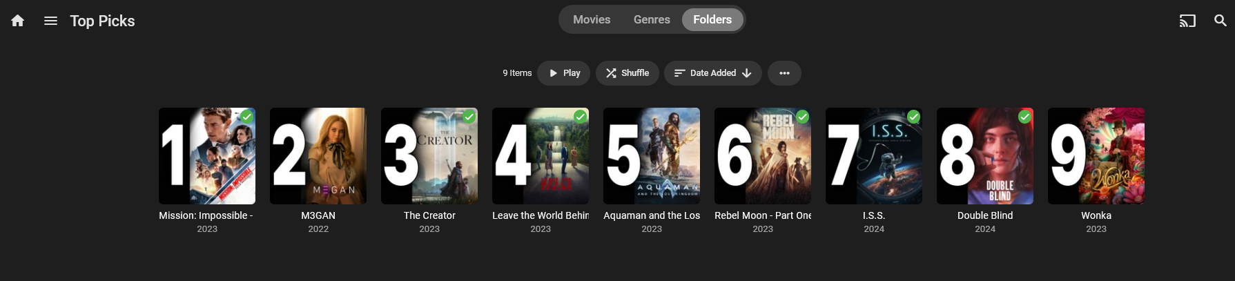

kjhedges 67 Posted February 20, 2024 Posted February 20, 2024 Well, that didnt take as long as I thought it would, and we have good news here. Populated and displaying perfectly. I appreciate your work put into this. A great plugin.

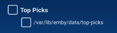

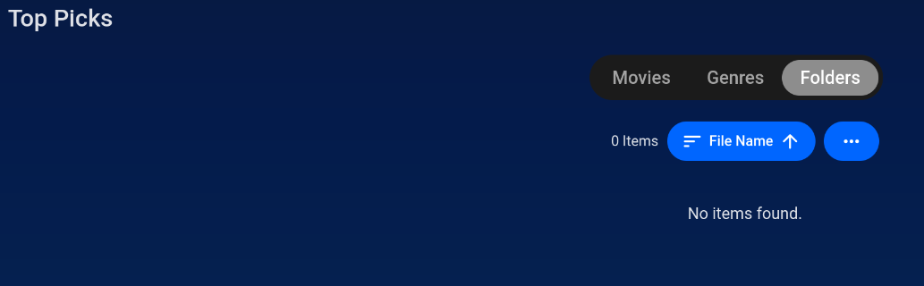

ZanderKeen 73 Posted February 20, 2024 Posted February 20, 2024 Hello, Has anyone else had an issue where your top picks library user access is not working using the updated plugin version? I uninstalled the top picks plugin and removed the dir under /var/lib/emby/data/top-picks (since it didn't remove itself after uninstalling the plugin) scanned library restarted emby installed top picks plugin restarted emby verified proper permissions are set on top-picks dir scanned library set movies for top picks updated top picks and ran the library scan again movie cover art displays the "top pick" image and the dir /var/lib/emby/data/top-picks contains the directories for the movies However now when I set Top Picks "Enable All Users" it shows the library for users but the library says "No items found". I noticed on the Users > Access page, the Top Picks library is checked however the path is not checked. When I put a check mark there & save, it doesn't save that was checked and in fact removes the check mark for the Top Picks library all together & removes it from all of my users as simultaneously at the same time. I tried again with "Enable All Users" disabled, then going to Users > Access and checking both, and again, it does not remember my checked settings no matter what I try to do. I watched the log file with tail -f /var/lib/emby/logs/embyserver.txt while doing this process and it appeared to be working properly creating the filepaths and such without spitting any errors in the process. I rebooted the entire server, did another library scan while watching the logs & still have the same results. Is there something simple I might be missing here? Thanks

chef 3811 Posted February 20, 2024 Author Posted February 20, 2024 (edited) 16 minutes ago, Zander3768 said: Hello, Has anyone else had an issue where your top picks library user access is not working using the updated plugin version? I uninstalled the top picks plugin and removed the dir under /var/lib/emby/data/top-picks (since it didn't remove itself after uninstalling the plugin) scanned library restarted emby installed top picks plugin restarted emby verified proper permissions are set on top-picks dir scanned library set movies for top picks updated top picks and ran the library scan again movie cover art displays the "top pick" image and the dir /var/lib/emby/data/top-picks contains the directories for the movies However now when I set Top Picks "Enable All Users" it shows the library for users but the library says "No items found". I noticed on the Users > Access page, the Top Picks library is checked however the path is not checked. When I put a check mark there & save, it doesn't save that was checked and in fact removes the check mark for the Top Picks library all together & removes it from all of my users as simultaneously at the same time. I tried again with "Enable All Users" disabled, then going to Users > Access and checking both, and again, it does not remember my checked settings no matter what I try to do. I watched the log file with tail -f /var/lib/emby/logs/embyserver.txt while doing this process and it appeared to be working properly creating the filepaths and such without spitting any errors in the process. I rebooted the entire server, did another library scan while watching the logs & still have the same results. Is there something simple I might be missing here? Thanks Interesting. After selecting the option to set top picks for all users, if you run the scheduled task again, does the library populated correctly? Thank you for your time and patience. Edited February 20, 2024 by chef
ZanderKeen 73 Posted February 20, 2024 Posted February 20, 2024 Quote After selecting the option to set top picks for all users, if you run the scheduled task again, does the library populated correctly? yes. It does actually. I just experimented myself with creating my own library manually and using the top-picks filepath. I am able to see all of the top picks movies in there but not the library created by the plugin (if that makes sense). 1
ZanderKeen 73 Posted February 20, 2024 Posted February 20, 2024 @chefI got it working. So i did something similar to what I just did a minute ago. I just deleted the library Top Picks, Recreated a library titled Top Picks, ran the "update top picks" and a library scan and its working. I'm thinking maybe the library was just left over still from the previous install of the plugin & for some reason didn't get fully in-sync somewhere with the updates. But it is working now. 1

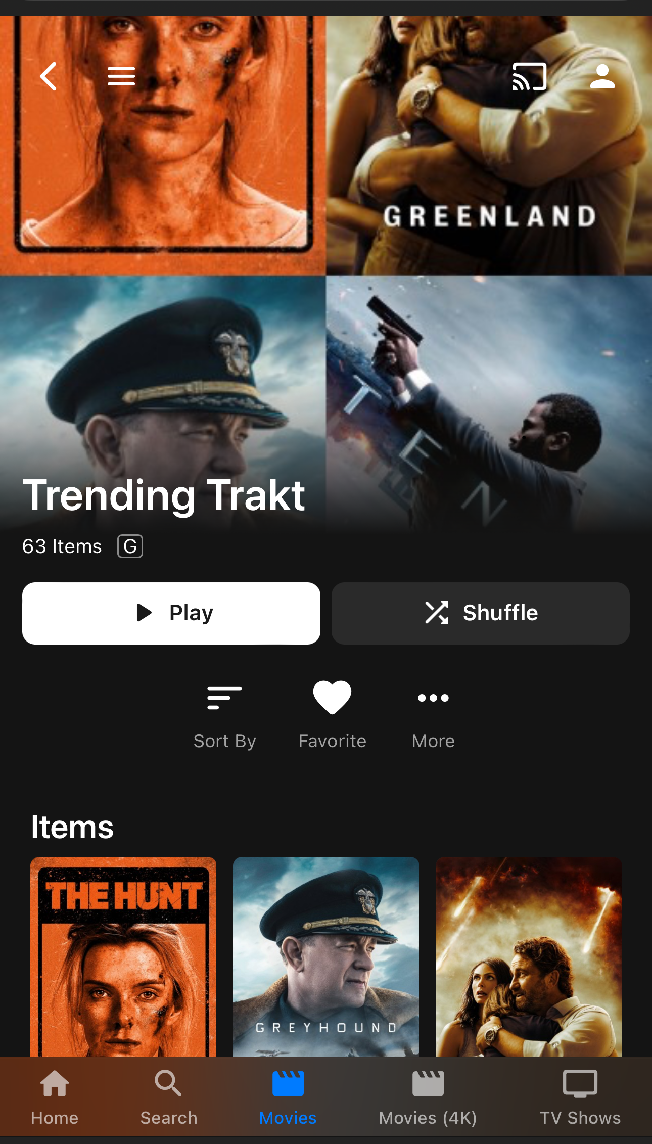

bakes82 167 Posted February 22, 2024 Posted February 22, 2024 8 hours ago, chef said: That's strange, for some reason my episode query looked back at the series instead of the season... why would I do that? I think I fixed the issue... I'm testing it out. Why don’t you just build what everyone wants. You put in a trakt list url and it uses that as the source? It would solve a lot of the complicated logic you have and I’d assume most people just want the most downloaded watched weekly lists. It’s really easy to do with the trakt api and you have the logic to make the channels you just match by the IMDb/tvdbid. I did something similar for collections using the mdb api. Since luke said making channels was bad for the database as it duplicates the entries and such. 2
rbjtech 5345 Posted February 23, 2024 Posted February 23, 2024 10 hours ago, bakes82 said: Why don’t you just build what everyone wants. You put in a trakt list url and it uses that as the source? It would solve a lot of the complicated logic you have and I’d assume most people just want the most downloaded watched weekly lists. It’s really easy to do with the trakt api and you have the logic to make the channels you just match by the IMDb/tvdbid. Why would I want to use Trakt ? - this is no better than plex as it's capturing all your watch data... no thanks. 10 hours ago, bakes82 said: Since luke said making channels was bad for the database as it duplicates the entries and such. Agree here - I believe 'smart play/watch lists' are on the Horizon (hopefully with an API to make our own) - but this fundamental 'media hub' functionality has been missing for so long, that workarounds are the only solution .. if Luke doesn't like us doing it - then maybe provide an acceptable way to do it .. 3
