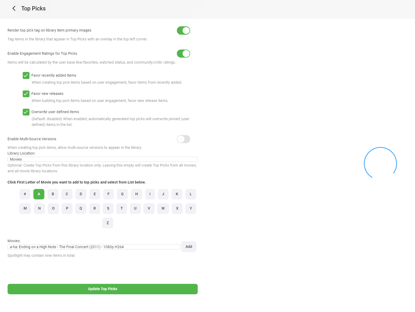

Thuzad 50 Posted February 12, 2024 Posted February 12, 2024 Thanks for this update, the interface is now accessible, but when I run the scan (Update Top Picks) it doesn't work. - If I don't have any media in the list, the button seems to reload the page - If I add media and run the scan, it doesn't find anything  Do you need a log or something else? I started from a blank installation, uninstalling the plugin and deleting the folder.

regorresiak 1 Posted February 12, 2024 Posted February 12, 2024 7 hours ago, chef said: I've pushed .57 to the catalog which will load top picks again. I have tested and it will work. It looks like it still needs some tending too though. Things have changed in the emby UI, so I'll have to get these fixed.  I uninstalled the original version, because it did not work after replacing the DLL you had posted and installed this latest version .57. Unfortunately, the plug in still does not work. When i open the setting for the plug in, it appears it is constantly trying to load something as there is a "loading circle" that never goes away while on the setting page.
Kyrunner 86 Posted February 12, 2024 Posted February 12, 2024 4 minutes ago, regorresiak said: I uninstalled the original version, because it did not work after replacing the DLL you had posted and installed this latest version .57. Unfortunately, the plug in still does not work. When i open the setting for the plug in, it appears it is constantly trying to load something as there is a "loading circle" that never goes away while on the setting page. I had the same issue I uninstalled the plugin until it got sorted out.Â
Suliamu 41 Posted February 12, 2024 Posted February 12, 2024 The new update works. Kind of. Unfortunately the Top Picks are being sorted by Letter, and not by the number you give them. That means when you have for example this list of Top Picks: 1. Zarathustra 2. Ballmovie  3. After Hour  4. Examplemovie 2  He will show it as such in this sort order: 3. After Hour | 2. Ballmovie | 4. Examplemovie 2 | 1. Zarathustra Â

chris2312 1 Posted February 17, 2024 Posted February 17, 2024 Same issue here, loading indicator wont go away when entering the settings page. Console prints the following error: configurationpage?name=SpotlightConfigurationPageJS&v=4.8.1.0:559 Uncaught (in promise) TypeError: Cannot read properties of undefined (reading 'DisplayTitle') Â Â at configurationpage?name=SpotlightConfigurationPageJS&v=4.8.1.0:559:227 Â Â at Array.forEach (<anonymous>) Â Â at HTMLDivElement.<anonymous> (configurationpage?name=SpotlightConfigurationPageJS&v=4.8.1.0:556:27) Â Appearing here: Â //Filter out any 4K videos from our library query results. Â Â Â Â Â Â Â Â Â Â //The backend will handle creating multi-version top pick library entries if the user has choosen to display them. Â Â Â Â Â Â Â Â Â Â //This will let though other type of multi version types though. Extended verison, Director cuts etc. Â Â Â Â Â Â Â Â Â Â var items = libraryResult.Items; //.filter(r => r.MediaSources.filter(m => m.MediaStreams.filter(s => s.Type == "Video")[0].DisplayTitle.split(' ')[0] != "4K")); Â Â Â Â Â Â Â Â Â Â items.forEach(item => { Â Â Â Â Â Â Â Â Â Â Â Â if (item.ImageTags) { Â Â Â Â Â Â Â Â Â Â Â Â Â Â if (item.ImageTags.Primary) { Â Â Â Â Â Â Â Â Â Â Â Â Â Â Â Â mediaSelect.innerHTML += `<option value="${item.Id}">${item.Name} ${item.ProductionYear ? `(${item.ProductionYear})` : ""} - ${item.MediaSources[0].MediaStreams.filter(s => s.Type == "Video")[0].DisplayTitle}</option>`; Â Â Â Â Â Â Â Â Â Â Â Â Â Â } Â Â Â Â Â Â Â Â Â Â Â Â } Â Â Â Â Â Â Â Â Â Â }); Â Maybe this helps you in some way. Â 1
chef 3811 Posted February 19, 2024 Author Posted February 19, 2024 I have a fix for this. I'll post it.
chef 3811 Posted February 19, 2024 Author Posted February 19, 2024 (edited) Okay, got the bug. I will be updating the catalog today. If you find that the DisplayTitle bug is still there, let me know. It is because that piece of metadata doesn't always exist for a media file. Therefore, it may rear its head again. I believe I've got it figured... but you never really know... I will be posting .59. Edited February 19, 2024 by chef 2
