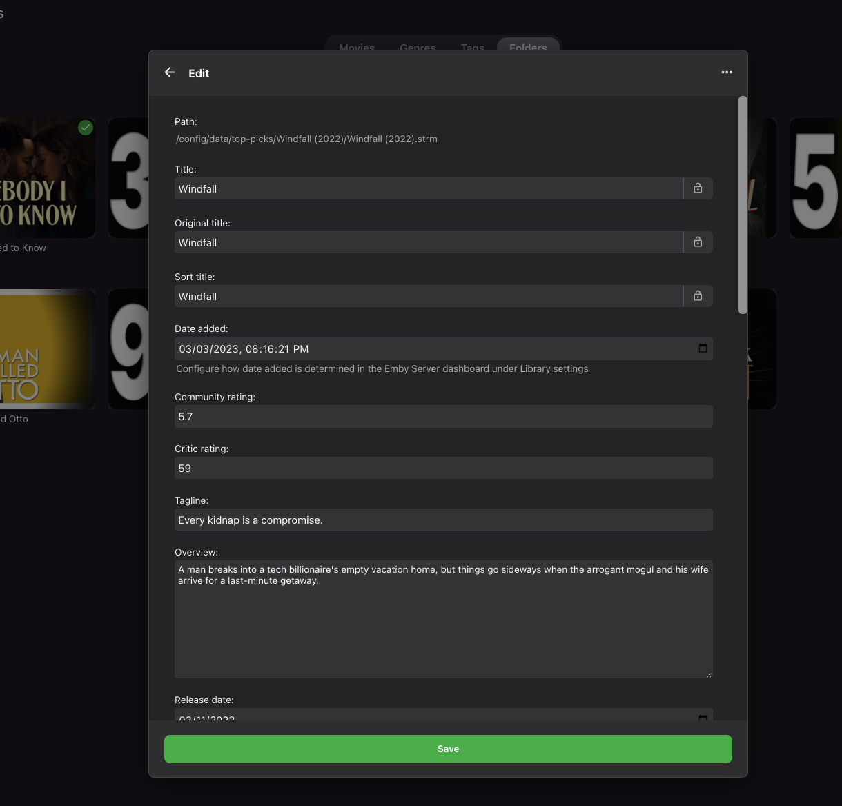

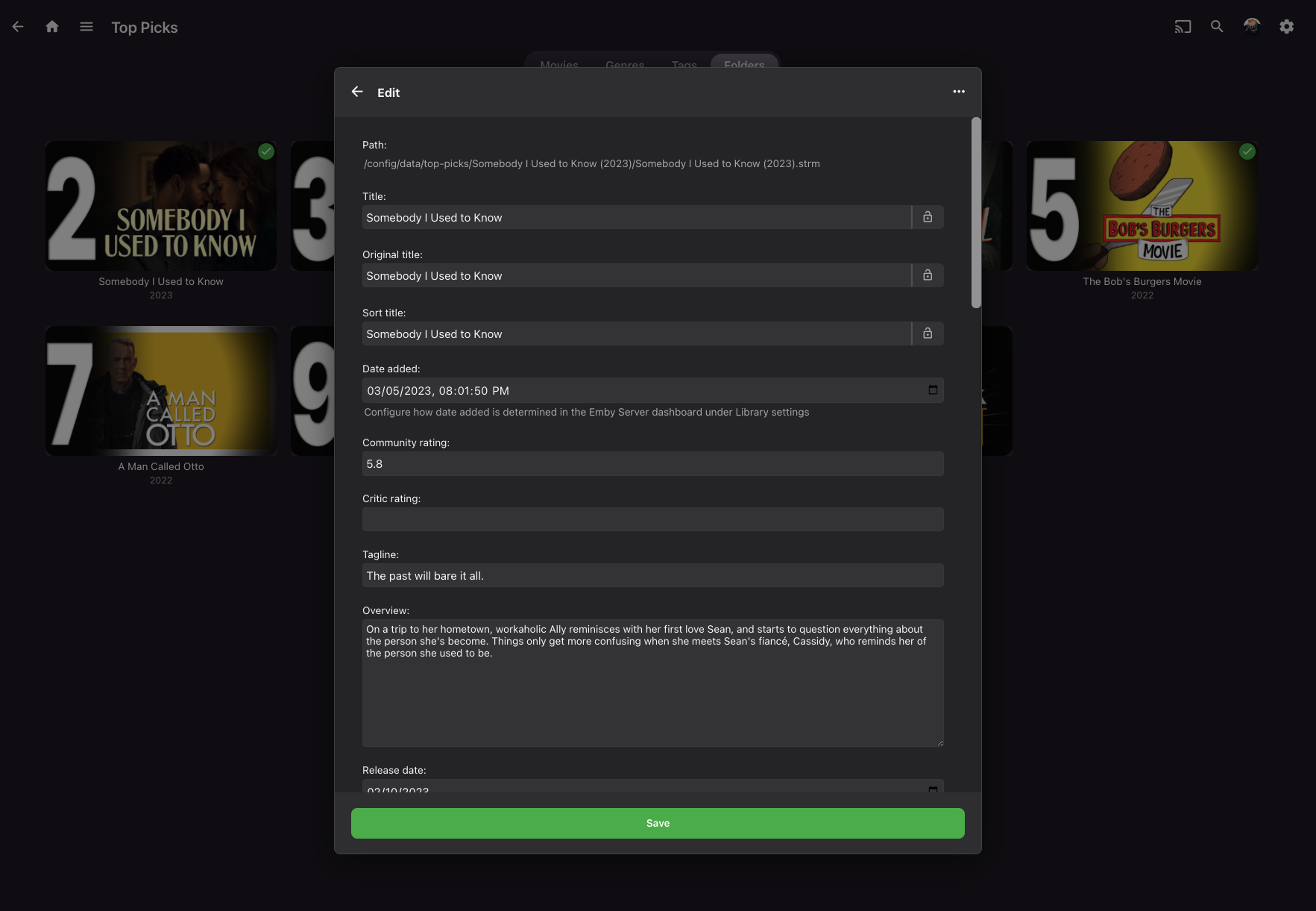

TheGru 156 Posted March 6, 2023 Posted March 6, 2023 Interesting the Edit Metadata Date Added dates and times do not match the NFO files in the top picks data directory.
GrimReaper 4906 Posted March 6, 2023 Posted March 6, 2023 Just now, TheGru said: Interesting the Edit Metadata Date Added dates and times do not match the NFO files in the top picks data directory And therein lies your issue of improper sorting.
