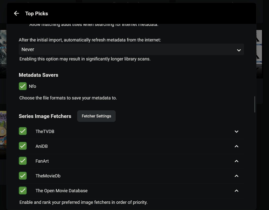

chef 3811 Posted March 5, 2023 Author Posted March 5, 2023 (edited) @Darkseidd .54 creates the missing nfo for episodes if one doesn't exist to copy over. Emby.TopPicks_1.0.0.54.zip This is what I believe is causing that last reference error. I'm pretty sure. But I did have a question, if you look under the library tab and select "Top Picks". Is the option for saving NFO files enabled for the library? Edited March 5, 2023 by chef 1
Darkseidd 59 Posted March 5, 2023 Posted March 5, 2023 (edited) 47 minutes ago, chef said: @Darkseidd .54 creates the missing nfo for episodes if one doesn't exist to copy over. Emby.TopPicks_1.0.0.54.zip 9.77 MB · 0 downloads This is what I believe is causing that last reference error. I'm pretty sure. But I did have a question, if you look under the library tab and select "Top Picks". Is the option for saving NFO files enabled for the library? otw testing it. brb EDIT: Library config for top picks (default) Edited March 5, 2023 by Darkseidd 1

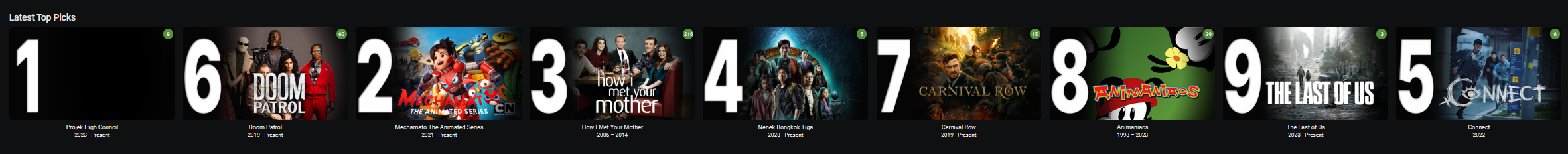

Darkseidd 59 Posted March 5, 2023 Posted March 5, 2023 (edited) library wrong order still happens, only small percentage of time it can sort correctly. i got question 1. in auto schedule task, can we limit top picks number to certain amount? like top 7 or top 5 only. i think my raspi hardware unable to handle 9 without crashes. 2. any option to force the order, ourselves, at library level? 3. anyway to limit resource used for Update Top Picks task? i dont mind longer time, but i do mind server crashes. 4. if new media being added while library scans for top picks happen, can we signal either task to wait for other task, to complete first? Edited March 5, 2023 by Darkseidd 1

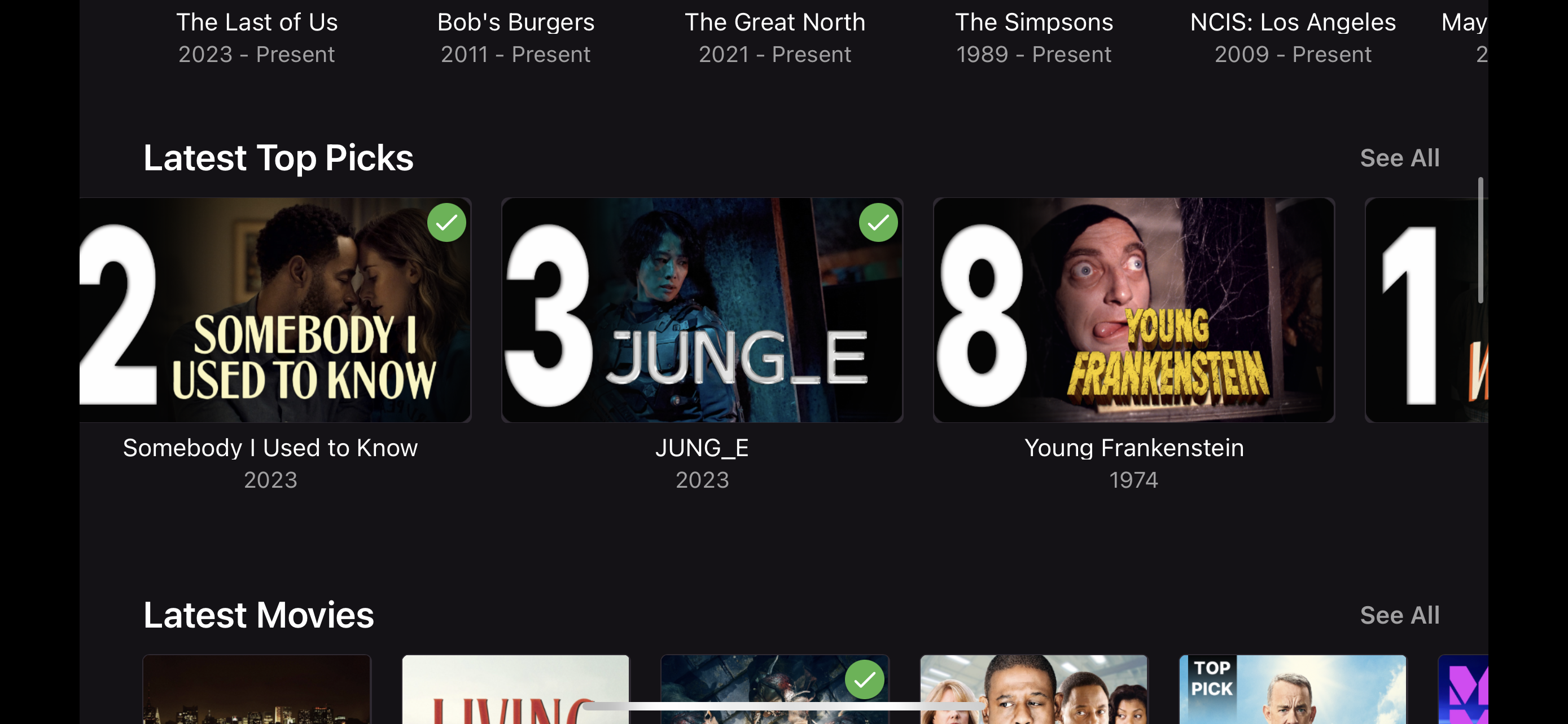

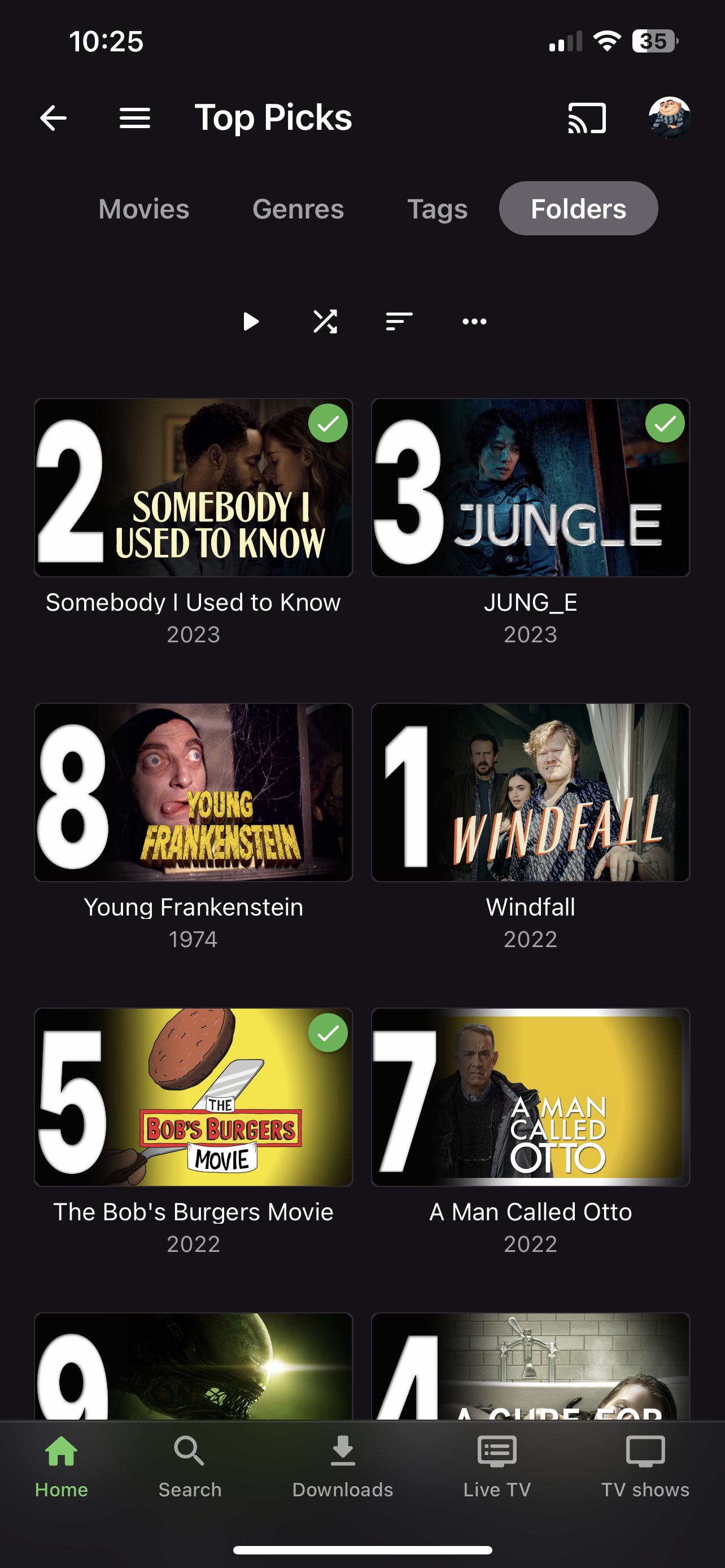

chef 3811 Posted March 6, 2023 Author Posted March 6, 2023 (edited) 5 minutes ago, TheGru said: Updated to .54 and the sort order is still not correct when set to sort by date added even after updating the Top Picks The home screen isn't show the items in order? Or still just the inside the library? Actually, edit that... Perhaps I am seeing something here. Is it that tv shows are in order with themselves, and movies seem to be in order with themselves, but the line up seems to be "movie, series, movie, series, etc". Edited March 6, 2023 by chef
TheGru 156 Posted March 6, 2023 Posted March 6, 2023 43 minutes ago, chef said: The home screen isn't show the items in order? Or still just the inside the library? Actually, edit that... Perhaps I am seeing something here. Is it that tv shows are in order with themselves, and movies seem to be in order with themselves, but the line up seems to be "movie, series, movie, series, etc". I have no tv shows in top picks just 9 movies now and out of order both on the Home Screen and the top picks library. Library sorted by date added 1

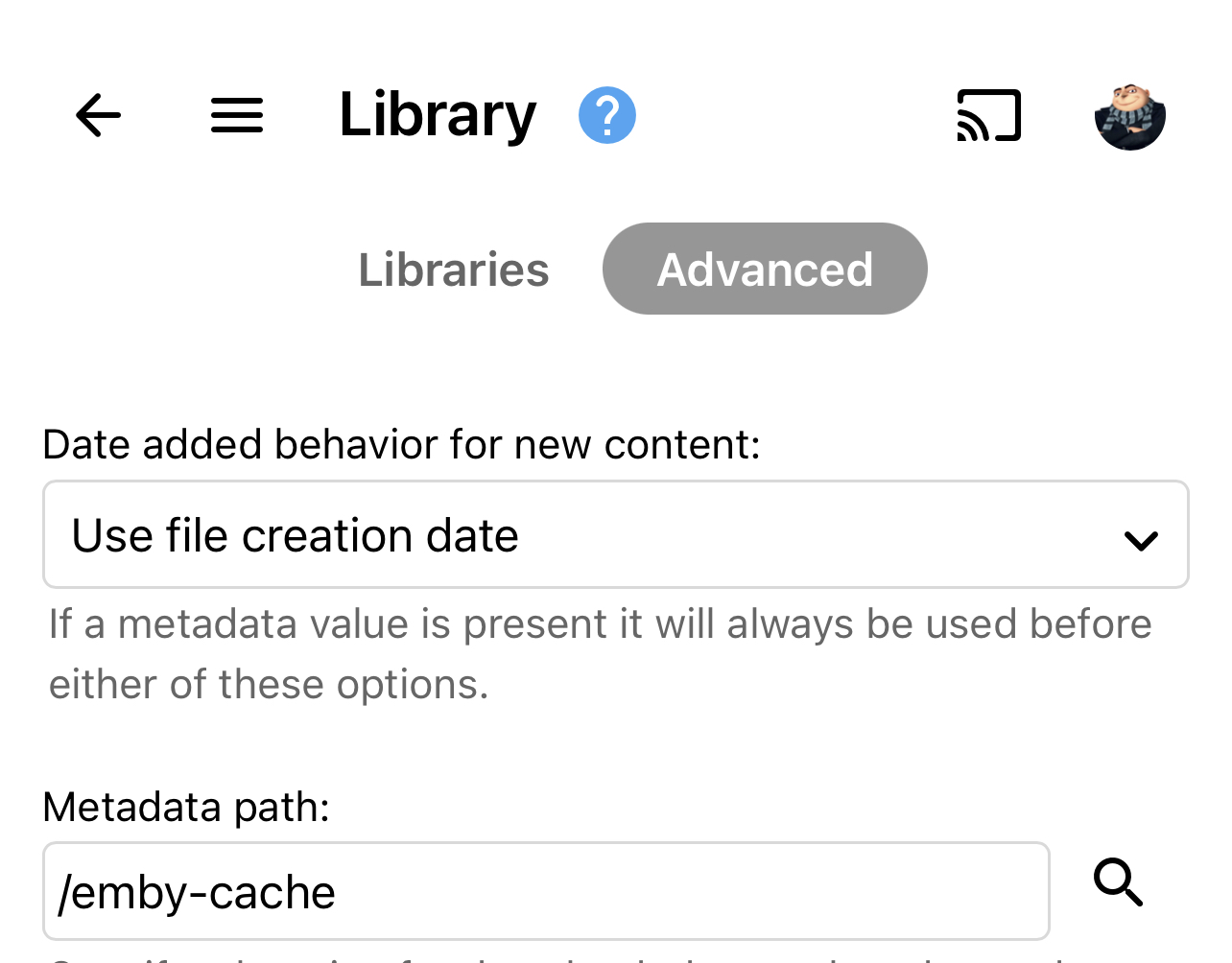

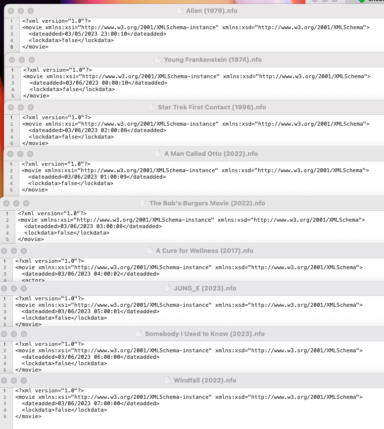

TheGru 156 Posted March 6, 2023 Posted March 6, 2023 Would it be possible to implicitly set a release date in the top pick item’s NFO file to ensure a proper sort instead of using the file creation date? Apparently Emby uses the NFO data if present.
GrimReaper 4906 Posted March 6, 2023 Posted March 6, 2023 9 minutes ago, TheGru said: set a release date You mean Date Added, as Release Date has absolutely no influence here (nor should it be touched)?
TheGru 156 Posted March 6, 2023 Posted March 6, 2023 2 hours ago, GrimReaper said: You mean Date Added, as Release Date has absolutely no influence here (nor should it be touched)? Right, sorry it was early for me this morning when I posted.
GrimReaper 4906 Posted March 6, 2023 Posted March 6, 2023 AFAIK that should already be happening (and it is what enables Top Picks items to be sorted numerically when sorted bt Date Added), as all my Top Picks items do have proper <dateadded> NFO tag upon creation - and all are created off library items' NFO files (without Internet access) with different Date Added/File creation dates.
TheGru 156 Posted March 6, 2023 Posted March 6, 2023 Indeed the dateadded dates and times are there. See screenshot of the TopPIcks created NFO files. In my top picks, #1 Windfall 03/06/2023 07:00:00 #2 Somebody I used to Know 03/06/2023 06:00:00 #3 Jung_E 03/06/2023 05:00:01 #4 A Cure for Wellness 03/06/2023 04:00:02 #5 Bob's Burgers Movie 03/06/2023 03:00:08 #6 Star Trek First Contact 03/06/2023 02:00:08 #7 A man called Otto 03/06/2023 01:00:09 #8 Young Frankenstein 03/06/2023 00:00:10 #9 Alien 03/05/2023 23:00:10 When sorted by Date added Descending my display order is 2,3,8,1,5,7,9,4,6 When sorted by Date added ascending my display order is 6,4,9,7,5,1,8,3,2
