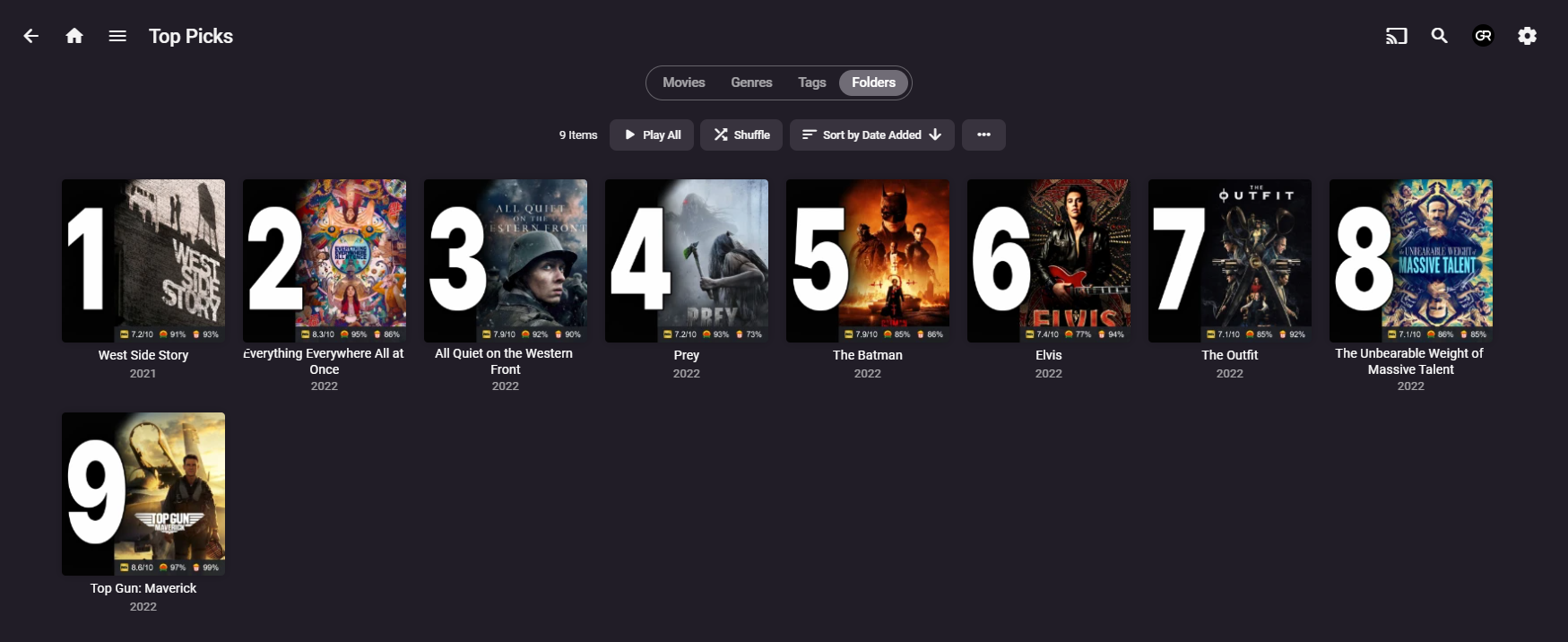

Junglejim 385 Posted December 4, 2022 Posted December 4, 2022 Hi @chef, I just added a tvshow to "Top Picks" and it got added fine at Num 1. The tag naming is wrong though, it has the tags "top-pick" "top-pick-" where the latter should be "top-pick-1" Not a biggie, I haven't utilized the tags at this point.

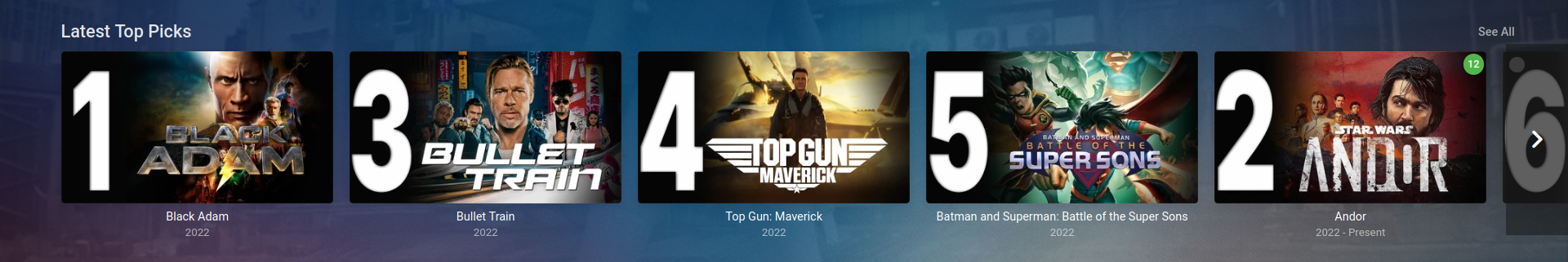

Junglejim 385 Posted December 4, 2022 Posted December 4, 2022 (edited) LOL, I don't think this mixed library stuff is working out mate! I just tried to put Andor to the second spot in "Top Picks". It works out ok for the library view.. Home Wig.. Not so much.. Let's just have this for movie yea? This mixed media is crap the way it is at the mo. Edit: Another update of "Top Picks" pushed it back even further on the home screen??? WTF? Yep movies only for me.. removing tv stuff.. Edit (again ): ... The top picks library in Android TV just has Andor??? Nothing else! LOL Edited December 4, 2022 by Junglejim
Painkiller88 250 Posted December 4, 2022 Posted December 4, 2022 (edited) How exactly is the actual selection of the top-picks working? For me it generates always the same top-picks so i can use the plugin actually only with pinned top-picks. Even if i watch about 20 movies in a week, there are no new movies in the top-picks so not sure if it is using any movies from the history i watched or anything else to create new recommendations for me Another thing i recorgnized, on my Samsung TV, there is no option to sort top-picks so they are not displayed in the correct order. Any plans to add such an option in a future update? Thanks Edited December 4, 2022 by Painkiller8818
