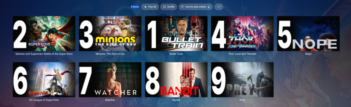

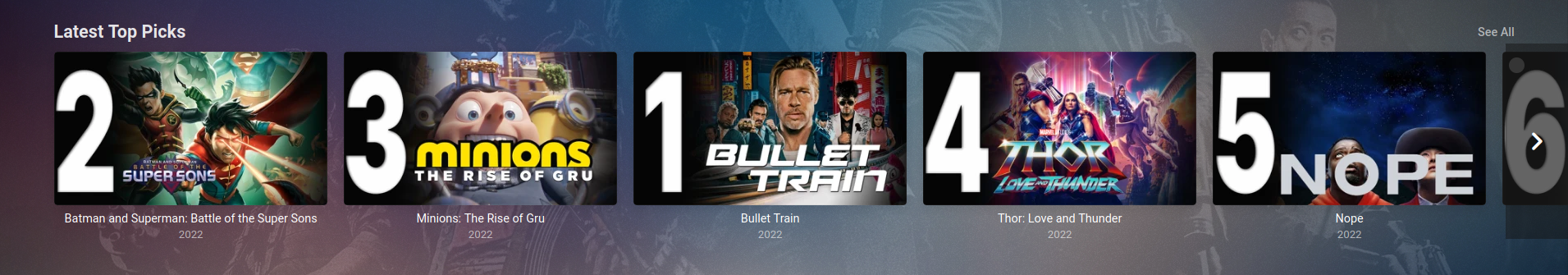

PuffyToesToo
I added a few movies and a TV show to the top picks, but no matter what I do, the TV show will not show up. I've checked to ensure it's not marked as watched, and that watched content isn't removed from the home page. Any suggestion on what else I can check? Thank you.
May I see a log?
Is it just the one series, or all of them?
Edited by chef
  • Thanks 1
PuffyToesToo
Sure, I'll PM it to you.
The top pick intros work! Nice!
(Sorry for the frame rate switching..)
  • Like 2

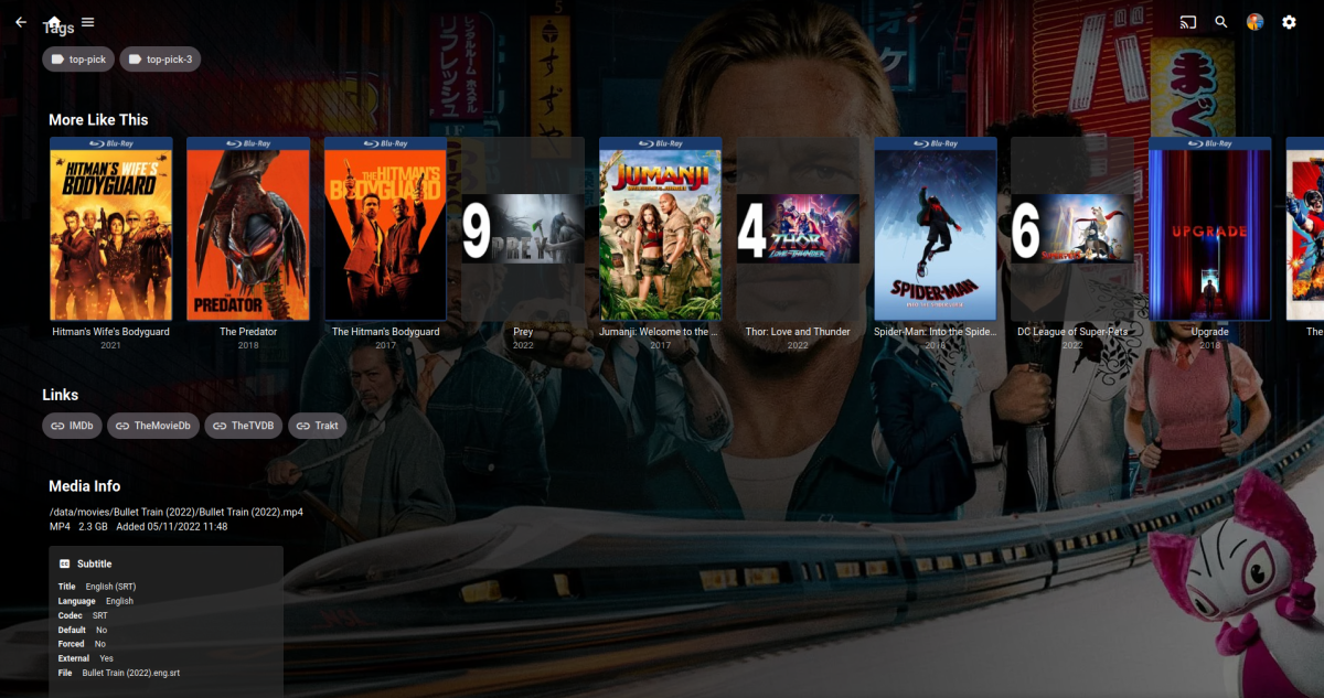

Something strange is happening with the tags and the media strm file on my system. It starts out ok, this is bullet train. As you can see it has the tags "top-pic" "top-pic 3" and no media meta just some subs.
If I play that media for a short while it looses the tags and gains media meta.
Not to sure whats going on there. :)
Edit: A update Top Picks will bring it back to normal (tags are back/no media meta). I create my own list and don't use the "User Engagement" side of things so I don't usually refresh until I change something.
Edited by Junglejim
When I added the stream data (media info) to the NFO file for a top picks, it started acting strangely.
So I left those values out.
After you play the item, media info is probably going to be added to the NFO.
Weird that the tags disappear.
I'll look into this further today.

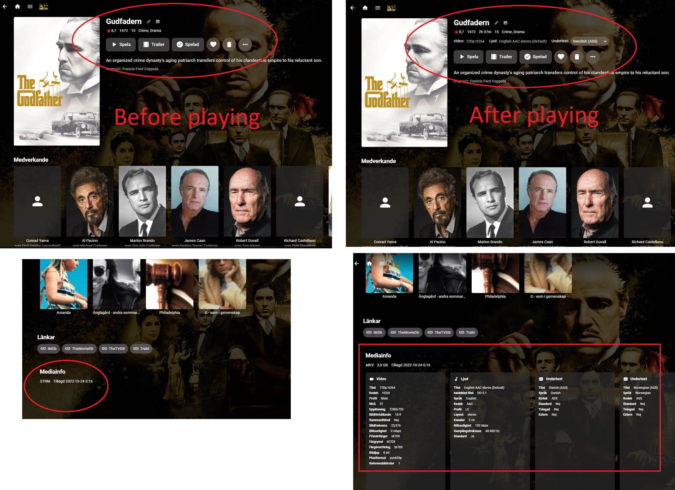

h.soderlund
Hello again!
I can't get the top picks to populate...
Some background:
My library is built up using ".strm" files. I get this from my iptv provider and by running a script it scans a m3u file and create these streaming files into one movie folder and one tvshow folder. Emby then scan these directories and my library is populated with metadata of all the content.
Before watching a movie/show emby only picks up thats it is a stream, and nothing more. After playing the movie for just a second and the cancel, all the media info is available. See below picture.
The issue:
So, the problem is that the Top Picks addon do not  populate a list. I have no idéa if it has to do with the above information, but thats my best guess.
However, i can make a list manually by choosing items from both movies and tv-shows, and i is displayed correctly. All movies and tv-shows is available when creating this list. (See attached image).
Movie library is some 8000 movies, and tv-show is somewhere around 2000, so there is a lot of content for top picks to use.
This is the only output i get from the log when "calculating user engagement", and update top picks takes less than a second to finish with no result.
2022-11-12 12:43:03.872 Info Server: http/1.1 POST http://192.168.1.81:55242/emby/ScheduledTasks/Running/5398ea6da30ecb83be7152e61dd217e6?X-Emby-Client=Emby Web&X-Emby-Device-Name=Chrome Windows&X-Emby-Device-Id=ff1d7027-6f62-487f-9783-be6271f785fc&X-Emby-Client-Version=4.8.0.16. UserAgent: Mozilla/5.0 (Windows NT 10.0; Win64; x64) AppleWebKit/537.36 (KHTML, like Gecko) Chrome/107.0.0.0 Safari/537.36
2022-11-12 12:43:03.876 Info Server: http/1.1 Response 204 to host1. Time: 4ms. http://192.168.1.81:55242/emby/ScheduledTasks/Running/5398ea6da30ecb83be7152e61dd217e6?X-Emby-Client=Emby Web&X-Emby-Device-Name=Chrome Windows&X-Emby-Device-Id=ff1d7027-6f62-487f-9783-be6271f785fc&X-Emby-Client-Version=4.8.0.16
2022-11-12 12:43:04.185 Info Top Picks: Library Items contains 0 Items...
2022-11-12 12:43:04.185 Info Top Picks: User Items contains 4...
Thanks in advance!

hi @h.soderlund
Thanks for posting.  :)
I am aware that the Media Info is not populated in the the library, until after the item is played.
At the moment there isn't much I can do regarding this.
Would it be possible to see an entire log from when you attempted to run the "UserEngagement" task?i
It looks like the engagement task hasn't been able to find any items that match the criteria. This can happen.
perhaps turning off "favor recently added items", and "favor new releases".
I will take a look at the code, and try to populate a list if the engagement task isn't able to find items in the library at first so the list gets populated with something.
Thanks again

h.soderlund
9 hours ago, chef said:
hi @h.soderlund
Thanks again
The media info issue is on all my files/media (not related to Top Picks), since i'm using .strm files for my media. I just thought i might had something to do with my issue. Dont know..
I reinstalled the addon then turned on user engagement and tried to run an update and a calculate user engagement. With the favor recently and latest turned off.
Attached is a clean log, directly after rotating log file i tried to calculate user engagement.
Same with the debug.
embyserver.txt embyserver (debug).txt
  • Thanks 1
