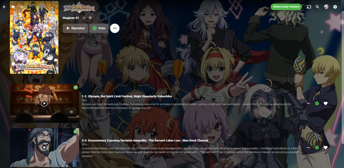

Eremitak 6 Posted October 18, 2022 Posted October 18, 2022 I cannot find a solution to this problem. I have an mkv file named "Fate/Grand Carnival - s01e01-e02 - Owari Subs [BD] - 1st Season.mkv" and emby seems to recognize that it is 2 episodes but instead of creating 2 episodes, it creates one with the titles of both episodes. As you expect (on plex): The "episode number" field is marked 1, Even putting absolute order does not change anything. Forcing the season id of TheTVDB does not change anything. I don't understand how to force viewing to 4 separate episodes (like on plex). ------------------------------------------ They are not the 2 episodes on TheMovieDB because the cover of ep 1 and the title do not match. So I don't understand from where it decides that the season is 2 episodes and not 4. It would be convenient to be able to choose and not take a leap in the dark hoping the priority metadata provider will do as it pleases.
rbjtech 5345 Posted October 18, 2022 Posted October 18, 2022 If you click to play episode 2 in Plex - does it just playback from the start of episode 1 ? (I expect it does - how does it know where episode 2 starts ?) Emby is doing exactly as the filename suggests it should - it has episodes 1 and 2 - so that is what it shows .. If you want to see 4 episodes, then you need 4 files. 1
Solution rbjtech 5345 Posted October 18, 2022 Solution Posted October 18, 2022 edit - if you want to reproduce what plex does (badly, imo if it just plays the start of episode 1 again..) then you need to create a 'virtual' episode (s01e02) that points to s01e01e02 using strm files - maybe that is what Plex is doing ?s ie create a text file called Fate/Grand Carnival - s01e02 - Owari Subs [BD] - 1st Season.strm it just needs to point to the real file ie <file path>\Fate/Grand Carnival - s01e02 - Owari Subs [BD] - 1st Season.mkv emby will then list 'episode 2' for you (and get all it's metadata etc) but actually just play 'Episode 1(and 2)'.
