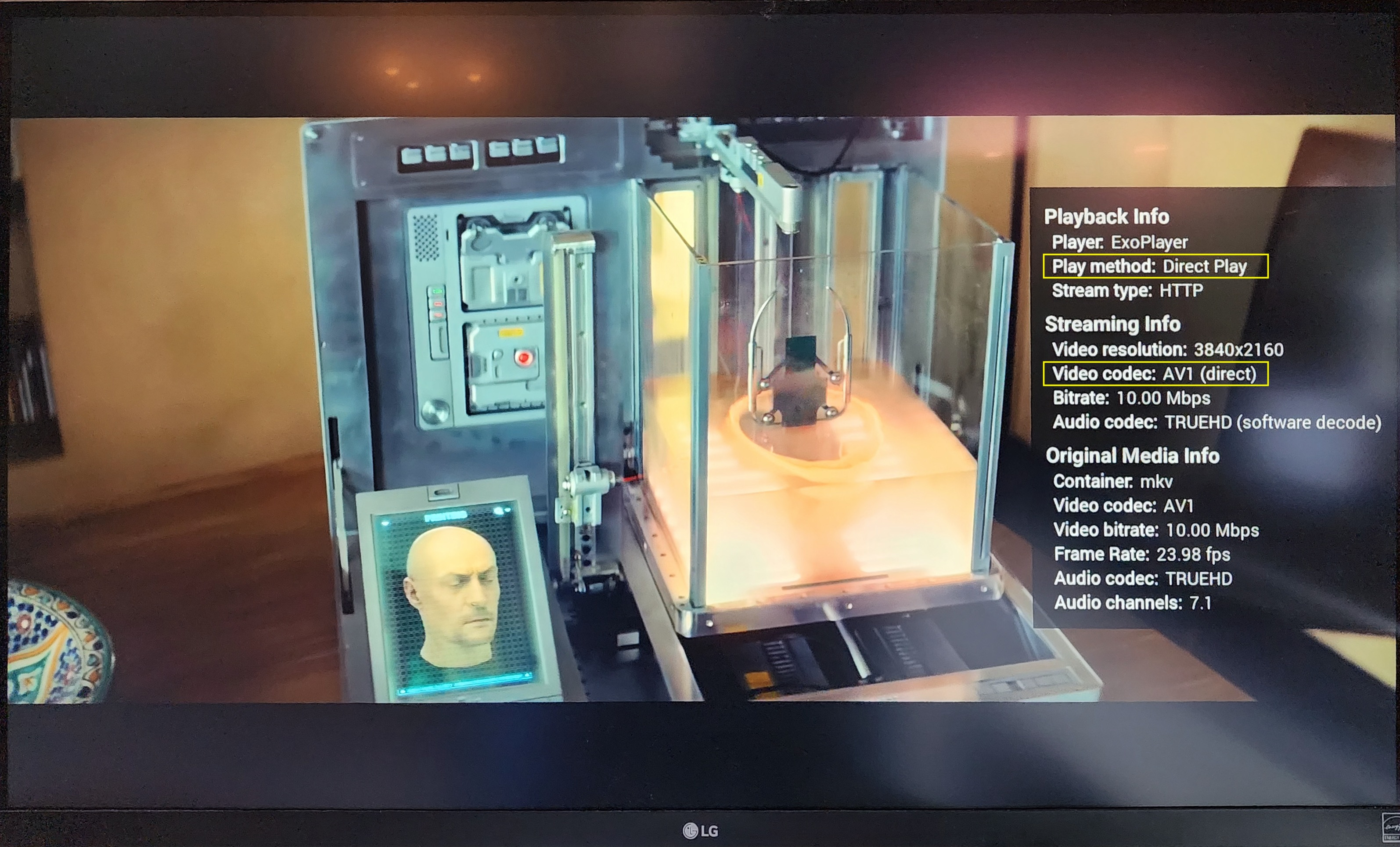

Guest Posted July 21, 2023 Posted July 21, 2023 (edited) 10 minutes ago, ndfan77 said: To add some to this. I was able to get the Emby for Android TV client (2.0.83g) to direct play 2160p AV1 content somewhat reliably (it's only been a couple days) on the Chromecast 4K -- by following this setup sequence: Factory reset the Chromecast 4K Uninstall unneeded apps (Disney+, Apple TV, ESPN, Hulu, Max) Install the Emby for Android TV client (v2.0.83g) from the Play Store, configure it, and test some 2160p AV1 content (which will transcode). Sideload the Emby for Android client (v3.3.8), configure it. Play some 2160p AV1 content on the Emby for Android client. Playback will probably be wonky (frozen images, blank screen, etc.) -- but audio and subtitles should work. Let playback run (even if broken) for ~15+ mins. AV1 content should now direct play correctly on the Emby for Android TV client (and now you can just ignore the Emby for Android client). I was able to duplicate this setup sequence twice. I know it seems a bit wishy-washy, and it's not readily obvious which step is the key to getting AV1 direct playback working on the Emby for Android TV client. But (for whatever reason), letting the Emby for Android client play for 15 - 20 minutes in step 4 (even if not playing right) seems to be a relevant part of the equation as direct AV1 playback on the Emby for Android TV client wouldn't work without it. (Also, there was one instance where the Emby for Android TV client fell back to transcoding AV1 content, and repeating step #5 straightened direct play back out.) FWIW... Are you saying you are able to direct play AV1 files on the Chromecast with Google TV 4k? This one: https://store.google.com/us/config/chromecast_google_tv?hl=en-US&selections=eyJwcm9kdWN0RmFtaWx5IjoiWTJoeWIyMWxZMkZ6ZEY5bmIyOW5iR1ZmZEhZPSIsImhlcm9Qcm9kdWN0cyI6W1siY0hKa1h6YzRNekpmTXprMU1nPT0iLDEsbnVsbF1dfQ%3D%3D Because everything I have read on those says they don't support AV1, only the HD models support it(that much I can confirm). If the 4K model does support AV1 I would like to grab one of those. Edited July 21, 2023 by lukeoslavia

Trelane 38 Posted July 21, 2023 Posted July 21, 2023 (edited) 31 minutes ago, ndfan77 said: Yes, 2160P AV1 direct play seems to be working (rather well) on the Chromecast 4K in the Emby for Android TV Play Store client (v2.0.83g) after following the steps I described previously. But my impression is that it's a house of cards that could blow over pretty easily the next time something else that involves video playback is installed, or the OS is updated, etc... But, I'm going to run with it since the Chromecast 4K isn't my primary streaming device and I'm moving most of my stuff to AV1. Good info tho. This probably explains why I was able to see a few instances of proper direct play during my testing of jumping around between apps and reboots of the 4k Chromecast. I must have stumbled upon this same scenario. However, I was never able to get anything reliable. This only affects Chromecast 4k devices for me too. All my other google TV devices play fine. Edited July 21, 2023 by SeanM
Guest Posted July 22, 2023 Posted July 22, 2023 On 7/21/2023 at 5:03 PM, ndfan77 said: Yes, 2160P AV1 direct play seems to be working (rather well) on the Chromecast 4K in the Emby for Android TV Play Store client (v2.0.83g) after following the steps I described previously. But my impression is that it's a house of cards that could blow over pretty easily the next time something else that involves video playback is installed, or the OS is updated, etc... But, I'm going to run with it since the Chromecast 4K isn't my primary streaming device and I'm moving most of my stuff to AV1. Screen shots: Picked one of these up today and did some testing. I cannot get the sideloaded app to play av1 at all, It uses ffmpeg every time. Its about 50/50 using the play store app. I did get it to direct play a movie for about 50% of its duration though and then it reverted to saying it didn't support the video codec. In general the android TV app just seems VERY bad at detecting AV1 compatibility. I have a ccwgtv HD, several onn 4k streaming boxes, a fire TV cube 3rd gen, and the ccwgtv 4k that I've tested with. So far all of them are a toss up with each file I try to play. I've also sideloaded the apk from the website on all of them and it does direct play more often, but the app runs poorly on most of the boxes. Crashes more often, very sluggish, and spotty playback.

ndfan77 6 Posted July 31, 2023 Posted July 31, 2023 22 minutes ago, ebr said: That is what is going on. Make sense now? I understand the CCGTV4K isn't marketed as being AV1 capable -- but it actually does direct play AV1 in the AndroidTV v2.0.83g client quite well (when it's in a good mood): Would rendering 2160P AV1 with 30 to 40% CPU usage on the CCGTV4K smell like software decoding or hardware?

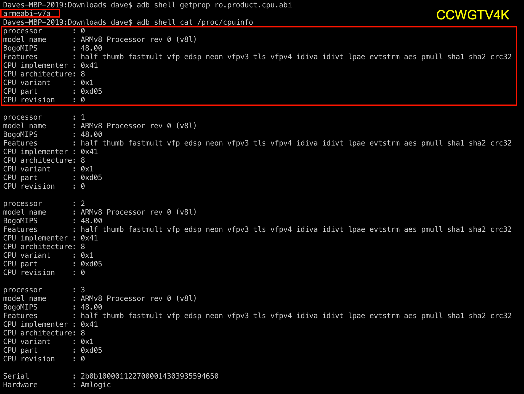

ndfan77 6 Posted July 31, 2023 Posted July 31, 2023 To add more clarity, the Onn Google TV 4K and the Chromecast With Google TV 4K seem to have the same 4-core ARMv8 processor (down to the revision): So, enquiring minds are probably wondering why the Onn Google TV 4K (which works correctly with the sideloaded Emby for Android client v3.3.19) would be any more capable of direct playing AV1 than the Chromecast With Google TV 4K -- when they seem to almost be identical twins (other than the USB port, physical chassis, and remote)...? Also, when the Onn Google TV 4K direct plays the same AV1 2160P content with the sideloaded Emby for Android client (v3.3.19), it uses a similar amount of CPU to the Chromecast With Google TV 4K with the Emby for Android TV client (v.2.0.83g) when it direct plays: 1
