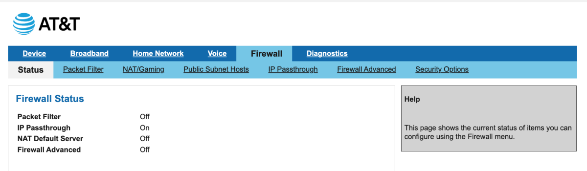

Update,   BGW320-500,
If you are using your own network equipment and want to fully manage your own network and you just want to use the ATT router as a media converter (Fiber to copper ethernet) [ATT still has control of the box and you can not get around this].
Simply Go to Firewall and turn off each service, then turn on IP Passthrough.
Off - Packet Filter
Off - NAT Default Server
Off - Firewall Advanced
ON - IP Passthrough
EMBY, Plex, and all my network items are now happy once again.
