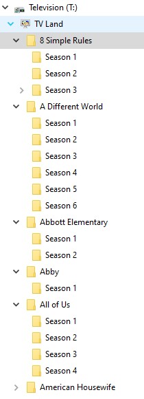

itgreen9 9 Posted October 3, 2022 Author Posted October 3, 2022 I am in folder view in Emby. I have a folder that has 121 sub-folders in it. In Emby when I click on that folder it does not have any of the subfolders in it, Instead it shows the subfolders as seasons. When you click on the seasons folder there is nothing in them. It is not seeing the subfolder as a folder so it's not reading anything underneath it. It was working fine a few days ago.

itgreen9 9 Posted October 3, 2022 Author Posted October 3, 2022 Drive T Main Folder TV Show Season Eps TV Show 2 Season Eps and so on. Is that what you need?
Luke 42289 Posted October 3, 2022 Posted October 3, 2022 1 minute ago, itgreen9 said: Drive T Main Folder TV Show Season Eps TV Show 2 Season Eps and so on. Is that what you need? Can you provide an actual example? Like we're going to need to see folders and file names to get to the root of the problem. Thanks.
Happy2Play 9814 Posted October 3, 2022 Posted October 3, 2022 Along with folder path used in library setup.

Happy2Play 9814 Posted October 3, 2022 Posted October 3, 2022 (edited) Is there a reason you did not point the library to TV Land instead of drive letter root? Are you using the XML plugin to read your xml metadata? If not it is not used at all. Then I would question the episode naming scheme as would that be Season 1 episode 01 or Season 1 Episode 0101? Not saying it will not work but can be a problem. Edited October 3, 2022 by Happy2Play
itgreen9 9 Posted October 3, 2022 Author Posted October 3, 2022 They point to the drive letter because if I don't Emby will show the 100+ folders underneath as the starting point instead of the TV Land folder as the starting point. Creating mass confusion. I have never had a XML plugin before so I was not aware I needed one. I will try that. As for the naming scheme that will take hours to change and I just do not have that type of time unfortunately. Let me try the plugin and I will get back to you. Thanks.

Happy2Play 9814 Posted October 3, 2022 Posted October 3, 2022 Until the issue with complex folder structure is identified this will be an issue with auto detection. 52 minutes ago, itgreen9 said: They point to the drive letter because if I don't Emby will show the 100+ folders underneath as the starting point instead of the TV Land folder as the starting point. So you are using folder view as that is the only view that will show this folder when identified properly. To me it would be a library named TV Land pointing to folder TV Land. That is the only current workaround for this issue when it happens unless we can identify it.
