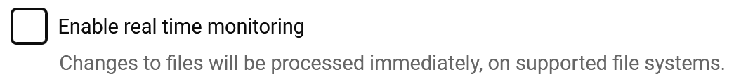

Roodee 39 Posted October 2, 2022 Posted October 2, 2022 (edited) Hi, @Stankowski in the library settings, have you checked real time monitoring? Go to settings -> Library -> Click on the the Library you want to check, and right under the Language settings you see: Edited October 2, 2022 by Roodee Typo!

Happy2Play 9812 Posted October 2, 2022 Posted October 2, 2022 @Roodee Yes it is checked as log shows librarymonitor watching and stopping as it sees change. But per the log their library issues on each new movie. System.IO.DirectoryNotFoundException: Could not find a part of the path --------------------------------------------- But with this being such an old version (May 19, 2021) it will/could be hard to provide support. 1
