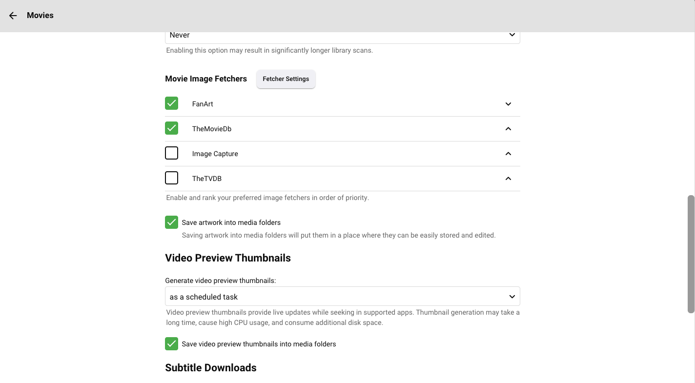

Happy2Play 9812 Posted September 30, 2022 Posted September 30, 2022 Looks normal to me for an incomplete scan. But the example is incomplete as what images are shown via Edit images? As I can only guess that fanart maybe in the Poster position. Do you save images with media? If so what images are in the folder?
TheGru 156 Posted September 30, 2022 Author Posted September 30, 2022 upon looking at the edit images screen for the example, The Expendables, there is no image set as the Primary
roaku 842 Posted September 30, 2022 Posted September 30, 2022 2 minutes ago, TheGru said: upon looking at the edit images screen for the example, The Expendables, there is no image set as the Primary I don't see files named fanart1.jpg or fanart2.jpg in the directory you showed us. Are you sure your library is configured to read/store images with the media?
TheGru 156 Posted September 30, 2022 Author Posted September 30, 2022 Just now, roaku said: I don't see files named fanart1.jpg or fanart2.jpg in the directory you showed us. Are you sure your library is configured to read/store images with the media?
