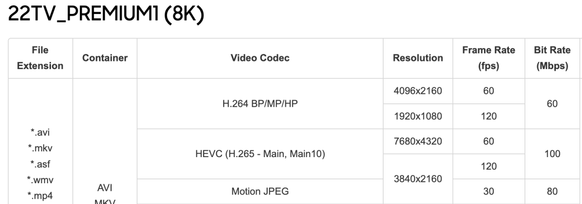

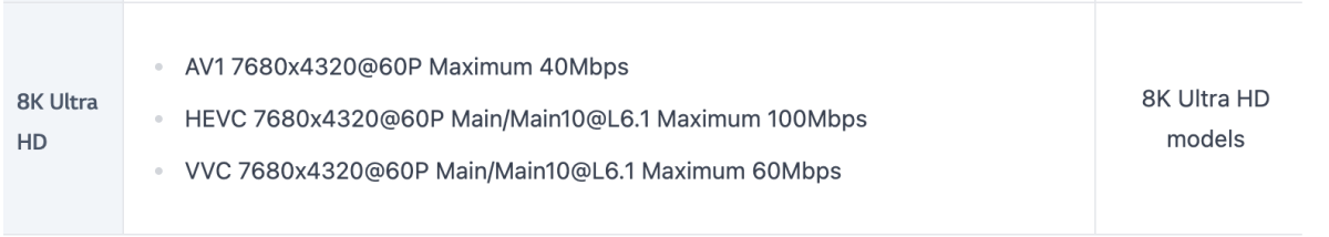

SamES 1084 Posted October 1, 2022 Posted October 1, 2022 (edited) The traffic you see on the router is probably the TV trying to read-ahead and buffer the movie. For example, to build a 10 sec buffer the TV will need to pull a lot of data initially. If your file is on another storage device on your network, then remember that the server needs to read the file from your storage device, then the TV reads the file from the server so the network traffic can be double the file bitrate 185 Mbps is a very high bitrate and probably far exceeds the TV's recommended bitrate for streaming. For example, the latest Samsung 8K TV's specify a maximum of 100 Mbps for 8K media playback. LG 2022 TV's have a specs I would suggest at 185Mbps you might be expecting more than most TVs are capable of Edited October 1, 2022 by SamES
moozart 3 Posted October 1, 2022 Author Posted October 1, 2022 8 hours ago, SamES said: The traffic you see on the router is probably the TV trying to read-ahead and buffer the movie. For example, to build a 10 sec buffer the TV will need to pull a lot of data initially. If your file is on another storage device on your network, then remember that the server needs to read the file from your storage device, then the TV reads the file from the server so the network traffic can be double the file bitrate 185 Mbps is a very high bitrate and probably far exceeds the TV's recommended bitrate for streaming. For example, the latest Samsung 8K TV's specify a maximum of 100 Mbps for 8K media playback. LG 2022 TV's have a specs I would suggest at 185Mbps you might be expecting more than most TVs are capable of Fair enough, up to date I never had any issues up to 16 MBps, this is the first time at 18 MBps which it struggles. So I might then reached its limit. 1
