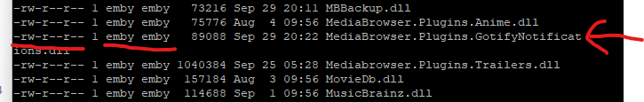

taker1988 21 Posted September 29, 2022 Posted September 29, 2022 Hi, wollte mir das Gotify Emby Plugin installieren. Ich habe es mit Putty in den Pluginsordner kopiert. Aber es taucht im der WebUI nicht auf. Ich glaube da sind die Rechte nun falsch gesetzt, weil es die einzigste Datei ist, die nicht den User "emby" zeigt, sondern root. Aber ich kann mich nun auch irren. Kann mir jemand sagen, wie ich da die Rechte richtig setze? Danke

taker1988 21 Posted September 29, 2022 Author Posted September 29, 2022 (edited) Sure, i did. I copied the *.dll with sudo cp /path/to/file/xxx.dll /plugins - now i guess the file can only be read by a root user? i think i need to set it, like the other files to "emby" user and those rights like shown in the picture above -rw-r--r-- but i dont know how i can do this. ^^ Edited September 29, 2022 by taker1988

Solution taker1988 21 Posted September 29, 2022 Author Solution Posted September 29, 2022 (edited) I got it. sudo chown emby /volume1/@appdata/EmbyServer/plugins/MediaBrowser.Plugins.GotifyNotifications.dll sudo chgrp emby /volume1/@appdata/EmbyServer/plugins/MediaBrowser.Plugins.GotifyNotifications.dll sudo chmod 644 /volume1/@appdata/EmbyServer/plugins/MediaBrowser.Plugins.GotifyNotifications.dll Now the file is in the right group, got the right permissions and its owned by the right user (?) restarted the server and the plugin is showing up. Edited September 29, 2022 by taker1988 1 1
