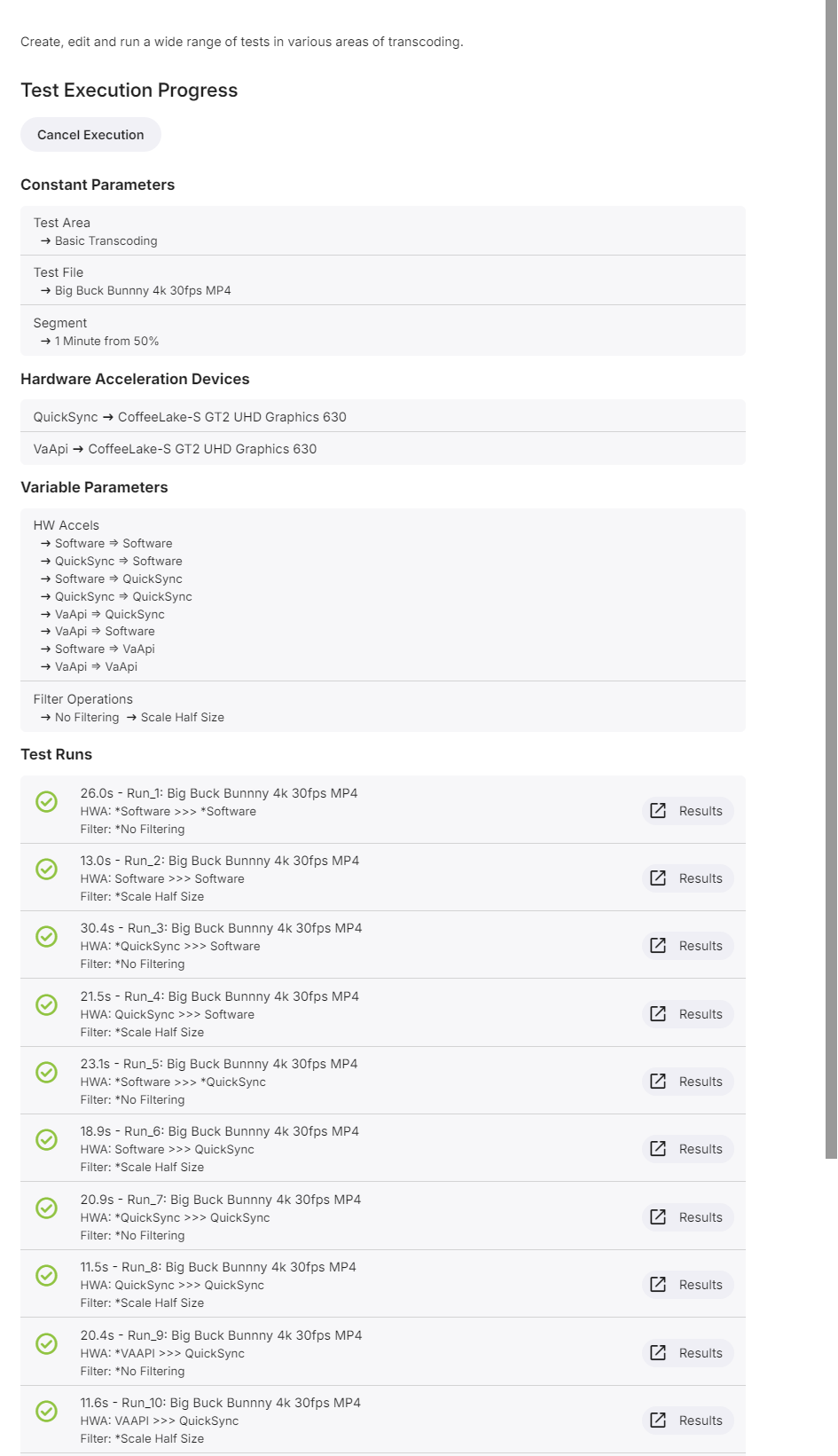

softworkz 5133 Posted March 17, 2024 Author Posted March 17, 2024 7 hours ago, rb9999 said: Stupid question I know, but how do I view the transcoding test reports? The best way of viewing them is within the plugin.You see a list of test runs and for each, you can click on the "Results" button to view details: But I think you are asking about those links at the top like: and These links use the "localexplorer:" protocol and to open them, you need to install the browser extension that is mentioned at the bottom of the second post in this topic: https://emby.media/community/index.php?/topic/112572-server-plugin-transcoding-tests/&do=findComment&comment=1185602 As the name says, this is for local access, which means that you need to have access to the exact same file path on the machine where the browser is running. You could probably achieve this by creating the same mount inside proxmox and on the outer machine (pointing to the same data) and configure that path for the test output of the transcoding test plugin settings. Then it might work (haven't tried on Linux, though). The reason why there's no implementatoin for remote downloading is that this would have taken several days of development, because allowing downloads from the file system is security critical and needs careful implementation - which is just out of scope for this plugin. To make it still fairly easy when localexplorer: doesn't work, it is showing you the full paths for all the files, so you can just copy/paste them for accessing them with a tool of your choice (ssh, ftp, scp, etc.) The top-level files for a test plan execution are always these two: .etrd - Emby Test Report Data This is a JSON file with data for all runs. It references other output files in the file system (in subfolder) by relative paths. It is meant to be used when accessing it directly in the file system where it has been written to .etra - Emby Test Report Archive This is simply a ZIP file. When you extract it, you get the full directory structure like in the output folder. There's also the .etrd JSON file and it's all the same as when accessing locally

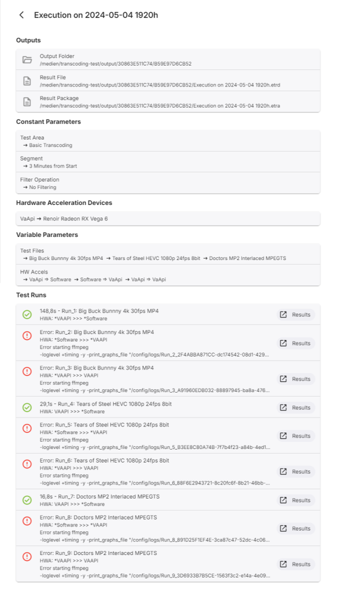

gh0stwriter 3 Posted May 3, 2024 Posted May 3, 2024 (edited) Not sure why these encode tests fail... only with VAAPI encoder, the software>software and VAAPI>software works so it should not be a permissions issue. Also it seems to work just fine with the videos I stream from Emby (near zero CPU with streaming 1080p etc....instead of like 25-50% This is on a quad core QNAP 6 bay AMD Ryzen Embedded V1500B + Radeon WX4100 graphics) Digging: Error starting ffmpeg -loglevel +timing -y -print_graphs_file "/config/logs/Run_2_30DA1DF3F923-b7627e3b-1a02-4d42-b7d1-ac536ee77770_1graph.txt" -copyts -start_at_zero -init_hw_device "vaapi=vad0:/dev/dri/renderD128" -filter_hw_device vad0 -f mp4 -t 00:03:00.000 -c:v:0 h264 -noautorotate -i "/tmp/bbb_sunflower_2160p_30fps_normal.mp4" -filter_complex "[0:0]format@f1=pix_fmts=nv12,hwupload@f2[f2_out0]" -map [f2_out0] -map 0:1 -sn -c:v:0 h264_vaapi -b:v:0 7498181 -g:v:0 180 -maxrate:v:0 7498181 -bufsize:v:0 14996362 -keyint_min:v:0 180 -compression_level:v:0 6 -r:v:0 30 -profile:v:0 main -c:a:0 copy -disposition:a:0 default -avoid_negative_ts disabled -map_metadata -1 -map_chapters -1 "/tmp/E4ADE9B252CD/65B7625FE531/Run_2/out.mkv" 20:08:15.167 ffmpeg version 5.1-emby_2023_06_25 Copyright (c) 2000-2022 the FFmpeg developers and softworkz for Emby LLC 20:08:15.167 built with gcc 10.3.0 (crosstool-NG 1.25.0) 20:08:15.167 Execution Date: 2024-05-03 20:08:15 amdgpu: os_same_file_description couldn't determine if two DRM fds reference the same file description. If they do, bad things may happen! 20:08:16.119 Input #0, mov,mp4,m4a,3gp,3g2,mj2, from '/tmp/bbb_sunflower_2160p_30fps_normal.mp4': 20:08:16.119 Metadata: 20:08:16.119 major_brand : isom 20:08:16.119 minor_version : 1 20:08:16.119 compatible_brands: isomavc1 20:08:16.119 creation_time : 2013-12-18T14:43:04.000000Z 20:08:16.119 title : Big Buck Bunny, Sunflower version 20:08:16.119 artist : Blender Foundation 2008, Janus Bager Kristensen 2013 20:08:16.119 comment : Creative Commons Attribution 3.0 - http://bbb3d.renderfarming.net 20:08:16.119 genre : Animation 20:08:16.119 composer : Sacha Goedegebure 20:08:16.119 Duration: 00:10:34.53, start: 0.000000, bitrate: 7980 kb/s 20:08:16.119 Stream #0:0[0x1](und): Video: h264 (High) (avc1 / 0x31637661), yuv420p(progressive), 3840x2160 [SAR 1:1 DAR 16:9], 7498 kb/s, Level 51, 30 fps, 30 tbr, 30k tbn, Start-Time 0.067s (default) 20:08:16.119 Metadata: 20:08:16.119 creation_time : 2013-12-18T14:43:04.000000Z 20:08:16.119 handler_name : GPAC ISO Video Handler 20:08:16.119 vendor_id : [0][0][0][0] 20:08:16.119 Stream #0:1[0x2](und): Audio: mp3 (mp4a / 0x6134706D), 48000 Hz, stereo, fltp, 160 kb/s (default) 20:08:16.119 Metadata: 20:08:16.119 creation_time : 2013-12-18T14:43:06.000000Z 20:08:16.119 handler_name : GPAC ISO Audio Handler 20:08:16.119 vendor_id : [0][0][0][0] 20:08:16.119 Stream #0:2[0x3](und): Audio: ac3 (ac-3 / 0x332D6361), 48000 Hz, 5.1(side), fltp, 320 kb/s (default) 20:08:16.119 Metadata: 20:08:16.119 creation_time : 2013-12-18T14:43:06.000000Z 20:08:16.119 handler_name : GPAC ISO Audio Handler 20:08:16.119 vendor_id : [0][0][0][0] 20:08:16.119 Side data: 20:08:16.119 audio service type: main 20:08:16.127 Stream mapping: 20:08:16.127 Stream #0:0 (h264) -> format:default 20:08:16.127 hwupload:default -> Stream #0:0 (h264_vaapi) 20:08:16.127 Stream #0:1 -> #0:1 (copy) 20:08:16.127 Press [q] to stop, [?] for help 20:08:16.346 [h264_vaapi @ 0x1e321c0] Driver does not support some wanted packed headers (wanted 0xd, found 0). 20:08:16.346 [h264_vaapi @ 0x1e321c0] Driver does not support packed sequence headers, but a global header is requested. 20:08:16.346 [h264_vaapi @ 0x1e321c0] No global header will be written: this may result in a stream which is not usable for some purposes (e.g. not muxable to some containers). 20:08:16.346 [h264_vaapi @ 0x1e321c0] Quality attribute is not supported: will use default quality level. 20:08:16.347 Could not write header for output file #0 (incorrect codec parameters ?): Invalid data found when processing input 20:08:16.347 Error initializing output stream 0:0 -- 20:08:16.351 Conversion failed! 20:08:16.351 EXIT [ "Test Log", "Info: Bitrate exceeds DirectPlay limit: media bitrate: 7980875, max bitrate: 1000000", "Info: Bitrate exceeds DirectStream limit: media bitrate: 7980875, max bitrate: 1000000", "Error: Error during sync transcoding\nEmby.Server.MediaEncoding.Unified.Ffmpeg.FfRunException: Error starting ffmpeg\n-loglevel +timing -y -print_graphs_file \"/config/logs/Run_2_30DA1DF3F923-b7627e3b-1a02-4d42-b7d1-ac536ee77770_1graph.txt\" -copyts -start_at_zero -init_hw_device \"vaapi=vad0:/dev/dri/renderD128\" -filter_hw_device vad0 -f mp4 -t 00:03:00.000 -c:v:0 h264 -noautorotate -i \"/tmp/bbb_sunflower_2160p_30fps_normal.mp4\" -filter_complex \"[0:0]format@f1=pix_fmts=nv12,hwupload@f2[f2_out0]\" -map [f2_out0] -map 0:1 -sn -c:v:0 h264_vaapi -b:v:0 7498181 -g:v:0 180 -maxrate:v:0 7498181 -bufsize:v:0 14996362 -keyint_min:v:0 180 -compression_level:v:0 6 -r:v:0 30 -profile:v:0 main -c:a:0 copy -disposition:a:0 default -avoid_negative_ts disabled -map_metadata -1 -map_chapters -1 \"/tmp/E4ADE9B252CD/65B7625FE531/Run_2/out.mkv\"\n\n20:08:15.167 ffmpeg version 5.1-emby_2023_06_25 Copyright (c) 2000-2022 the FFmpeg developers and softworkz for Emby LLC\n20:08:15.167 built with gcc 10.3.0 (crosstool-NG 1.25.0)\n20:08:15.167 Execution Date: 2024-05-03 20:08:15\namdgpu: os_same_file_description couldn't determine if two DRM fds reference the same file description.\nIf they do, bad things may happen!\n20:08:16.119 Input #0, mov,mp4,m4a,3gp,3g2,mj2, from '/tmp/bbb_sunflower_2160p_30fps_normal.mp4':\n20:08:16.119 Metadata:\n20:08:16.119 major_brand : isom\n20:08:16.119 minor_version : 1\n20:08:16.119 compatible_brands: isomavc1\n20:08:16.119 creation_time : 2013-12-18T14:43:04.000000Z\n20:08:16.119 title : Big Buck Bunny, Sunflower version\n20:08:16.119 artist : Blender Foundation 2008, Janus Bager Kristensen 2013\n20:08:16.119 comment : Creative Commons Attribution 3.0 - http://bbb3d.renderfarming.net\n20:08:16.119 genre : Animation\n20:08:16.119 composer : Sacha Goedegebure\n20:08:16.119 Duration: 00:10:34.53, start: 0.000000, bitrate: 7980 kb/s\n20:08:16.119 Stream #0:0[0x1](und): Video: h264 (High) (avc1 / 0x31637661), yuv420p(progressive), 3840x2160 [SAR 1:1 DAR 16:9], 7498 kb/s, Level 51, 30 fps, 30 tbr, 30k tbn, Start-Time 0.067s (default)\n20:08:16.119 Metadata:\n20:08:16.119 creation_time : 2013-12-18T14:43:04.000000Z\n20:08:16.119 handler_name : GPAC ISO Video Handler\n20:08:16.119 vendor_id : [0][0][0][0]\n20:08:16.119 Stream #0:1[0x2](und): Audio: mp3 (mp4a / 0x6134706D), 48000 Hz, stereo, fltp, 160 kb/s (default)\n20:08:16.119 Metadata:\n20:08:16.119 creation_time : 2013-12-18T14:43:06.000000Z\n20:08:16.119 handler_name : GPAC ISO Audio Handler\n20:08:16.119 vendor_id : [0][0][0][0]\n20:08:16.119 Stream #0:2[0x3](und): Audio: ac3 (ac-3 / 0x332D6361), 48000 Hz, 5.1(side), fltp, 320 kb/s (default)\n20:08:16.119 Metadata:\n20:08:16.119 creation_time : 2013-12-18T14:43:06.000000Z\n20:08:16.119 handler_name : GPAC ISO Audio Handler\n20:08:16.119 vendor_id : [0][0][0][0]\n20:08:16.119 Side data:\n20:08:16.119 audio service type: main\n20:08:16.127 Stream mapping:\n20:08:16.127 Stream #0:0 (h264) -> format:default\n20:08:16.127 hwupload:default -> Stream #0:0 (h264_vaapi)\n20:08:16.127 Stream #0:1 -> #0:1 (copy)\n20:08:16.127 Press [q] to stop, [?] for help\n20:08:16.346 [h264_vaapi @ 0x1e321c0] Driver does not support some wanted packed headers (wanted 0xd, found 0).\n20:08:16.346 [h264_vaapi @ 0x1e321c0] Driver does not support packed sequence headers, but a global header is requested.\n20:08:16.346 [h264_vaapi @ 0x1e321c0] No global header will be written: this may result in a stream which is not usable for some purposes (e.g. not muxable to some containers).\n20:08:16.346 [h264_vaapi @ 0x1e321c0] Quality attribute is not supported: will use default quality level.\n20:08:16.347 Could not write header for output file #0 (incorrect codec parameters ?): Invalid data found when processing input\n20:08:16.347 Error initializing output stream 0:0 -- \n20:08:16.351 Conversion failed!\n20:08:16.351 EXIT\n\n\n\n\n at Emby.Server.MediaEncoding.Encoder.BaseEncoder.Start(EncodingJobOptions options, IProgress`1 progress, CancellationToken cancellationToken)\n at Emby.Server.MediaEncoding.Tests.ServerTranscodingTestManager.Start(EncodingJobOptions options, IProgress`1 progress, CancellationToken cancellationToken)\n at Emby.TranscodingTestPlugin.Operation.Transcode.SingleTestRunExecutor.RunTranscode(ExecutionRun executionRun, String outputRoot, SessionInfo sessionInfo, ExecutionHwDeviceSelectionList hwDeviceSelections, TestImageExtraction imageExtraction, CancellationToken cancellationToken)" Edited May 3, 2024 by gh0stwriter add log
JBou 0 Posted May 4, 2024 Posted May 4, 2024 Hello, I faced this problem myself (using VAAPI on Unraid with an AMD Renoir Radeon RX Vega 6 iGPU) I searched a bit on the Internet and found out that there existed an issue: https://gitlab.freedesktop.org/mesa/mesa/-/issues/3524 It is fixed in mesa 23.3.1 and later, but Emby still uses Mesa Gallium driver 23.1.6 by default. So I created a scriptt based on https://github.com/linuxserver/docker-mods/tree/jellyfin-amd to update the mesa driver inside the container: https://gist.github.com/JBou/41a19db4c513d7acc7f6b97d151da7ff And afterwards you have to go to Diagnostic Options -> FFmpeg Options and change the following parameters: Use custom LD_LIBRARY_PATH = /usr/lib/x86_64-linux-gnu:/app/emby/lib:/app/emby/extra/lib Use custom LIBVA_DRIVERS_PATH = /usr/lib/x86_64-linux-gnu/dri:/app/emby/extra/lib/dri Next go to Dashboard and restart the emby server. ALTERNATIVELY, just add the following docker mod to the container: https://github.com/linuxserver/docker-mods/tree/jellyfin-amd It is the same script Execute the transcoding tests again, and you should see that the test pass. I think Emby should update the embedded mesa driver to the newest version, this should fix some issues with transcoding OLD: AFTER:
softworkz 5133 Posted May 5, 2024 Author Posted May 5, 2024 On 5/3/2024 at 10:15 PM, gh0stwriter said: Not sure why these encode tests fail... only with VAAPI encoder, the software>software and VAAPI>software works so it should not be a permissions issue. Also it seems to work just fine with the videos I stream from Emby (near zero CPU with streaming 1080p etc....instead of like 25-50% This is on a quad core QNAP 6 bay AMD Ryzen Embedded V1500B + Radeon WX4100 graphics) Hardware transcoding with AMD hardware has a range of limitations as the support in ffmpeg is still lagging behind Nvidia and Intel in this regard. In regular operation, Emby Server sets up transcoding with AMD accordingly, in a way that those limitations won't be encountered by choosing procedure which are working. I.e. the transcoding unit is being informed about the source material and the desired output. Knowing about the available hw capabilities, it chooses the best possible way to transcode. For the transcoding tests, the pattern is quite different: When you set up a test, you are the one to choose which ways of transcoding you want to test. The transcoding unit does not make any choices, it just executes what and how is requested. This means that the transcoding tests are often performing transcodes in a way which might be just the 4th, 5th, 6th..option or even might never be performed this way normally - or only rarely. And that's a key point of the transcoding tests: To have wide coverage of all the possible cases, so we can know early when something goes wrong or doesn't behave anymore like it did earlier. Recent and < 3-4 years old Intel and Nvidia GPUs are usually getting close to 100%, but for AMD graphics it's expected that a substantial amount of the tests doesn't succeed, so nothing to worry about.
Luke 42255 Posted May 25, 2024 Posted May 25, 2024 @JBou. @gh0stwriter the driver is updated in newer builds. Can you please try it again? Thanks. 1

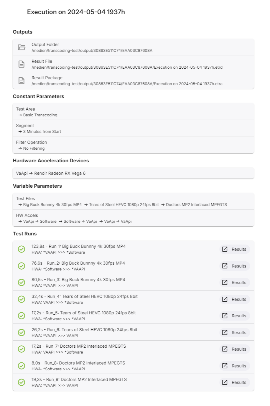

JBou 0 Posted June 1, 2024 Posted June 1, 2024 (edited) Hi @Luke, sorry for the delay, I was stuck by the following issue: After it has been fixed, I have done some transcoding tests now, using the following EMBY Versions (using linuxserver docker): Device Information: OS: Unraid 6.12.10 Processor: AMD Ryzen 7 PRO 4750G with Radeon Graphics (integrated Graphics (iGPU)) Emby 4.8.8.0: Mesa Gallium driver 23.1.6 for AMD Radeon Graphics (renoir, LLVM 15.0.7, DRM 3.49, 6.1.79-Unraid) The above error is fixed, but it uses still the old 23.1.6 mesa driver, is not updated. for reference I attach the test, where: 99 succeded, 157 failed, 4 failed validation Emby 4.9.0.21 beta: Mesa Gallium driver 24.0.6 for AMD Radeon Graphics (radeonsi, renoir, LLVM 17.0.6, DRM 3.49, 6.1.79-Unraid) it uses the new mesa driver. transcoding tests attached, where: 193 succeded, 52 failed, 4 failed validation Emby 4.9.0.22 beta (newly pushed docker image): Mesa Gallium driver 24.1.0 for AMD Radeon Graphics (radeonsi, renoir, LLVM 17.0.6, DRM 3.49, 6.1.79-Unraid) Testing now, but I expect the same result as in 4.9.0.22 beta. I hope the new mesa driver will soon be integrated into the stable release too, as it now works in the beta without the issue linked above. As you can see, after the Update of the mesa driver, there are about 100 fixed transcoding tests, which is a HUGE improvement for AMD GPUs. Note that there are 19 tests with the following issue: Object reference not set to an instance of an object These should be looked at, they might be possible to fix, as it is a problem in the C# code it seems. One last thing I am looking forward is proper support for tone mapping using AMD GPUs. I still have some problems with it. I hope there is a possibility in the future (maybe also using Vulkan?). Normal HW acceleration and subtitle burn in is already working quite great. Thank you for your awesome work on the product and best greetings, JBou Emby 4.8.8.0.etra Emby 4.8.8.0.etrd Emby 4.9.0.21 beta.etrd Emby 4.9.0.21 beta.etra Edited June 1, 2024 by JBou

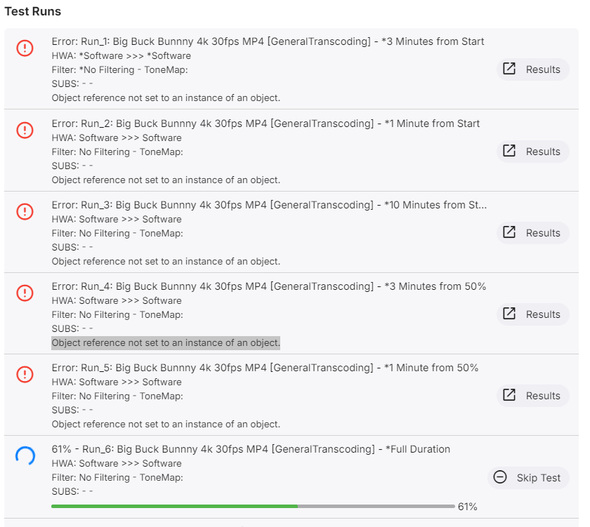

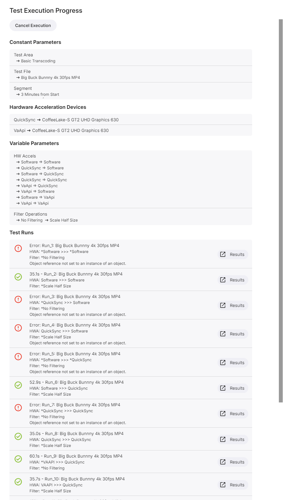

Jdiesel 1439 Posted July 31, 2024 Posted July 31, 2024 (edited) I was playing around with this plugin today and noticed a strange occurrence. When i choose the segment "three minutes from start" get a lot of "Object reference not set.." errors but when i select 1 minute from 50% I no longer get them. Image extraction is enabled for both tests. Is this a bug with the plugin or transcoding related? Execution on 2024-07-31 1237h.etra Execution on 2024-07-31 1237h.etrd Execution on 2024-07-31 1221h.etra Execution on 2024-07-31 1221h.etrd Edited July 31, 2024 by Jdiesel 1
