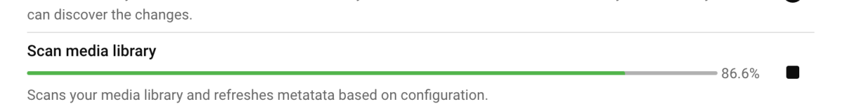

fatshotty 4 Posted September 29, 2022 Author Posted September 29, 2022 as per screenshot: yesterday the "Scan library" task was at 90.7% . Today it is on 86.6% . So... maybe it has re-started during the night?! However, now I remove any trigger for "detect intros" and "scan library" tasks, just to be sure emby doesn't re-start the scan... Let u know any news about that thanks
