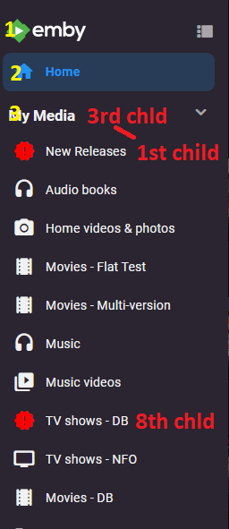

Happy2Play 9811 Posted September 29, 2022 Posted September 29, 2022 3 hours ago, BGman said: This works when used exactly as is... BUT when I change div:nth-child(3) to div:nth-child(8) it doesn't work.. in fact when I change it to anything other than "3" it doesn't work. Yes I change all 4 occurrences. Latest emby premiere version. There are two so which one did you change? body > div.mainDrawer.focuscontainer-y.emby-scroller.scrollY.hiddenScrollY-hover.scrollY-mini.drawer-open > div > div:nth-child(3) > div > div:nth-child(8) > div > div.navDrawerListItemImageContainer.listItemImageContainer.itemAction.listItemImageContainer-square.defaultCardBackground.defaultCardBackground0 > i 3 hours ago, BGman said: Also, from your experience what exactly needs to be done to refresh the custom css box?? Normally just a refresh for css. But not a Linux user. Are you copy and pasting code as there is a user that had issues of invalid characterss being entered with copy and paste. https://emby.media/community/index.php?/topic/85922-about-the-search-page-embyserver-4420/&do=findComment&comment=1165602

Happy2Play 9811 Posted September 29, 2022 Posted September 29, 2022 (edited) 16 minutes ago, BGman said: I'm totally confused.. your saying 2 different things in the same sentence.. you said, the code you posted works on 3rd section 8th child? and then you say The original code is 3rd section 3rd child. Did you look at the code first code has div:nth-child(3) > div > div:nth-child(3) recent posted code has div:nth-child(3) > div > div:nth-child(8) So this works on 8th child in 3rd section ie first 3rd child. body > div.mainDrawer.focuscontainer-y.emby-scroller.scrollY.hiddenScrollY-hover.scrollY-mini.drawer-open > div > div:nth-child(3) > div > div:nth-child(8) > div > div.navDrawerListItemImageContainer.listItemImageContainer.itemAction.listItemImageContainer-square.defaultCardBackground.defaultCardBackground0 > i { visibility:hidden; content: ''; } body > div.mainDrawer.focuscontainer-y.emby-scroller.scrollY.hiddenScrollY-hover.scrollY-mini.drawer-open > div > div:nth-child(3) > div > div:nth-child(8) > div > div.navDrawerListItemImageContainer.listItemImageContainer.itemAction.listItemImageContainer-square.defaultCardBackground.defaultCardBackground0 > i:before { visibility: visible; position: absolute; color: red; content:"new_releases"; } Edited September 29, 2022 by Happy2Play 1 1
BGman 4 Posted September 29, 2022 Author Posted September 29, 2022 18 minutes ago, Happy2Play said: So this works on 8th child in 3rd section ie first 3rd child. body > div.mainDrawer.focuscontainer-y.emby-scroller.scrollY.hiddenScrollY-hover.scrollY-mini.drawer-open > div > div:nth-child(3) > div > div:nth-child(8) > div > div.navDrawerListItemImageContainer.listItemImageContainer.itemAction.listItemImageContainer-square.defaultCardBackground.defaultCardBackground0 > i { visibility:hidden; content: ''; } body > div.mainDrawer.focuscontainer-y.emby-scroller.scrollY.hiddenScrollY-hover.scrollY-mini.drawer-open > div > div:nth-child(3) > div > div:nth-child(8) > div > div.navDrawerListItemImageContainer.listItemImageContainer.itemAction.listItemImageContainer-square.defaultCardBackground.defaultCardBackground0 > i:before { visibility: visible; position: absolute; color: red; content:"new_releases"; } Ok, got it.. this works perfectly! Now if I could worry you about one last thing in regards to this. When I visit Home via browser: http://XX.XX.XX:8096/web/index.html#!/home The CSS changes work perfectly. But when I visit Home via browser: http://app.emby.media/#!/home The CSS changes do not work. I understand that this css styling is in the custom css box.. which is in branding.xml. Is this why it doesn't show in app.emby.media? Is there a way to get this css into app.emby.media?
Happy2Play 9811 Posted September 29, 2022 Posted September 29, 2022 2 minutes ago, BGman said: But when I visit Home via browser: http://app.emby.media/#!/home The CSS changes do not work. I understand that this css styling is in the custom css box.. which is in branding.xml. Is this why it doesn't show in app.emby.media? Is there a way to get this css into app.emby.media? It will not work as you are using an online client and not your server client but are proxied to your server. As you can see the online client is a different version number also. So only direct connections to your server will work ie WANIP:port or DDNS:port. 1
BGman 4 Posted September 30, 2022 Author Posted September 30, 2022 8 hours ago, Happy2Play said: It will not work as you are using an online client and not your server client but are proxied to your server. As you can see the online client is a different version number also. So only direct connections to your server will work ie WANIP:port or DDNS:port. Thanks for explaining! I fully understand now.
