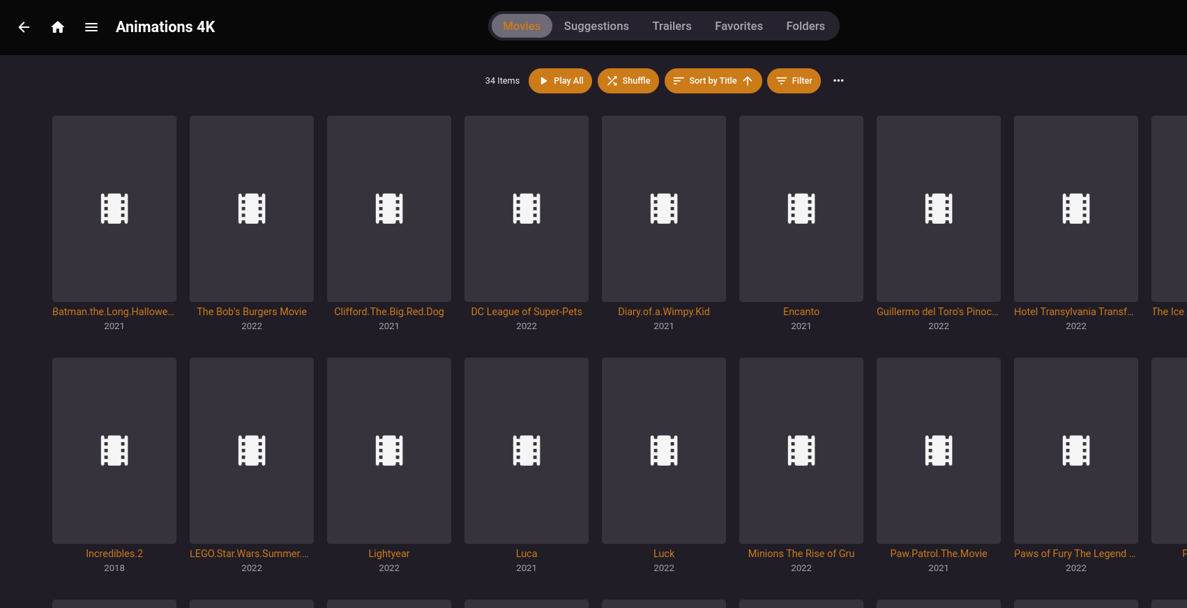

thegrunge 29 Posted September 18, 2022 Posted September 18, 2022 (edited) Hello, I'm trying to migrate emby from docker to ubuntu, but even if I have the backup plugin, it doesn't really work. Folders and members are imported, but libraries must be scanned in full. I also tried to transfer the files mentioned in the manual migration procedure, but it crashes emby, so I tried 3 times and I had to format 3 times, because after emby is crashed there is no more nothing to do. I spent the day on it I'm starting to be desperate. Why does it work so well restoring in docker and so badly manually from one system to another? The only thing I transferred was the metadata in the end, I didn't risk it. nothing more. But it does not change anything. Thanks! Edited September 18, 2022 by thegrunge Picture
