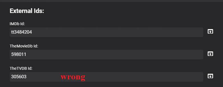

Happy2Play 9814 Posted September 19, 2022 Posted September 19, 2022 31 minutes ago, Locutus64 said: Changing to TMDB first seems to have solved the issue. Moved the file to the desktop, went to libraries, changed the order in the Movies library, scanned the library, moved the file back, scanned the the library again, checked and it's listed correctly. It was driving me nuts cause it would get the correct poster and backdrop but the wrong title and information. Thanks for the help, much appreciated. Yes changing TMDB first hides the issue as everything will come from first provider and your TVDB on details page will be wrong. So there is still a mismatch per externalid on item metadata. As the movie does not exist on TVDB. @LukeWhy does the mismatch happen here? TVDB wrong, will assume IMDB came from TVDB query but did not use same TMDBid. TMDB used filename id. 2022-09-19 12:55:22.235 Debug App: Running TvdbMovieProvider for C:\Users\Media\Desktop\Videos\Movies - Flat test\Norman (2021) [tmdbid=598011].strm 2022-09-19 12:55:22.235 Info HttpClient: GET https://api4.thetvdb.com/v4/search?type=movie&q=598011&remote_id=598011 2022-09-19 12:55:22.504 Info HttpClient: GET https://api4.thetvdb.com/v4/search?type=movie&q=Norman&year=2021 2022-09-19 12:55:22.711 Info HttpClient: GET https://api4.thetvdb.com/v4/movies/305603/extended?meta=translations 2022-09-19 12:55:22.790 Debug App: Running MovieDbProvider for C:\Users\Media\Desktop\Videos\Movies - Flat test\Norman (2021) [tmdbid=598011].strm 2022-09-19 12:55:22.791 Info HttpClient: GET https://api.themoviedb.org/3/movie/598011?api_key=f6bd687ffa63cd282b6ff2c6877f2669&append_to_response=alternative_titles,reviews,casts,releases,images,keywords,trailers&language=en&include_image_language=en,null 2022-09-19 12:55:22.819 Debug App: Running OmdbItemProvider for C:\Users\Media\Desktop\Videos\Movies - Flat test\Norman (2021) [tmdbid=598011].strm 2022-09-19 12:55:22.826 Info HttpClient: GET https://private.omdbapi.com?apikey=fe53f97e&i=tt9827352&plot=short&tomatoes=true&r=json 2022-09-19 12:55:23.221 Debug App: Running MovieDbImageProvider for C:\Users\Media\Desktop\Videos\Movies - Flat test\Norman (2021) [tmdbid=598011].strm 2022-09-19 12:55:23.223 Info HttpClient: GET https://api.themoviedb.org/3/movie/598011?api_key=f6bd687ffa63cd282b6ff2c6877f2669&append_to_response=alternative_titles,reviews,casts,releases,images,keywords,trailers TVDB results chose wrong first item. Spoiler { "status": "success", "data": [ { "objectID": "movie-305603", "country": "usa", "director": "Dante Alencastre", "extended_title": "AIDS Diva: the Legend of Connie Norman (2021)", "genres": [ "Documentary", "History" ], "id": "movie-305603", "image_url": "https://artworks.thetvdb.com/banners/movies/305603/posters/fdGnOeFP5g4aWqboIsm1tptbbeS.jpg", "name": "AIDS Diva: the Legend of Connie Norman", "overview": "Seizing her power as she confronts her mortality, trailblazing trans activist Connie Norman evolves as an irrepressible, challenging and soulful voice for the AIDS and queer communities of early 90's Los Angeles.", "primary_language": "eng", "primary_type": "movie", "status": "Released", "type": "movie", "tvdb_id": "305603", "year": "2021", "slug": "aids-diva-the-legend-of-connie-norman", "overviews": { "eng": "Seizing her power as she confronts her mortality, trailblazing trans activist Connie Norman evolves as an irrepressible, challenging and soulful voice for the AIDS and queer communities of early 90's Los Angeles." }, "translations": { "eng": "AIDS Diva: the Legend of Connie Norman" }, "remote_ids": [ { "id": "tt9827352", "type": 2, "sourceName": "IMDB" }, { "id": "596490", "type": 10, "sourceName": "TheMovieDB.com" } ], "thumbnail": "https://artworks.thetvdb.com/banners/movies/305603/posters/fdGnOeFP5g4aWqboIsm1tptbbeS_t.jpg" }, { "objectID": "series-379784", "country": "gbr", "id": "series-379784", "image_url": "https://artworks.thetvdb.com/banners/series/379784/posters/5eb54795a9a0a.jpg", "name": "Alma's Not Normal", "first_air_time": "2021-09-13", "overview": "The series centres on Boltonian wild-child Alma Nuthall as she tries to get her life back on track after a break-up surrounded by her family of eccentric, unruly women. But with no job, no qualifications and a rebellious streak a mile wide, it's not going to be easy. Meanwhile her mum, who is battling a heroin addiction, has been sectioned for arson and her vampish Grandma Joan wants nothing to do with it. Offering a bitingly funny and unflinching take on class, sexuality, mental health and substance abuse, this comedy celebrates women dealing with the hands they've been dealt while doggedly pursuing their dreams.", "primary_language": "eng", "primary_type": "series", "status": "Continuing", "type": "series", "tvdb_id": "379784", "year": "2021", "slug": "almas-not-normal", "overviews": { "eng": "The series centres on Boltonian wild-child Alma Nuthall as she tries to get her life back on track after a break-up surrounded by her family of eccentric, unruly women. But with no job, no qualifications and a rebellious streak a mile wide, it's not going to be easy. Meanwhile her mum, who is battling a heroin addiction, has been sectioned for arson and her vampish Grandma Joan wants nothing to do with it. Offering a bitingly funny and unflinching take on class, sexuality, mental health and substance abuse, this comedy celebrates women dealing with the hands they've been dealt while doggedly pursuing their dreams.", "fra": "Après une récente rupture, Alma essaie de reprendre sa vie en main. Mais sans travail, sans qualifications et un caractère de rebelle, ce ne sera pas facile. D'autant plus que sa famille ne lui est d'aucune aide : sa mère, qui lutte contre une dépendance à l'héroïne, a été internée pour un incendie criminel, et sa grand-mère Joan ne veut rien avoir à faire avec elle." }, "translations": { "eng": "Alma's Not Normal", "fra": "Alma's Not Normal" }, "network": "BBC Two", "remote_ids": [ { "id": "https://www.bbc.co.uk/programmes/m000h3mf", "type": 4, "sourceName": "Official Website" }, { "id": "tt12106710", "type": 2, "sourceName": "IMDB" }, { "id": "106161", "type": 12, "sourceName": "TheMovieDB.com" } ], "thumbnail": "https://artworks.thetvdb.com/banners/series/379784/posters/5eb54795a9a0a_t.jpg" }, { "objectID": "series-405064", "country": "bra", "id": "series-405064", "image_url": "https://artworks.thetvdb.com/banners/v4/series/405064/posters/62323b8a015f8.jpg", "name": "Ordem Normal", "first_air_time": "2021-05-22", "overview": "Duas pessoas normais são convocados para resolver um problema em sua conta bancaria... \r\n", "primary_language": "pt", "primary_type": "series", "status": "Continuing", "type": "series", "tvdb_id": "405064", "year": "2021", "slug": "ordem-normal", "overviews": { "pt": "Duas pessoas normais são convocados para resolver um problema em sua conta bancaria... \r\n" }, "translations": { "eng": "Normal Order", "pt": "Ordem Normal" }, "network": "Twitch", "remote_ids": [ { "id": "oMeiaUm", "type": 6, "sourceName": "Twitter" }, { "id": "UCiiusxUZaFN0D58RPC_44Xw/videos", "type": 11, "sourceName": "Youtube" } ], "thumbnail": "https://artworks.thetvdb.com/banners/v4/series/405064/posters/62323b8a015f8_t.jpg" }, { "objectID": "series-400171", "aliases": [ "Ordinary People (IR)", "Mardome Mamuli", "Mardom Mamooli", "Mardom-e Mamouli", "Mardom Mamouli" ], "country": "irn", "id": "series-400171", "image_url": "https://artworks.thetvdb.com/banners/v4/series/400171/posters/6138d4dcbeb99.jpg", "name": "مردم معمولی", "first_air_time": "2021-03-26", "overview": "بردیا برازنده صاحب یک مرکز زیبایی و ثروتمند و بخیل است. اما به زودی و با افشای راز ثروت بردیا ، وضعیت خانواده وی بهتر خواهد شد.\r\n\r\n", "primary_language": "fas", "primary_type": "series", "status": "Continuing", "type": "series", "tvdb_id": "400171", "year": "2021", "slug": "mrdm-maamol", "overviews": { "eng": "Bardia Barazandeh owns a beauty center and is rich and miserly. But soon, with the revelation of the secret of Berdia's wealth, the situation of his family will improve.\r\n\r\n", "fas": "بردیا برازنده صاحب یک مرکز زیبایی و ثروتمند و بخیل است. اما به زودی و با افشای راز ثروت بردیا ، وضعیت خانواده وی بهتر خواهد شد.\r\n\r\n" }, "translations": { "eng": "Normal People (IR)", "fas": "مردم معمولی" }, "remote_ids": [ { "id": "tt14372194", "type": 2, "sourceName": "IMDB" }, { "id": "mardomemamoli.tv/", "type": 9, "sourceName": "Instagram" }, { "id": "126553", "type": 12, "sourceName": "TheMovieDB.com" } ], "thumbnail": "https://artworks.thetvdb.com/banners/v4/series/400171/posters/6138d4dcbeb99_t.jpg" }, { "objectID": "movie-223072", "country": "col", "extended_title": "Lokillo: Nada es igual (2021)", "genres": [ "Comedy" ], "id": "movie-223072", "image_url": "https://artworks.thetvdb.com/banners/v4/movie/223072/posters/61293cafdf363.jpg", "name": "Lokillo: Nada es igual", "first_air_time": "2021-08-12", "overview": "Con su muy peculiar estilo Lokillo Flórez habla de que debido a la pandemia, todo a lo que estábamos acostumbrados ha cambiado. Divertidas canciones, una estación de tren abandonada y las sabias palabras de Rastacuando aderezan este especial donde reconoceremos con una sonrisa que, después de estos tiempos difíciles, nada será igual.\r\n", "primary_language": "spa", "primary_type": "movie", "status": "Released", "type": "movie", "tvdb_id": "223072", "year": "2021", "slug": "lokillo-nada-es-igual", "overviews": { "eng": "Through songs and puns, comedian Lokillo Florez hilariously reviews how Latin Americans have adjusted to a new world where no-hugging policies prevail.", "fra": "À travers des chansons et des jeux de mots, l'humoriste Lokillo Florez analyse la façon dont les Latino-Américains se sont adaptés à un nouveau monde pro-distanciation.", "pt": "Usando músicas e trocadilhos, o comediante Lokillo Florez fala sobre como os latino-americanos se adaptaram a um mundo onde não abraçar é o novo normal.\r\n", "spa": "Con su muy peculiar estilo Lokillo Flórez habla de que debido a la pandemia, todo a lo que estábamos acostumbrados ha cambiado. Divertidas canciones, una estación de tren abandonada y las sabias palabras de Rastacuando aderezan este especial donde reconoceremos con una sonrisa que, después de estos tiempos difíciles, nada será igual.\r\n" }, "translations": { "eng": "Lokillo: Nothing's the Same", "fra": "Lokillo: Nada es igual", "pt": "Lokillo: O Novo Normal", "spa": "Lokillo: Nada es igual" }, "network": "Netflix", "remote_ids": [ { "id": "https://www.netflix.com/title/81206241", "type": 4, "sourceName": "Official Website" }, { "id": "tt14494898", "type": 2, "sourceName": "IMDB" }, { "id": "857910", "type": 10, "sourceName": "TheMovieDB.com" } ], "thumbnail": "https://artworks.thetvdb.com/banners/v4/movie/223072/posters/61293cafdf363_t.jpg" }, { "objectID": "series-393156", "aliases": [ "Мистер Корман" ], "country": "usa", "id": "series-393156", "image_url": "https://artworks.thetvdb.com/banners/v4/series/393156/posters/60bf7d9c7cb2e.jpg", "name": "Mr. Corman", "first_air_time": "2021-08-06", "overview": "With better luck, better choices, better posture… Josh Corman could’ve been a rock star. Now he teaches fifth grade, and though he loves his students, he still struggles to find happiness and meaning in a world that sometimes feels short on both.", "primary_language": "eng", "primary_type": "series", "status": "Ended", "type": "series", "tvdb_id": "393156", "year": "2021", "slug": "mr-corman", "overviews": { "deu": "Die US-amerikanische Dramedy-Serie zeigt mit Josh Corman (Joseph Gordon-Levitt) einen Mann, der nicht wirklich zufrieden mit seinem Leben ist. Das sich nicht so entwickelt, wie er es sich vielleicht gewünscht hätte: Im Herzen ist er Musiker, doch damit konnte er seinen Lebensunterhalt nicht bestreiten. So wurde er schließlich Lehrer und unterrichtet eine fünfte Klasse in einer öffentlichen Schule im San Fernando Valley bei Los Angeles. Nicht nur seine beruflichen Träume haben sich zerschlagen: Kürzlich ist seine Verlobte aus der gemeinsamen Wohnung ausgezogen, dafür kam sein alter Kumpel Victor (Arturo Vastro) in die Wohnung und teilt sich nun mit dem Lehrer die Miete. Der hadert mit seiner Einsamkeit und Zukunftsängsten – und der aufkeimenden Erkenntnis, dass er vielleicht nicht der „nette Mensch“ geworden ist, der er immer werden wollte.", "eng": "With better luck, better choices, better posture… Josh Corman could’ve been a rock star. Now he teaches fifth grade, and though he loves his students, he still struggles to find happiness and meaning in a world that sometimes feels short on both.", "fra": "Josh Corman aurait pu être une rock star s'il avait eu un peu plus de chance et de discernement. À la place, il est devenu enseignant, et même s'il aime ses élèves, il a du mal à trouver sens et bonheur dans un monde qui semble manquer des deux.", "heb": "עם קצת יותר מזל, בחירות נבונות ויציבה טובה, ג׳וש קורמן היה יכול להיות כוכב רוק. כעת הוא מורה בכיתה ה׳, ועל אף שהוא אוהב את תלמידיו, הוא עדיין נאבק למצוא אושר ומשמעות בעולם שבו נדמה כי הם חסרים לפעמים.", "nld": "Met wat meer geluk en betere keuzes had Josh Corman een rockster kunnen zijn. Nu staat hij voor de klas, en hoewel hij van zijn leerlingen houdt, worstelt hij om geluk en betekenis te vinden in een wereld waarin het aan beide lijkt te ontbreken.", "por": "Com melhor sorte, melhores escolhas e melhor postura, Josh Corman poderia ter sido uma estrela rock. Agora dá aulas ao 5.º ano. Embora adore os alunos, ainda se debate para encontrar felicidade e sentido num mundo que às vezes tem falta disso.", "rus": "Джош Кормен мог бы стать рок-звездой, но преподаёт в школе. При всей любви к своим ученикам он продолжает искать смысл жизни и счастье в мире, где не хватает ни того, ни другого.", "spa": "Con un poco más de suerte, Josh Corman podría haber sido una estrella de rock. Hoy da clases en un colegio y adora a sus estudiantes, pero sigue buscando la felicidad en un mundo que a veces parece no tener sentido.", "zhtw": "如果運氣好一點、選擇更聰明一點、體態更挺拔一點,喬許柯曼可能就會成為搖滾巨星,但現實裡的他只是個小學老師。雖然很喜歡自己的學生,但他仍努力想在有時少了點幸福與人生意義的世界裡,找到它們的存在。" }, "translations": { "deu": "Mr. Corman", "eng": "Mr. Corman", "fra": "Mr. Corman", "heb": "מר קורמן", "nld": "Mr. Corman", "por": "Mr. Corman", "rus": "Мистер Кормен", "spa": "Mr. Corman", "zhtw": "柯曼老師" }, "network": "Apple TV+", "remote_ids": [ { "id": "https://tv.apple.com/show/mr-corman/umc.cmc.2iams7vr2o0i6mtb6wm6r9q1n", "type": 4, "sourceName": "Official Website" }, { "id": "tt10971064", "type": 2, "sourceName": "IMDB" }, { "id": "124897", "type": 12, "sourceName": "TheMovieDB.com" }, { "id": "10.5240/8A4A-49BB-CE8F-616C-B8D1-E", "type": 13, "sourceName": "EIDR" }, { "id": "124897", "type": 12, "sourceName": "TheMovieDB.com" } ], "thumbnail": "https://artworks.thetvdb.com/banners/v4/series/393156/posters/60bf7d9c7cb2e_t.jpg" }, { "objectID": "movie-332099", "country": "usa", "extended_title": "Dead Asleep (2021)", "genres": [ "Documentary" ], "id": "movie-332099", "image_url": "https://artworks.thetvdb.com/banners/v4/movie/332099/posters/61c46601a05ef.jpg", "name": "Dead Asleep", "overview": "Follows and shares exclusive footage of the case of Randy Herman Jr., a man convicted of a murder he says he committed while sleepwalking in 2017.", "primary_language": "eng", "primary_type": "movie", "status": "Released", "type": "movie", "tvdb_id": "332099", "year": "2021", "slug": "dead-asleep", "overviews": { "eng": "Follows and shares exclusive footage of the case of Randy Herman Jr., a man convicted of a murder he says he committed while sleepwalking in 2017.", "fra": "En 2017, en Floride, Randy Herman Jr. est arrêté pour le meurtre de son amie et colocataire Brooke Preston. Souffrant de somnambulisme, il prétend ne se souvenir de rien." }, "translations": { "eng": "Dead Asleep", "fra": "La mort en dormant" }, "remote_ids": [ { "id": "https://www.hulu.com/movie/dead-asleep-26f639bf-ed6c-49df-b3b3-9db82f3d1a1b", "type": 4, "sourceName": "Official Website" }, { "id": "tt15185642", "type": 2, "sourceName": "IMDB" }, { "id": "899997", "type": 10, "sourceName": "TheMovieDB.com" }, { "id": "10.5240/0E8D-150A-7A82-4937-B8FF-U", "type": 13, "sourceName": "EIDR" } ], "thumbnail": "https://artworks.thetvdb.com/banners/v4/movie/332099/posters/61c46601a05ef_t.jpg" } ], "links": { "prev": null, "self": "https://api4.thetvdb.com/v4/search?query=Norman&year=2021&limit=500&?page=0", "next": null, "total_items": 7, "page_size": 500 } } If the known id fails on first provider, should it provide a result? But I believe this would be the second topic with issues having TVDB first provider. But not positive if the Collection issue was provider order. Personally would rather remain UNKNOWN/UNIDENTIFIED if proper match can not be made. Or fail on first provider and move to next with the ability to fail on all providers. There is no reason a provider mismatch should happen unless provider itself has the wrong data causing it.
Locutus64 125 Posted September 19, 2022 Posted September 19, 2022 34 minutes ago, Happy2Play said: Yes changing TMDB first hides the issue as everything will come from first provider and your TVDB on details page will be wrong. So there is still a mismatch per externalid on item metadata. As the movie does not exist on TVDB. I think you lost me since I just got done saying all is now correct with Norman.
Happy2Play 9814 Posted September 19, 2022 Posted September 19, 2022 5 minutes ago, Locutus64 said: I think you lost me since I just got done saying all is now correct with Norman. Look the external ids/links you will see TVDB links to wrong item. It is "AIDS Diva: the Legend of Connie Norman". 1
