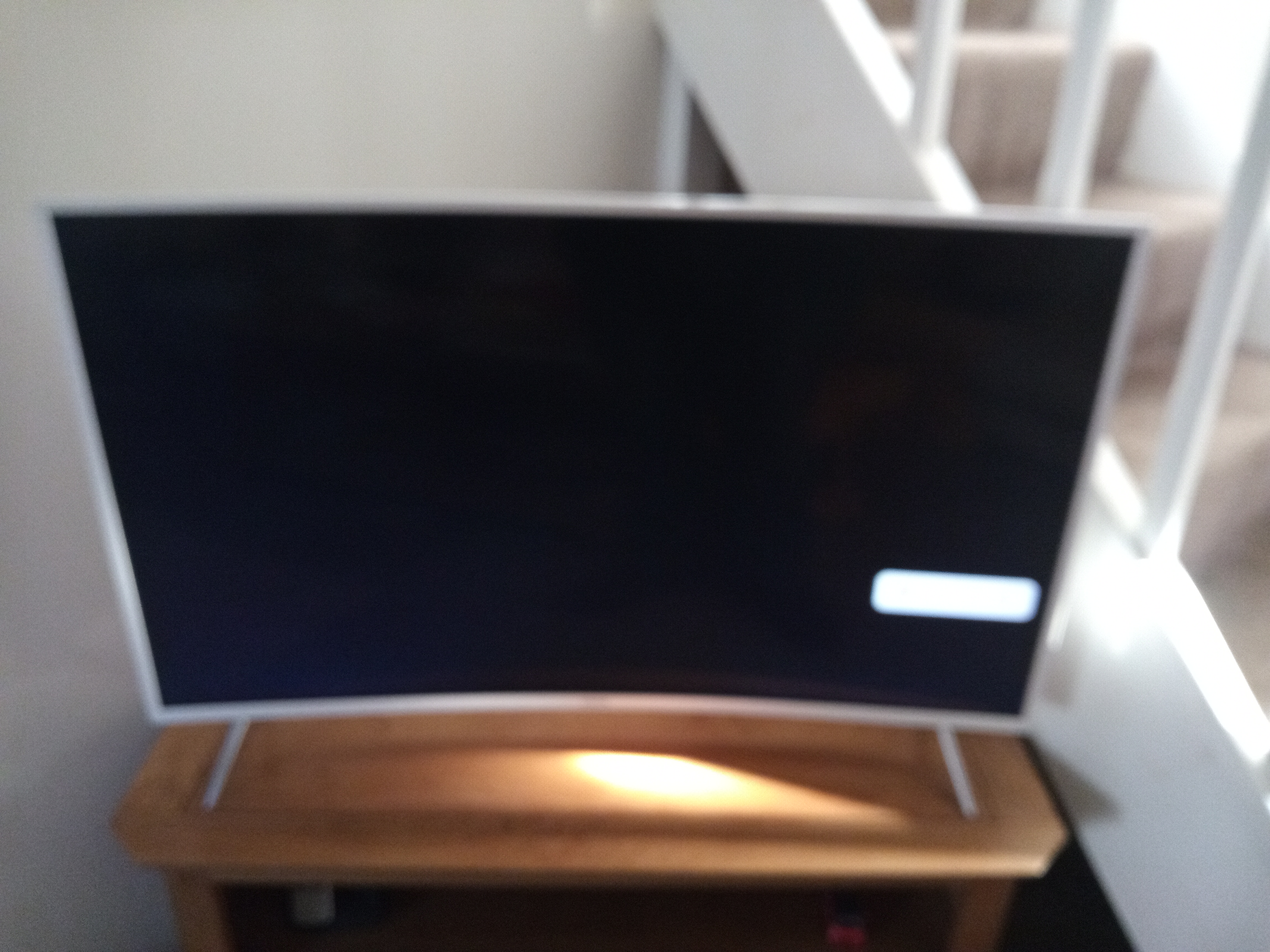

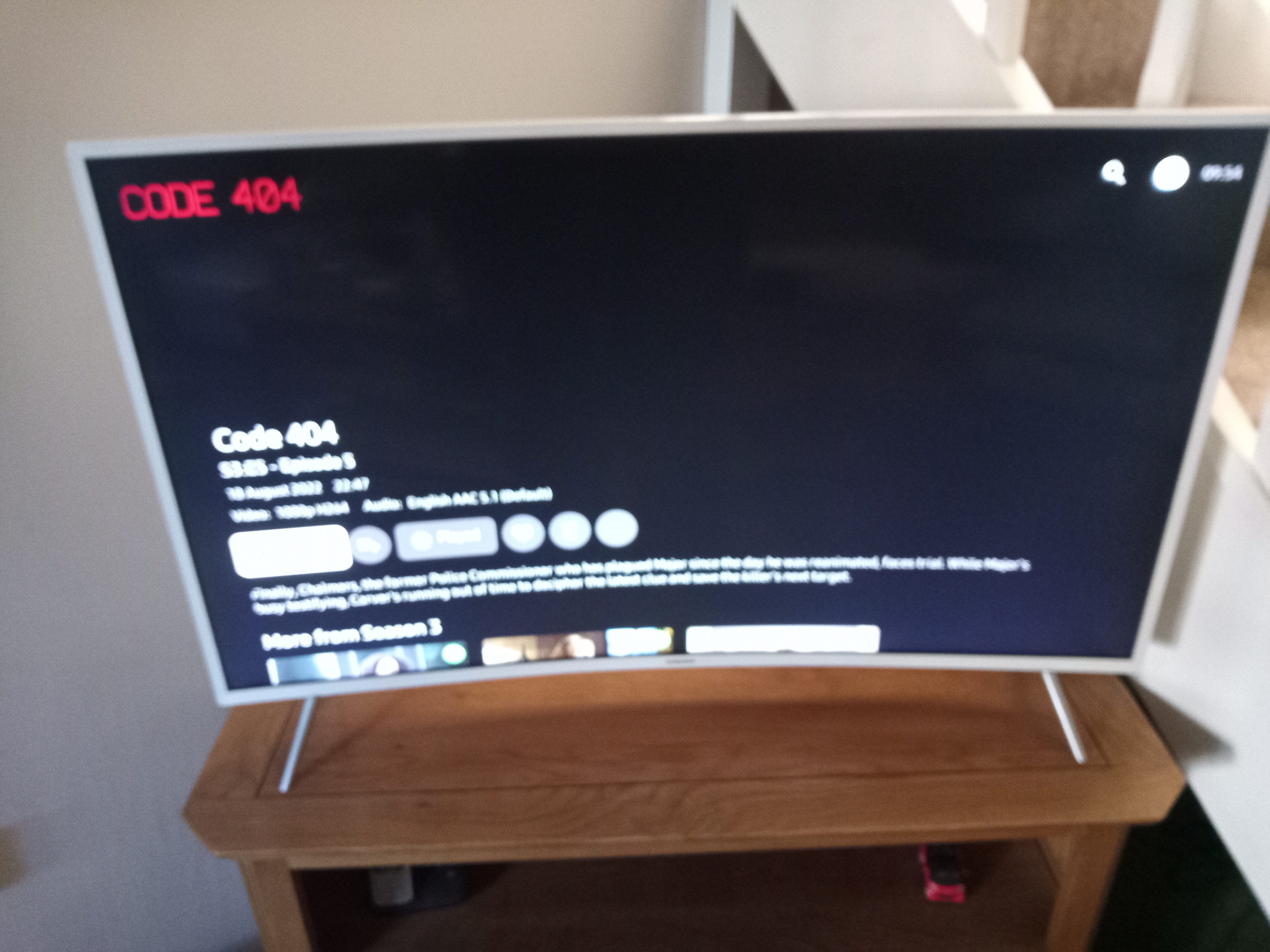

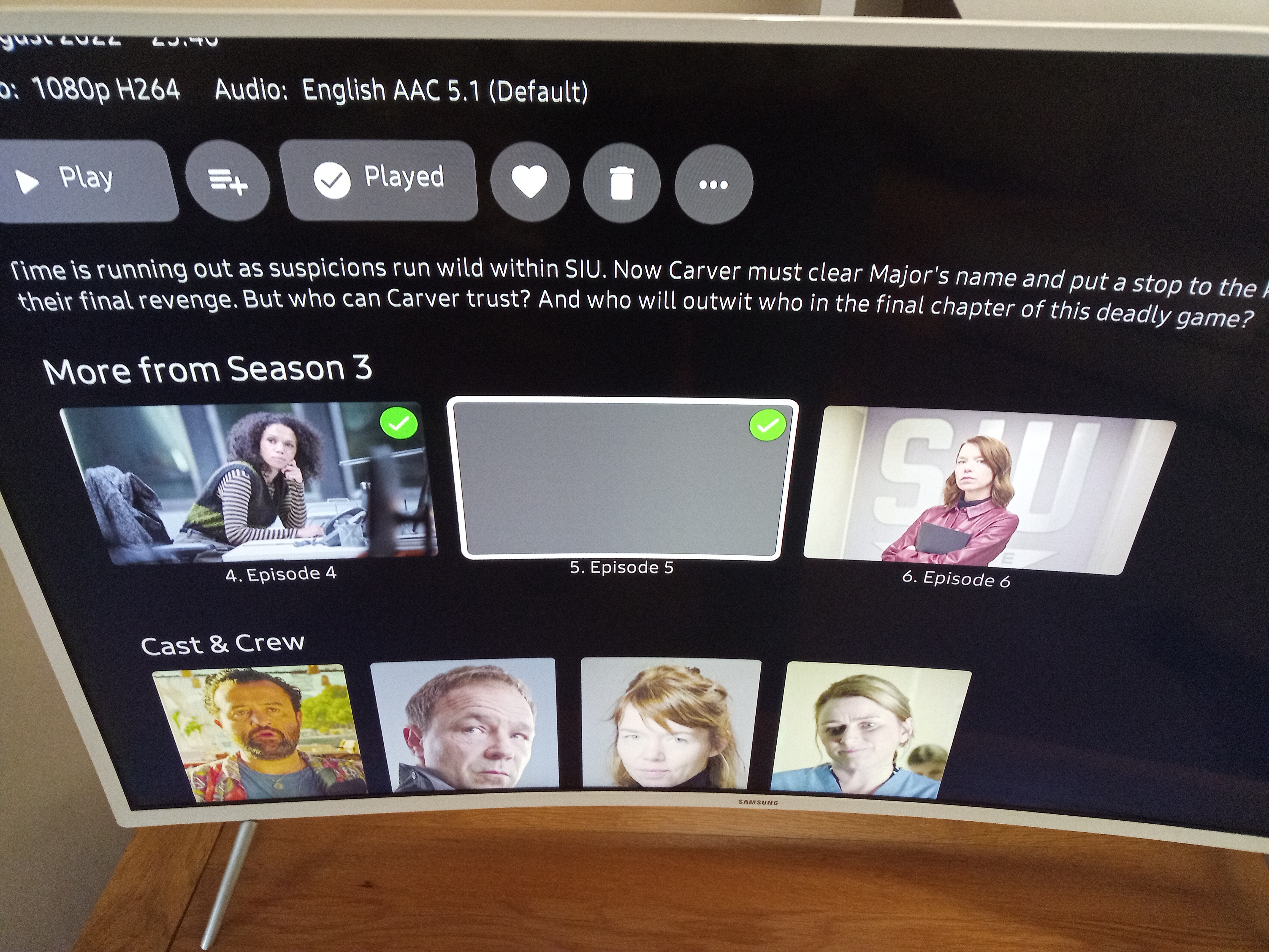

Dickydodah! 154 Posted September 21, 2022 Posted September 21, 2022 @FrostByte I get the same issue on both 2016 K-series and the 2017 M series now. I have done some more testing and there is some more strange behavior that is probably all related. When the episode ends I get a black screen with a "play next" button as I have autoplay off. Is this the expected behaviour as I believe others have mentioned a description of the next episode comes up? Sorry about the blurry pics the autofocus was having quite an issue Then If I press back the Logo and time appear at the top of the screen. Then another back button press gives me this. However the backdrop does flash as the theme colour, not the backdrop picture for less than a second before going black I also get this syptom where the thumbnails disapear once played. (autofocus worked on this one )
