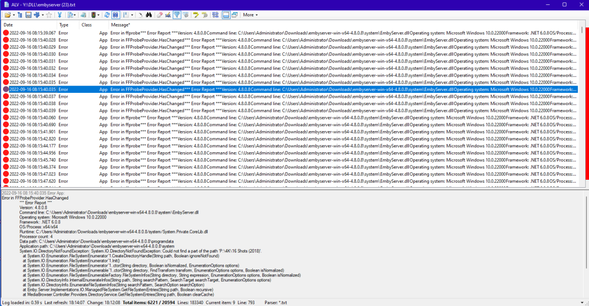

rbjtech 5345 Posted September 16, 2022 Posted September 16, 2022 5 hours ago, popeye246810 said: logs embyserver.txt 15.37 MB · 2 downloads .. of the 20K lines in the log, 6.2K of them are file errors trying to retrieve the file. So I think you need to fix your mounts first to get reliable file access and then try again. If Plex/JF use the same mounts without issue - then over to the Dev's why this would be .. 1
popeye246810 4 Posted September 16, 2022 Author Posted September 16, 2022 Both Plex and Jellyfin are fine with the mounts exactly like this, it's only ever an issue with Emby

jad3675 26 Posted September 29, 2022 Posted September 29, 2022 (edited) It's slow because it can't access the file path - it's nothing inherent with emby. Start by double-checking the file permissions for the user that emby is running as.... System.IO.DirectoryNotFoundException: System.IO.DirectoryNotFoundException: Could not find a part of the path 'P:\4K\Flash Gordon (1980)' As a test, you could use the '--allow-other' flag on the rclone mount command - that should allow users other than the user running the rclone mount to access the files. Nevermind that - '--allow-other' doesn't work on windows. You need to run the rclone mount as 'system user', if you're not already doing that. Edited September 29, 2022 by jad3675
