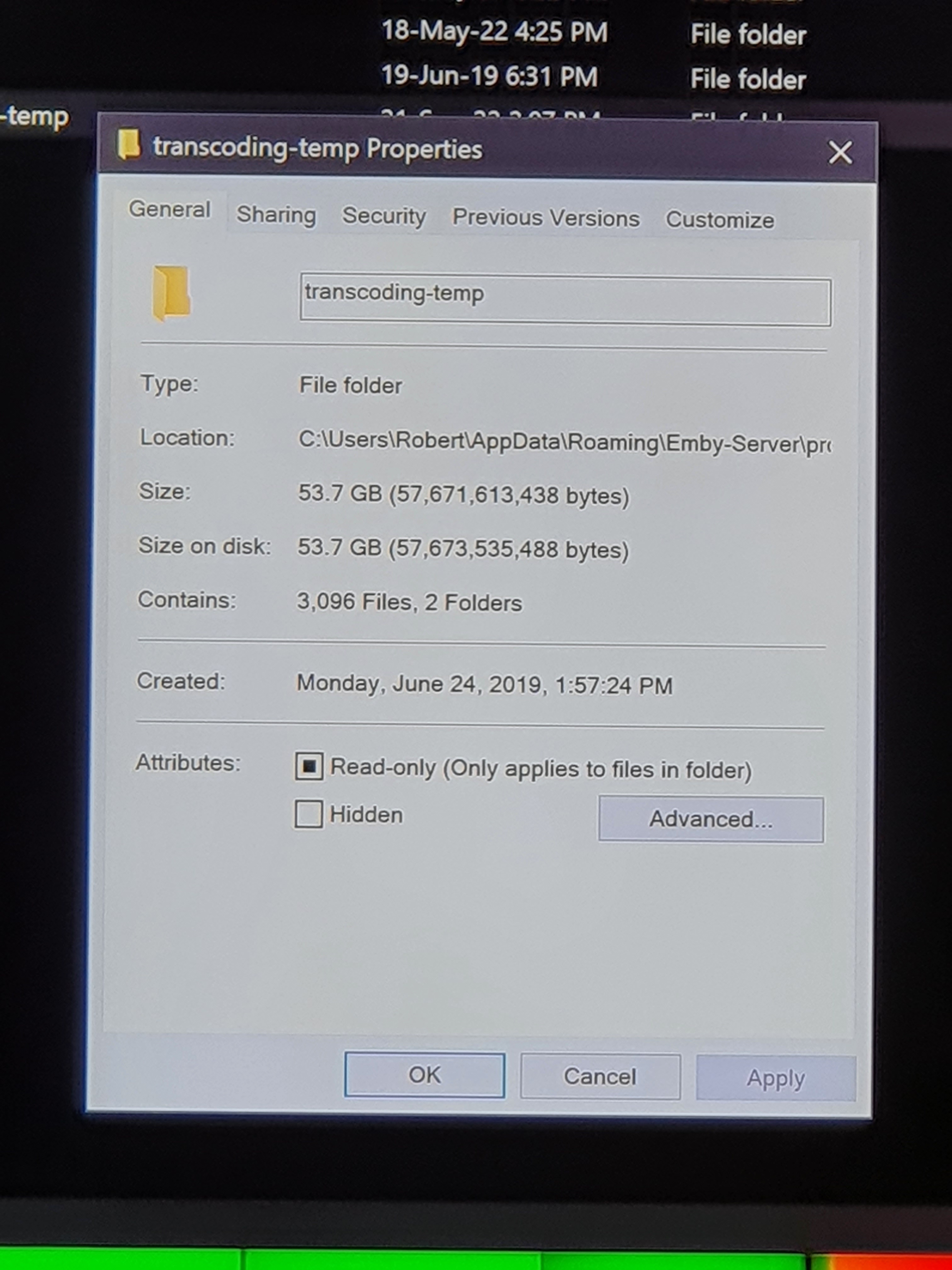

mystic.bertie 23 Posted September 19, 2022 Author Posted September 19, 2022 Guys my transcoding-temp folder has filled up again. My hard drive is only 250gb on my server pc and the Emby tv app stopped working because my hard drive became full. Does anyone know why Emby server is doing this, i have been using Emby server and Theatre for many years and i have never had this problem. Its only recently i started using the tv app all the time. I also have this ongoing problem with my movies freezing and having to close the app. Can these 2 issues be related?
Luke 42241 Posted September 19, 2022 Posted September 19, 2022 4 hours ago, mystic.bertie said: Guys my transcoding-temp folder has filled up again. My hard drive is only 250gb on my server pc and the Emby tv app stopped working because my hard drive became full. Does anyone know why Emby server is doing this, i have been using Emby server and Theatre for many years and i have never had this problem. Its only recently i started using the tv app all the time. I also have this ongoing problem with my movies freezing and having to close the app. Can these 2 issues be related? Hi, can we please look at an example? Thanks. 1

mystic.bertie 23 Posted September 29, 2022 Author Posted September 29, 2022 I did not want to post this but im still stuck at figuring out why my movies are freezing and my trancoding-temp folder is not clearing out of data. Luke asked me for an example of what was happening, i went to the trouble of gathering information, taking pics, video and noting times and events as the problems with occurring, i posted logs more than once. Can i politely ask that i get further help on this issue?
