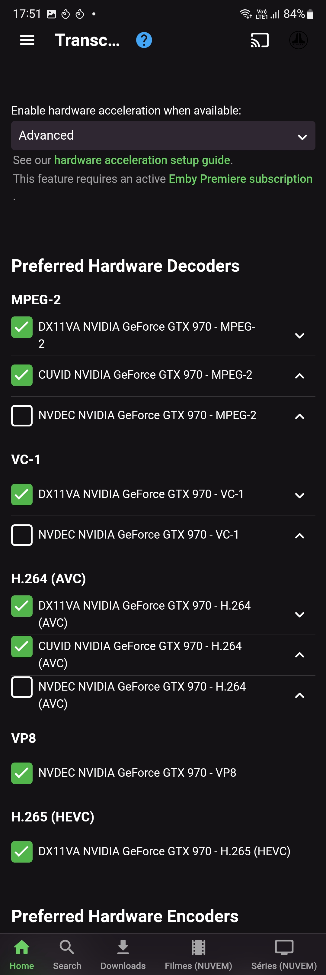

softworkz 5133 Posted September 15, 2022 Posted September 15, 2022 @Rolivaras - The problem is that your GPU is very old. It doesn't even support HEVC decoding. That's why decoding is done by CPU and later, the uncompressed frames are uploaded to the hardware - which takes time. There's one playback with tone mapping which is above 1.0x speed, because it's scaled down to 640x360, but the other log shows an attempt to perform tone mapping on the full 4k video and that's just too much. For the colors, you can try different tone mapping settings by installing the Diagnostics Plugin, going to "Advanced Transcoding" and then switch to the "Tone Mapping" tab. Hope this helps, sw

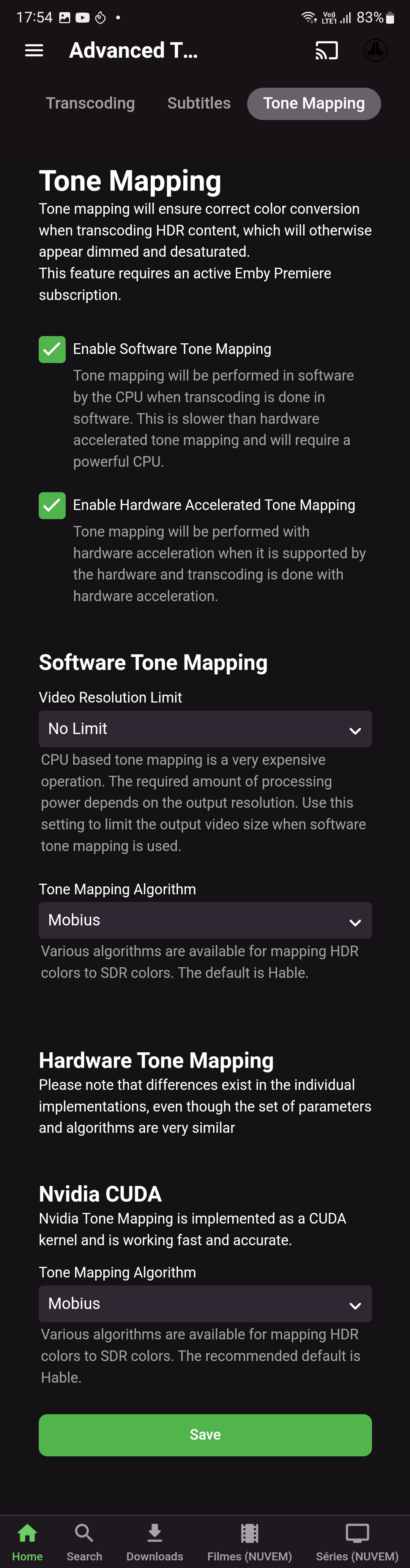

Rolivaras 2 Posted September 23, 2022 Author Posted September 23, 2022 Okay, I changed the tone mapping algorithms, but it made no difference.

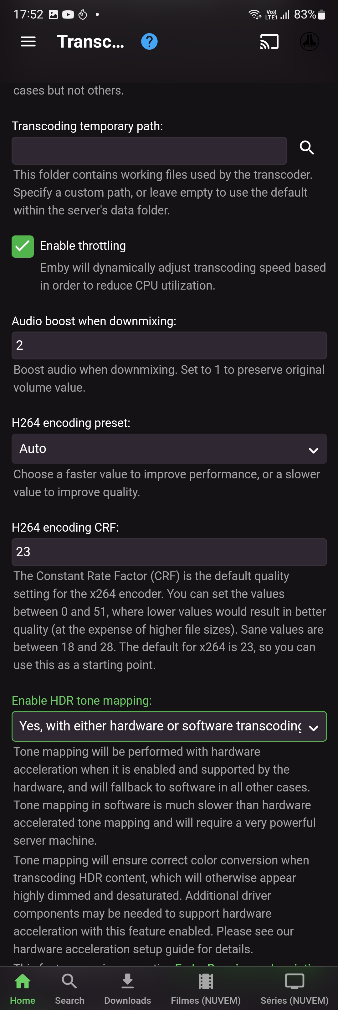

Happy2Play 9811 Posted October 10, 2022 Posted October 10, 2022 @Rolivaras Both these logs show Tone Mapping is disabled. Info Tone Mapping would be desired, but the algorithm is set to 'None' What is your Tone Mapping setting on Transcode menu?

softworkz 5133 Posted October 12, 2022 Posted October 12, 2022 Hm, that looks good. I even placed it locally into my config and it's working fine. Does tone mapping work if you disable HW acceleration? (make sure to choose a low quality in the client like 480p or something, so it's not running too slow.)
Rolivaras 2 Posted October 12, 2022 Author Posted October 12, 2022 (edited) 1 hora atrás, softworkz disse: Hum, isso parece bom. Eu até localmente na minha configuração e está funcionando bem. O mapeamento de toneladas de funções se você tornar um HW? (certifique-se de escolher uma qualidade baixa no cliente como 480p ou algo assim, para que não fique lento.) I put it to play without hardware acceleration, but with tone mapping, it didn't have the greenish screen like before the premium subscription, but it still has a whitish tone. embyserver.txt ffmpeg-transcode-bc39c9dc-4d54-4785-a6ea-681dfc6cea70_1.txt ffmpeg-transcode-86e21794-44d0-4a91-8177-14780add2e9b_1.txt Edited October 12, 2022 by Rolivaras

Rolivaras 2 Posted December 29, 2022 Author Posted December 29, 2022 17 minutes ago, Luke said: @Rolivaras are you still having an issue with this? No, I installed a GPU that supports HVEC. But I still have a problem here: 1
