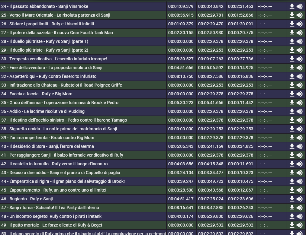

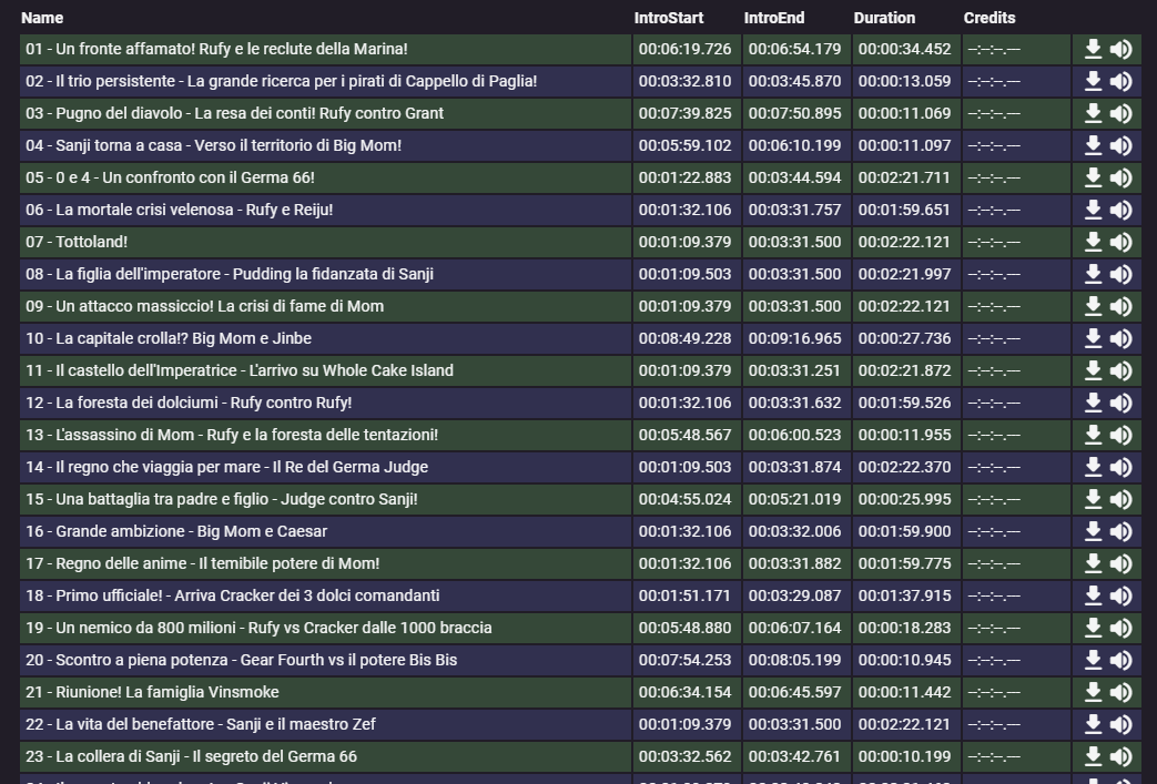

Bazzu85 22 Posted September 8, 2022 Author Posted September 8, 2022 Here's the specific case.. This episode, after the full metadata refresh and intro scheduled task gives this: 022-09-08 12:04:06.238 Info App: Detecting markers for I:\00 - Online Media\Anime\One Piece (1999)\Stagione 19 [720p x264] [JAPANESE] - episode I:\00 - Online Media\Anime\One Piece (1999)\Stagione 19 [720p x264] [JAPANESE]\One Piece (1999) - S19E03 - 782 - Pugno del diavolo - La resa dei conti! Rufy contro Grant [WEBDL 720p x264] [JAPANESE].mkv 2022-09-08 12:04:06.357 Info App: I:\00 - Online Media\Anime\One Piece (1999)\Stagione 19 [720p x264] [JAPANESE] has 98 episodes with audio fingerprints available 2022-09-08 12:04:09.146 Debug Server: http/1.1 GET http://localhost:8096/emby/System/Logs/embyserver-1.txt?Sanitize=true. UserAgent: Mozilla/5.0 (Windows NT 10.0; Win64; x64) AppleWebKit/537.36 (KHTML, like Gecko) Chrome/104.0.0.0 Safari/537.36 2022-09-08 12:04:09.169 Debug Server: http/1.1 Response 200 to ::1. Time: 23ms. http://localhost:8096/emby/System/Logs/embyserver-1.txt?Sanitize=true 2022-09-08 12:04:20.694 Info App: Best title sequence for I:\00 - Online Media\Anime\One Piece (1999)\Stagione 19 [720p x264] [JAPANESE]\One Piece (1999) - S19E03 - 782 - Pugno del diavolo - La resa dei conti! Rufy contro Grant [WEBDL 720p x264] [JAPANESE].mkv is 00:07:39.8258706 - 00:07:50.8955223. Confidence: 1 Here's a screen of the wrong timing: As you see this IS NOT an INTRO but I think that the mess is caused by the other episodes markers.. Now I try to refresh the metadata for the entire season and recalculate the intros..

Bazzu85 22 Posted September 8, 2022 Author Posted September 8, 2022 (edited) 25 minutes ago, ebr said: Hi. If you get the same result, check out the ChapterAPI plug-in. Hi, I have the same (wrong) result. Thx for the tip and here's the ChapterApi result: Downloading both the files gives this: 20220908.zip Are there some problems? Edit: I tried to manually delete the chapters and they are calculated the same every time.. Edited September 8, 2022 by Bazzu85
rbjtech 5345 Posted September 8, 2022 Posted September 8, 2022 If emby is not automatically picking them up -(and a repeated intro happens within the first 10 minutes) then it's likely they cannot be easily identified. Some Anime is extremely difficult to detect... Use the Chapter API Plugin to modify the contents - remove the IntroStart and IntroEnd and add it manually I'm afraid.
Bazzu85 22 Posted September 10, 2022 Author Posted September 10, 2022 On 08/09/2022 at 22:27, rbjtech said: If emby is not automatically picking them up -(and a repeated intro happens within the first 10 minutes) then it's likely they cannot be easily identified. Some Anime is extremely difficult to detect... Use the Chapter API Plugin to modify the contents - remove the IntroStart and IntroEnd and add it manually I'm afraid. I know that the anime episode can be a problem but the problematic episodes I checked and have at the beginning the intro with the same music as the other episodes of the season. But the intro detection is wrong for the majority As you see for example episodes from 36 to 39 have the correct intro from 0.00 to 2.29. Checking the file episode 35 is the same. but is not correctly recognized..
rbjtech 5345 Posted September 10, 2022 Posted September 10, 2022 3 hours ago, Bazzu85 said: I know that the anime episode can be a problem but the problematic episodes I checked and have at the beginning the intro with the same music as the other episodes of the season. But the intro detection is wrong for the majority As you see for example episodes from 36 to 39 have the correct intro from 0.00 to 2.29. Checking the file episode 35 is the same. but is not correctly recognized.. The issue is what 'you' think is the same, is not considered the same by the detection algorithm. The issue is the 'source' may be different or they may have actually changed a minor detail which is inaudible (to you) - but it will throw the detection. Ep35 in your example 'may' have started lets say 0.5 sec into the episode - but that 0.5 sec of intro 'missing' means it's not the same as ep's 36-39. Detection is not an exact science - if they are one off's - manually change them - if it's lots of issues, then maybe try re-ripping the source etc to ensure they are all alike. There is no easy solution for this I'm afraid, there is nothing emby (or the chromaprint technology) can do about this I'm afraid with the current implementation. -- You 'may' want to look at TeamB's chapter plugin as it has an alternative detection method that still uses chromaprint - but YOU specify the Intro segment it looks for. Support from this is from @TeamB but I can vouch that's it's very impressive/accurate and very fast - but I have not used it for Anime - so your results may vary.
Bazzu85 22 Posted September 10, 2022 Author Posted September 10, 2022 38 minutes ago, rbjtech said: The issue is what 'you' think is the same, is not considered the same by the detection algorithm. The issue is the 'source' may be different or they may have actually changed a minor detail which is inaudible (to you) - but it will throw the detection. Ep35 in your example 'may' have started lets say 0.5 sec into the episode - but that 0.5 sec of intro 'missing' means it's not the same as ep's 36-39. Detection is not an exact science - if they are one off's - manually change them - if it's lots of issues, then maybe try re-ripping the source etc to ensure they are all alike. There is no easy solution for this I'm afraid, there is nothing emby (or the chromaprint technology) can do about this I'm afraid with the current implementation. -- You 'may' want to look at TeamB's chapter plugin as it has an alternative detection method that still uses chromaprint - but YOU specify the Intro segment it looks for. Support from this is from @TeamB but I can vouch that's it's very impressive/accurate and very fast - but I have not used it for Anime - so your results may vary. thx for you very detailed answer @rbjtech! the issue I see for the moment is only for this one piece episodes! I'll give a look at the other plugin! ty!
