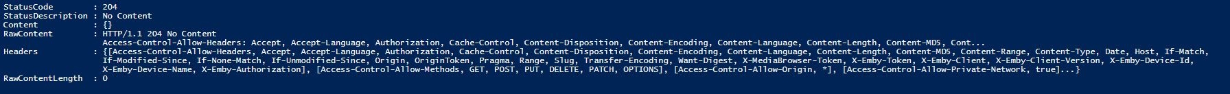

Error comes at the last line so something should be wrong with $mu1 but can't figure out my mistake:
StatusCode: 204
StatusDescription: No Content
StatusCode: 204
And you think that's an error because?
StatusCode: 204
204 is a success response. All 2xx responses are.
