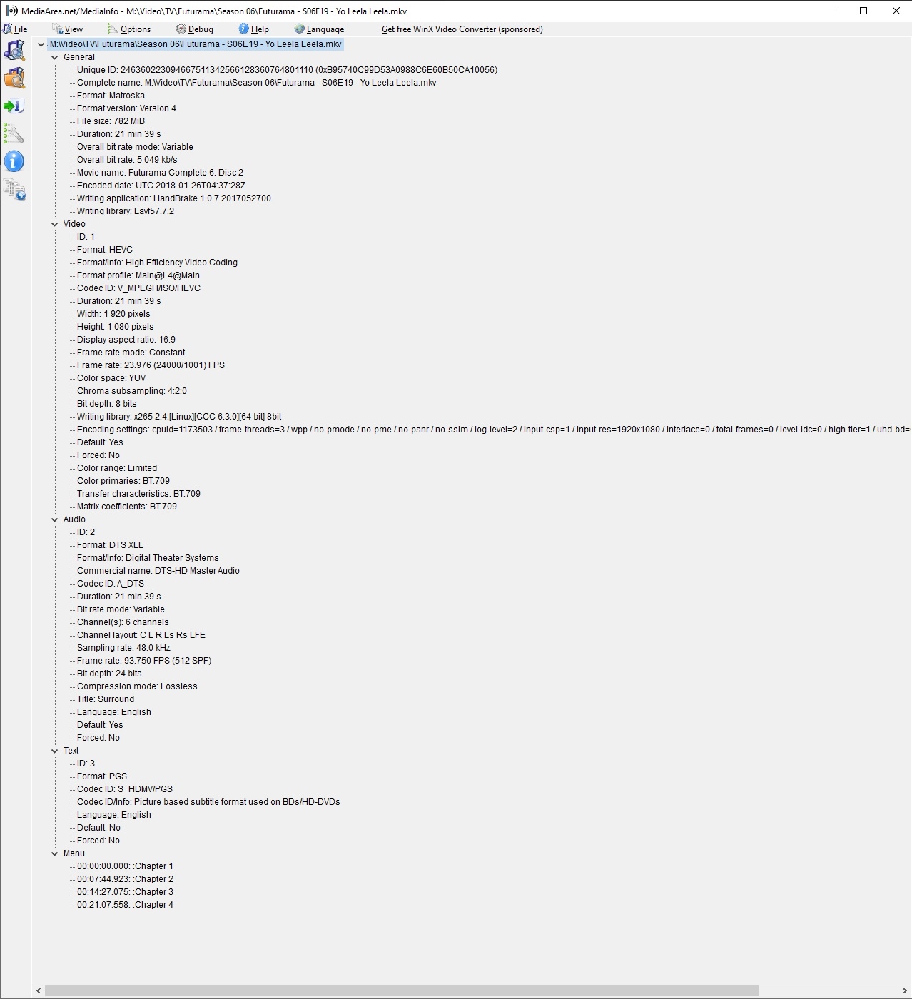

rotational467 44 Posted September 3, 2022 Posted September 3, 2022 (edited) Hi there, Posting this under the server section although I haven't ruled out the Roku client yet, and this may be an issue with the media files. Server is Emby 4.7.6.0 on Ubuntu 20.04.5 LTS w/HWE. Hardware enc/dec enabled for Intel 630 GPU, latest Intel non-free drivers installed I have a number of series ripped from BR with PGS subs intact. I understand that PGS are not optimal but for various boring reasons I prefer them, and normally they do not cause any issues in my setup. However last night I ran across a set of files that repeatedly failed to transcode when streaming to Roku when subs were enabled. This is extremely unusual as my wife's user account has subs always enabled, and most of my media has PGS subs. Failing: Futurama Season 6 (I tried multiple episodes, the "test" episode is S06E19). The intro (no subs) plays normally, and then just prior to the first frame with subs, playback stalls, and transcoding attempts to start/reset and stalls at 65%. Eventually Emby gives up and moves to the next episode and the behavior repeats. Working: Battlestar Galactica 2003 Season 1 (test episode S01E06). Transcode starts quickly and normally, no issues with subs. Noticed in the various logs when failing: Futurama (no dimensions/resolution listed for PGS): >>>>>> Subtitle Processing Steps for [0:2]: HDMV PGS subtitles Step Format Target Size HDMV_PGS_SUBTITLE >> Subs: Bitmap scale >> Video: UNKNOWN 1920x1080 BSG (PGS has normal 1080p dimensions): >>>>>> Subtitle Processing Steps for [0:2]: HDMV PGS subtitles Step Format Target Size HDMV_PGS_SUBTITLE >> Subs: Bitmap 1920x1080 scale >> Video: UNKNOWN 1916x-2 ffmpeg log error for Futurama: "Impossible to convert between the formats supported by the filter 'hwupload@f4' and the filter 'auto_scale_0'" There appears to be something up with either the Futurama subs or ffmpeg's ability to probe them, but I'm not sure what or how to address it. I ripped and encoded both of these (and pretty much everything I have with PGS) myself, and these two specific shows were done with the same hardware/software/config within 2-3 weeks of each other. I don't see any meaningful deltas between the two in the files' mediainfos. The Futurama files play w/subs normally in VLC & MPC-BE. Attached are file mediainfos, Emby server hardware detection, server logs, and ffmpeg logs showing both the BSG episode transcoding normally and the Futurama episode failing. Logs were captured after a reboot of the Emby server and Roku client in question. Note that eventually about half the Futurama episode was watched with subs OFF just to make sure it would otherwise play back normally. These were encoded some time ago (2018) and I know that these Futurama episodes have played properly w/subs on MPC/VLC, Kodi (direct), and Plex. I'd like to say definitively that they've worked on Emby previously at some point since I switched from Plex a few months ago, but I'm not 100% sure. Thanks! embyserver.txt ffmpeg-transcode-11fcb050-57c2-43b3-8950-14dee06bcc3d_1.txt ffmpeg-transcode-c05f620b-fbe2-449b-8be8-e0eb6aec4955_1.txt hardware_detection-63797741391.txt Edited September 3, 2022 by rotational467

rotational467 44 Posted September 4, 2022 Author Posted September 4, 2022 QuickSync moved to top for all transcode types. Server and Roku restarted after change and before testing. @softworkz Futurama: Same failure to play subs. Eventually falls back to software (which works). Quicksync seemed to have a lot of trouble with the file, buffering multiple times during the intro before dying completely at the first subtitles. BSG: Played normally and subs worked. Both: Corrupted video for first ~ 5 seconds of playback, bad aliasing during fast camera pans/high speed motion. Remember the same kind of thing trying out QS with Plex in the before-time so I don't think that's anything out of the ordinary, at least on the 8700K. It seems that there must be some kind of defect in the Futurama files, and I'd rather just dig out the discs and re-rip them than end up neck deep in a rabbit hole if the answer isn't apparent. AFAIK everything else x265/PGS that I have, Emby streams to all of my clients/platforms with zero issues using VAAPI when xcoding is needed. The Emby logs from these tests are attached in case you could get something useful...I can't see any difference in the files' metadata in either MediaInfo or mkvToolnix. ffmpeg...6787_1 - First playback attempt of Futurama ffmpeg...52fc_1 - Last playback attempt with QS HW xcoding ffmpeg...d0f0_1 - Fallback to software xcoding playback ffmpeg...7c98_1 - Playback of BSG with QS HW xcoding Thanks again! embyserver.txt ffmpeg-transcode-9c4b0e1a-93c1-473b-8ac9-211ae0bc6787_1.txt ffmpeg-transcode-683b710f-1706-4085-a20f-430cc393d0f0_1.txt ffmpeg-transcode-b9eb28db-acb4-4e6f-84e4-b72b47237c98_1.txt ffmpeg-transcode-bd03749d-5754-4165-8efe-15f5bd3552fc_1.txt hardware_detection-63797900532.txt

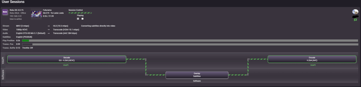

rotational467 44 Posted February 22, 2023 Author Posted February 22, 2023 (edited) @Luke I'm afraid it's still happening with server 4.7.11 and Roku client 4.0.75. Same media file I originally used to report this and same behavior as previously. Was able to see the transcode fail and restart multiple times on the user sessions panel (can't grab logs right now). Screenshot attached while it was mid-fail/recovering. edit: was able to grab the ffmpeg log, attached. ffmpeg-transcode-585a5720-b84f-4ad5-b4c9-9571232c52cd_1.txt Edited February 22, 2023 by rotational467 added log
Luke 42245 Posted February 22, 2023 Posted February 22, 2023 5 hours ago, rotational467 said: @Luke I'm afraid it's still happening with server 4.7.11 and Roku client 4.0.75. Same media file I originally used to report this and same behavior as previously. Was able to see the transcode fail and restart multiple times on the user sessions panel (can't grab logs right now). Screenshot attached while it was mid-fail/recovering. edit: was able to grab the ffmpeg log, attached. ffmpeg-transcode-585a5720-b84f-4ad5-b4c9-9571232c52cd_1.txt 23.67 kB · 1 download Hi, please attach the main emby server log as well. thanks.
