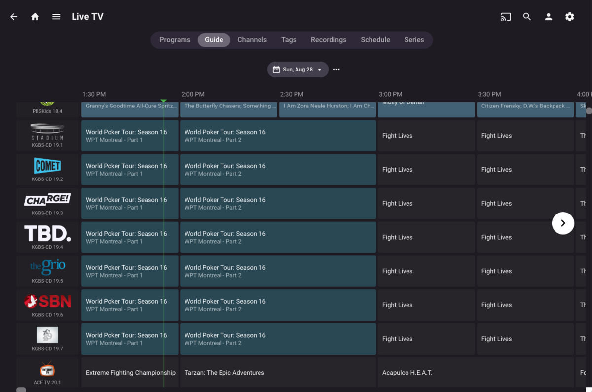

jbirmingham40 9 Posted August 28, 2022 Posted August 28, 2022 Starting a month or two back, I started noticing that Emby is showing the exact same guide data for all my 19.x HDHomeRun channels. The other HDHomeRun channels are just fine. Below is an image showing this. The second image shows what I see on the HDHomeRun admin page. It isn't doing it for any other channels which is why I suspect this is the cause. I suspect that this might be caused by the fact that HDHomeRun is showing the same channel name for all of these channels. Interestingly, however, you can see that Emby knows they are not all the same channel since it is showing the correct logos for them below. Not sure if there is anything that can be done on the Emby side but figured I would ask. I tried already rescanning the channels in HDHomeRun, I tried removing and reading the tuner, manually forcing a refresh of the guide data, as well as installing the latest HDHomeRun firmware. I am running emby version 4.8.0.7 beta on CentoOS 8. My logs are attached. embyserver.txt.gz
Luke 42245 Posted August 28, 2022 Posted August 28, 2022 Hi, have you checked the channel mapping in live TV setup to see what guide data they're mapped to?
jbirmingham40 9 Posted August 29, 2022 Author Posted August 29, 2022 Weird. That was the issue. Somehow they got mapped to the same channel. Remapping them fixed the issue. Thanks. 1
