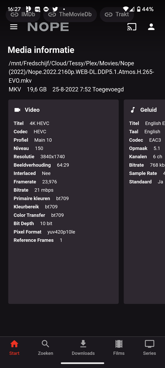

VictorPeeters 3 Posted August 24, 2022 Posted August 24, 2022 Some files don't play without transcoding on my Android TV (Bravia). The same files do however play on VLC. I sent a log from the app at 3:10/3:11 eastern time from the user profile 'Tessy'. I also included server logs. Why is transcoding triggered? The client only says 'Direct Play Error'. embyserver (5).txt

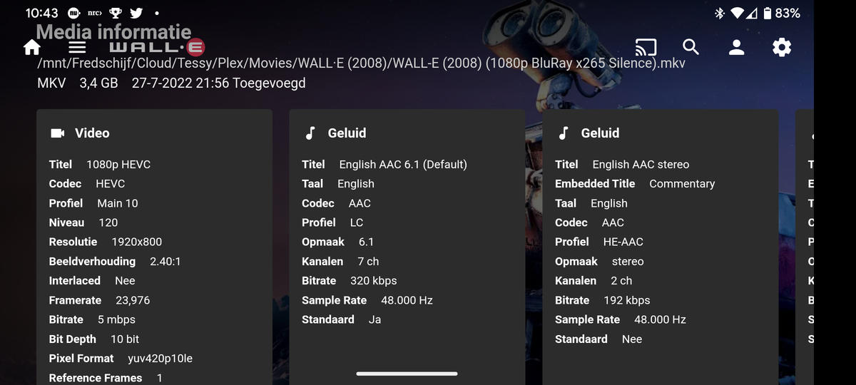

VictorPeeters 3 Posted August 24, 2022 Author Posted August 24, 2022 This is the video file I tried to play. Default android app gives the same behavior.

VictorPeeters 3 Posted August 25, 2022 Author Posted August 25, 2022 Already tried that. It's definitely better, but still doesn't play everything an external player plays. This particular file also doesn't direct play on the app.

VictorPeeters 3 Posted August 26, 2022 Author Posted August 26, 2022 You're right. It happens mostly with 10 bit
VictorPeeters 3 Posted August 26, 2022 Author Posted August 26, 2022 (edited) This one plays fine, however... Edited August 26, 2022 by VictorPeeters
