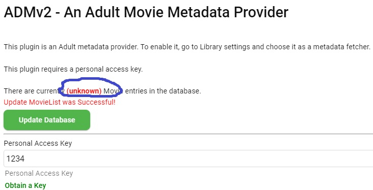

nidielaob 1 Posted September 17, 2023 Posted September 17, 2023 The problem may be here. Unable to download list. Although displayed successfully. but, cache/ADM folder is empty.
mickle026 653 Posted September 17, 2023 Author Posted September 17, 2023 (edited) 7 minutes ago, nidielaob said: The problem may be here. Unable to download list. Although displayed successfully. but, cache/ADM folder is empty. It looks like docker has the same issue as truenas had. Emby loads the DLL, emby owns the process that writes the file but it seems it's not allowed to write it there. I don't know why because it was allowed to create the folder. It's some sort of permission issue. It'll be a read only filesystem for any other process other that emby, which is what appears to be happening. Can you create a folder outside of your jail/ container that has all permissions then mount the adm folder to it? That's a working solution, I think I need to find a better solution though. Edited September 17, 2023 by mickle026
nidielaob 1 Posted September 17, 2023 Posted September 17, 2023 (edited) 27 minutes ago, mickle026 said: It looks like docker has the same issue as truenas had. Emby loads the DLL, emby owns the process that writes the file but it seems it's not allowed to write it there. I don't know why because it was allowed to create the folder. It's some sort of permission issue. It'll be a read only filesystem for any other process other that emby, which is what appears to be happening. Can you create a folder outside of your jail/ container that has all permissions then mount the adm folder to it? That's a working solution, I think I need to find a better solution though. ubuntu deb and windows exe and docker I've tried everything, All the same. Folder already mapped, Not in container. Edited September 17, 2023 by nidielaob

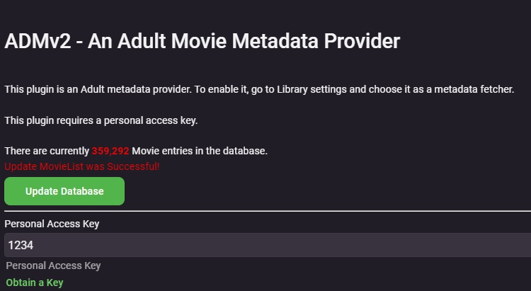

mickle026 653 Posted September 17, 2023 Author Posted September 17, 2023 (edited) try this one. I altered the path builder in the download string , im not sure it'll make a difference but it might do I have also added code to try and get the systems temp folder path and use that if the cache path fails. ADMv2(17-09-2023build3).zip Edited September 17, 2023 by mickle026 update original post to add fallback method in plugin
nidielaob 1 Posted September 17, 2023 Posted September 17, 2023 1 hour ago, mickle026 said: try this one. I altered the path builder in the download string , im not sure it'll make a difference but it might do I have also added code to try and get the systems temp folder path and use that if the cache path fails. ADMv2(17-09-2023build3).zip 52.95 kB · 0 downloads Well done! You're the best! You're a good man! Thank you very much!
mickle026 653 Posted September 18, 2023 Author Posted September 18, 2023 6 hours ago, nidielaob said: Well done! You're the best! You're a good man! Thank you very much! Does it appear to be working correctly now?
nidielaob 1 Posted September 18, 2023 Posted September 18, 2023 28 minutes ago, mickle026 said: Does it appear to be working correctly now? yes working correctly. 1
