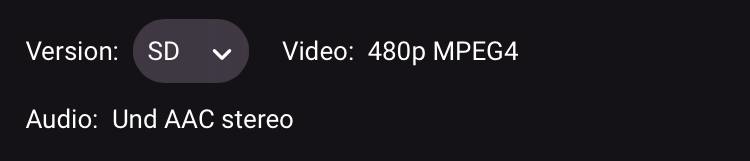

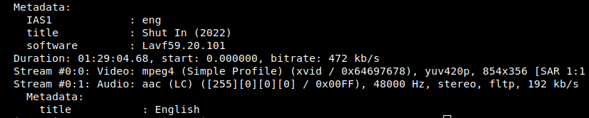

plittlefield 56 Posted August 22, 2022 Posted August 22, 2022 (edited) Is there a way for Emby Server to read the metadata in an AVI video file to show the correct audio Language? In Emby for Roku and iOS it currently shows Audio: Und AAC Stereo instead of 'English AAC Stereo' (shown in first attached image) I appreciate that AVI is "old hat" but I'm hoping to get the devs to make this possible. Attached are some more screenshots of both mplayer and mediainfo to show they can read the metadata correctly for AVI files to show the language 'English'. All my AVIs have been created using ffmpeg and follow the AVI standard for metadata:- ffmpeg -i input.mkv (other options) -metadata:s:a:0 title="English" -metadata IAS1=eng output.avi Thank you! Regards, Paully Edited August 22, 2022 by plittlefield

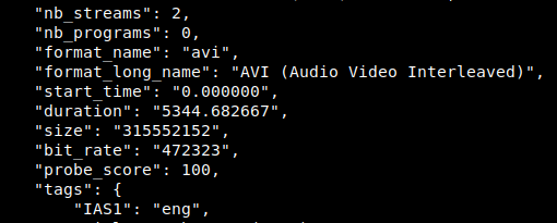

plittlefield 56 Posted August 22, 2022 Author Posted August 22, 2022 (edited) 2 hours ago, rbjtech said: the standard way to set language metadata using ffmpeg is -metadata:s:a:1 language=eng Emby uses ffprobe to get the original attributes - so this is likely a syntax issue ? I think you need to specify the audio track ? Yes, you are correct with your syntax for setting the language with files such as MP4 or MKV format. However, this particular syntax does not work with AVI files. Here is the output of the AVI file using ffprobe ... ...and IAS is the correct metadata option to read the ISO language code from AVI files. IAS1 is the first audio track. IAS2 is the second audio track. etc I think the acronym IAS stands for "International Audio Standard". So, I wonder if the nice devs can make ffprobe in Emby Server read that metadata option like 'mediainfo' or 'mplayer' do? Regards, Paully Edited August 22, 2022 by plittlefield
rbjtech 5335 Posted August 22, 2022 Posted August 22, 2022 (edited) interesting - i would have thought that ffmpeg was generic enough to just pickup this language data - the container shouldn't matter ffprobe.exe -i file:"filename.avi" -threads 0 -v info -print_format json -show_streams -show_chapters -show_format -show_data the above is what emby runs to identify the details - could you run on one of your AVI files ? the info I think it needs is under 'tags' - "language": "eng" note the 'title' is not the language - it is the title of the track. I suspect you do not have a 'language' section - thus you get a 'Und' Maybe post your output here ? if the language metadata is not possible in an AVI container I'd be surprised ... did you try ffmpeg -i input.mkv (other options) -metadata:s:a:1 title="This_is_the_Audio_1_Track_Title" -metadata:s:a:1 language=eng output.avi Edited August 22, 2022 by rbjtech

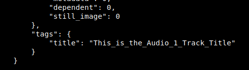

plittlefield 56 Posted August 23, 2022 Author Posted August 23, 2022 (edited) 19 hours ago, rbjtech said: ffprobe.exe -i file:"filename.avi" -threads 0 -v info -print_format json -show_streams -show_chapters -show_format -show_data the above is what emby runs to identify the details - could you run on one of your AVI files ? Yes, no problem. I note there is no specific 'tag' for 'language' in the 'audio' section and the IAS1 metadata entry I mentioned appears NOT in the audio section, like this ... So, I guess that kind of explains why Emby Server is not finding it, but I have to ask why 'mediainfo' reports the audio language correctly?! 19 hours ago, rbjtech said: did you try ... ffmpeg -i input.mkv (other options) -metadata:s:a:1 title="This_is_the_Audio_1_Track_Title" -metadata:s:a:1 language=eng output.avi I will try that now on a new file ... ... and as I suspected, the audio metadata tag for language is completely missing after running that command. and from ffprobe ... So, as I have been saying, you cannot use the standard ffmpeg -metadata:s:a:0 language=eng commands when trying to set the audio language tag on an AVI file. The only way to set it is by using the special IAS tag. This is a limitation of the AVI standard and why technology moved on to MP4 and then MKV containers which are much better at this sort of thing! So, my question still stands ... Can the Emby team please allow ffprobe in Emby Server to use the IAS1 tag to read the 3 letter country ISO code in AVI files? "format": { "filename": "file:movie.avi", "nb_streams": 2, "nb_programs": 0, "format_name": "avi", "format_long_name": "AVI (Audio Video Interleaved)", "start_time": "0.000000", "duration": "5344.682667", "size": "315552152", "bit_rate": "472323", "probe_score": 100, "tags": { "IAS1": "eng", "title": "Movie", "software": "Lavf59.20.101" } } Thank you! Regards, Paully Edited August 23, 2022 by plittlefield

Happy2Play 9800 Posted August 23, 2022 Posted August 23, 2022 (edited) From a little research avi cannot be tagged like other formats as they use RIFF tags. Devs would have to add reading this "IAS1" and mapped to first track. Edited August 23, 2022 by Happy2Play
