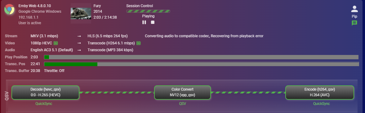

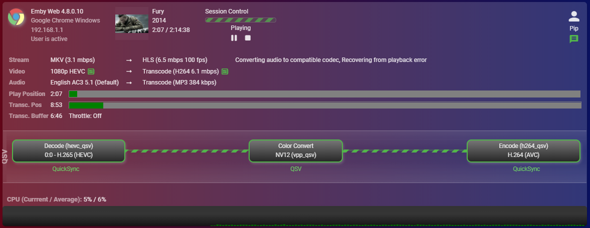

VirulentPip 93 Posted October 2, 2022 Author Posted October 2, 2022 20 hours ago, rbjtech said: If you have the time - it would be interesting doing a direct like for like transcoding comparison (for h265 > h264) of the UHD770 vs A380 - with throttle turned off. Honestly not what I was expecting, the UHD 770 absolutely smashed the A380. Emby bugged out in the 4K with the A380 and was always triggering software not sure why, but the UHD770 with no tone mapping was 190fps. 1
rbjtech 5341 Posted October 2, 2022 Posted October 2, 2022 Hmm - that seems odd. I would have expected the ARC ASICS to at least be on par with the UHD770 for h264/h265. The I/O architecture is however different - ARC will be reading/writing via the PCIe bus, but has 'local' dedicated memory - while the UHD will be reading/writing via an internal bus, but has 'shared' memory. A transcode log might reveal more on where the bottleneck is ? This architecture works for nvenc/nvdec, so it could simply be a very unoptimized driver/ffmpeg combo that is causing the delays - as 100fps on a 1080p transcode is very poor.

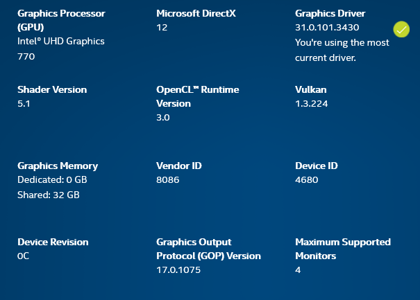

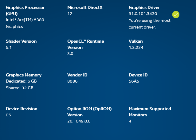

rbjtech 5341 Posted October 2, 2022 Posted October 2, 2022 (edited) Ah that's interesting - I don't even have any D3D9 listed at all on my emby decoders/encoders - only D3D11 (and DX11VA - which are all unselected). I'm wondering if this is a driver issue - did you install and specific ARC drivers or just used the existing drivers ? Edited October 2, 2022 by rbjtech
VirulentPip 93 Posted October 2, 2022 Author Posted October 2, 2022 Seems the latest are installed for both. 1
VirulentPip 93 Posted October 2, 2022 Author Posted October 2, 2022 But to answer more specifically, I grabbed drivers listed for the Arc.. Seems to use the same drivers for the UHD770 as those weren't updated. But yeah, confusing that there's no D3D11 option for the A380.

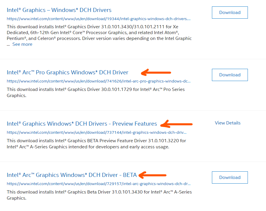

rbjtech 5341 Posted October 2, 2022 Posted October 2, 2022 15 minutes ago, VirulentPip said: But to answer more specifically, I grabbed drivers listed for the Arc.. Seems to use the same drivers for the UHD770 as those weren't updated. But yeah, confusing that there's no D3D11 option for the A380. Fundamentally I think that is the issue here. ARC emulates D3D9 - I'm reading it has no hardware support for it - so that is not helping performance. But until you have a working D3D11 / Quicksync driver for the A370/ffmpeg - then I don't think you can do a 1:1 comparison. Maybe take a look at the BETA drivers ? https://www.intel.com/content/www/us/en/download/737144/intel-graphics-windows-dch-drivers-preview-features.html
VirulentPip 93 Posted October 2, 2022 Author Posted October 2, 2022 3 minutes ago, rbjtech said: Fundamentally I think that is the issue here. ARC emulates D3D9 - I'm reading it has no hardware support for it - so that is not helping performance. But until you have a working D3D11 / Quicksync driver for the A370/ffmpeg - then I don't think you can do a 1:1 comparison. Maybe take a look at the BETA drivers ? https://www.intel.com/content/www/us/en/download/737144/intel-graphics-windows-dch-drivers-preview-features.html Looking at the versions, this is older to the one I have which released only Tuesday (27th)

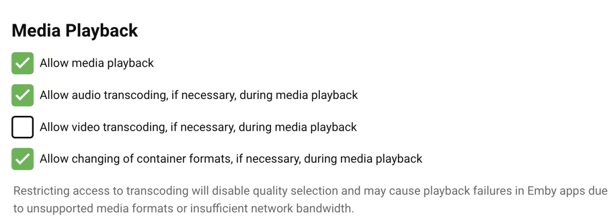

SamES 1084 Posted October 2, 2022 Posted October 2, 2022 4 hours ago, VirulentPip said: embyserver.txt 234.31 kB · 0 downloads @SamES It looks like it's reporting not supported for AV1. For a test, disable video transcoding in the user settings (don't forget to hit save at the bottom). Let me know if that DirectPlays, please attach an ffmpeg log if it doesn't
VirulentPip 93 Posted October 2, 2022 Author Posted October 2, 2022 (edited) Came up with "Playback error No compatible streams are available" Gave 3 logs in quick succession. Fun fact I tried the 4K Max native app (Having to use the Android app for AV1 playback) with this setting and got blank screen with audio so adding in those logs too. 4K Max ffmpeg-directstream-046a0c42-03fb-454e-a27c-8672830dc1c4_1.txt ffmpeg-remux-950b9ce2-bb52-4421-86d9-b15e98c15149_1.txt ffmpeg-directstream-ef9cc1e3-0791-4d73-825c-af8ff467f22e_1.txt ffmpeg-directstream-f97c01f7-b08e-4ee8-bfd6-e2aaa3c0e5f6_1.txt Edited October 2, 2022 by VirulentPip 1
SamES 1084 Posted October 2, 2022 Posted October 2, 2022 5 minutes ago, VirulentPip said: Came up with "Playback error No compatible streams are available" Then the app is correctly reporting that av1 is not supported. This is an LG/app limitation, not an Emby limitation. While rare, it wouldn't be the first time I've seen files play from USB, but not from the app. 1
softworkz 5133 Posted October 2, 2022 Posted October 2, 2022 8 hours ago, VirulentPip said: Looking at the versions, this is older to the one I have which released only Tuesday (27th) Don't go for the version numbers. I would try all of these three packages:
