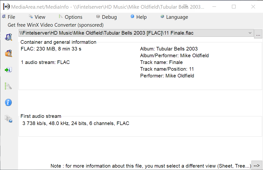

SteveFintel 30 Posted August 25, 2022 Author Posted August 25, 2022 @Luke BTW, here's the media info report on the same file:
Luke 42237 Posted August 25, 2022 Posted August 25, 2022 How have you configured audio settings in the app?
