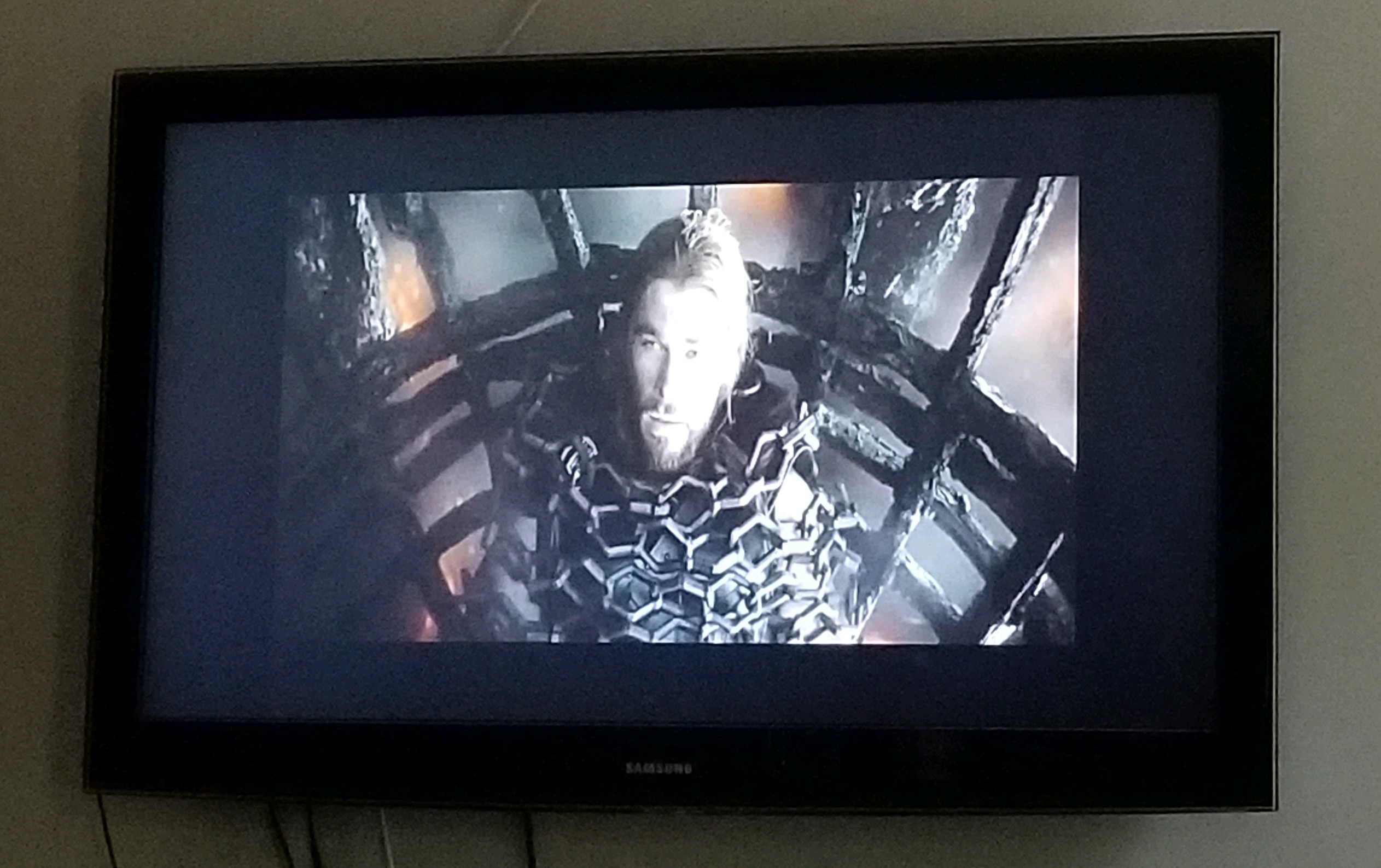

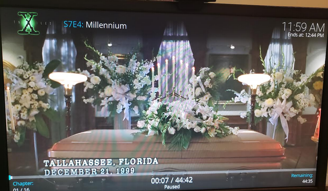

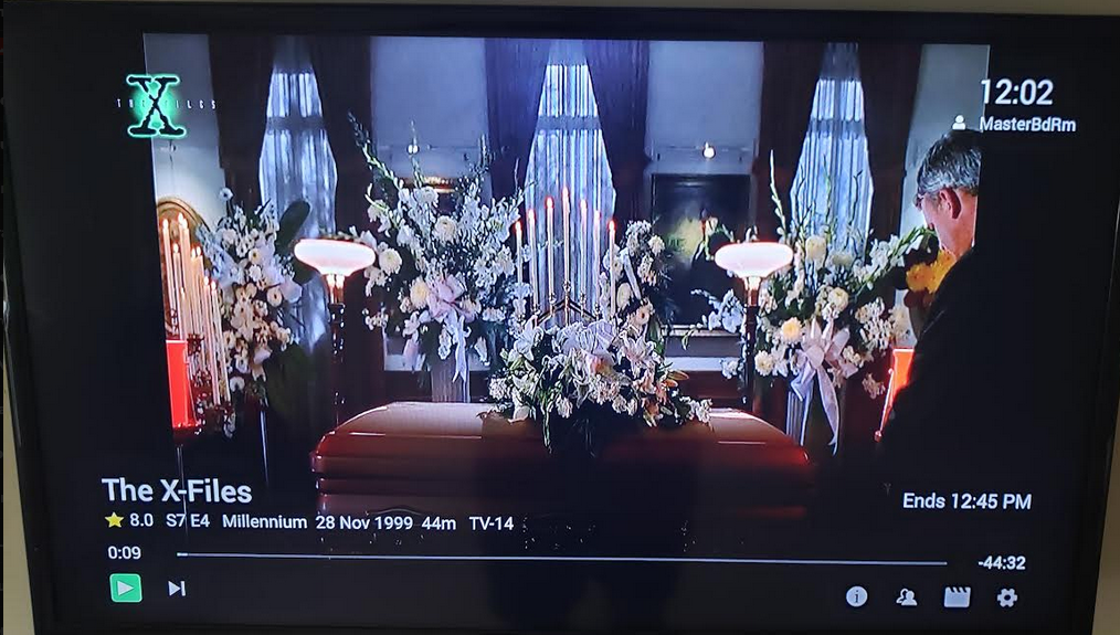

leejohns1972 7 Posted August 20, 2022 Posted August 20, 2022 (edited) Wondering if anyone has started seeing this on their AFTVs within the last couple of months. I have started noticing that AFTV emby client is showing 720p 16:9 content with the wrong aspect ratio (i.e. 4:3). The content used to display correctly. I have not noticed this issue with 1080p content. There is no transcoding when playing these files, but if I try and do playback correction, it fails with the "too many errors" message. These are mp4 files (I have not seen it with other formats that I know of). Andriod, Kodi (EmbyCon), etc. all show the correct aspect ratio so it would appear to be isolated to the AFTV. If no one else is seeing this, I can grab log files etc. to dig into it deeper. Ember server is v4.7.6.0 and AFTV app v2.0.77a info/example below AFTV Emby client display: Kodi (EmbyCon): Edited August 20, 2022 by leejohns1972

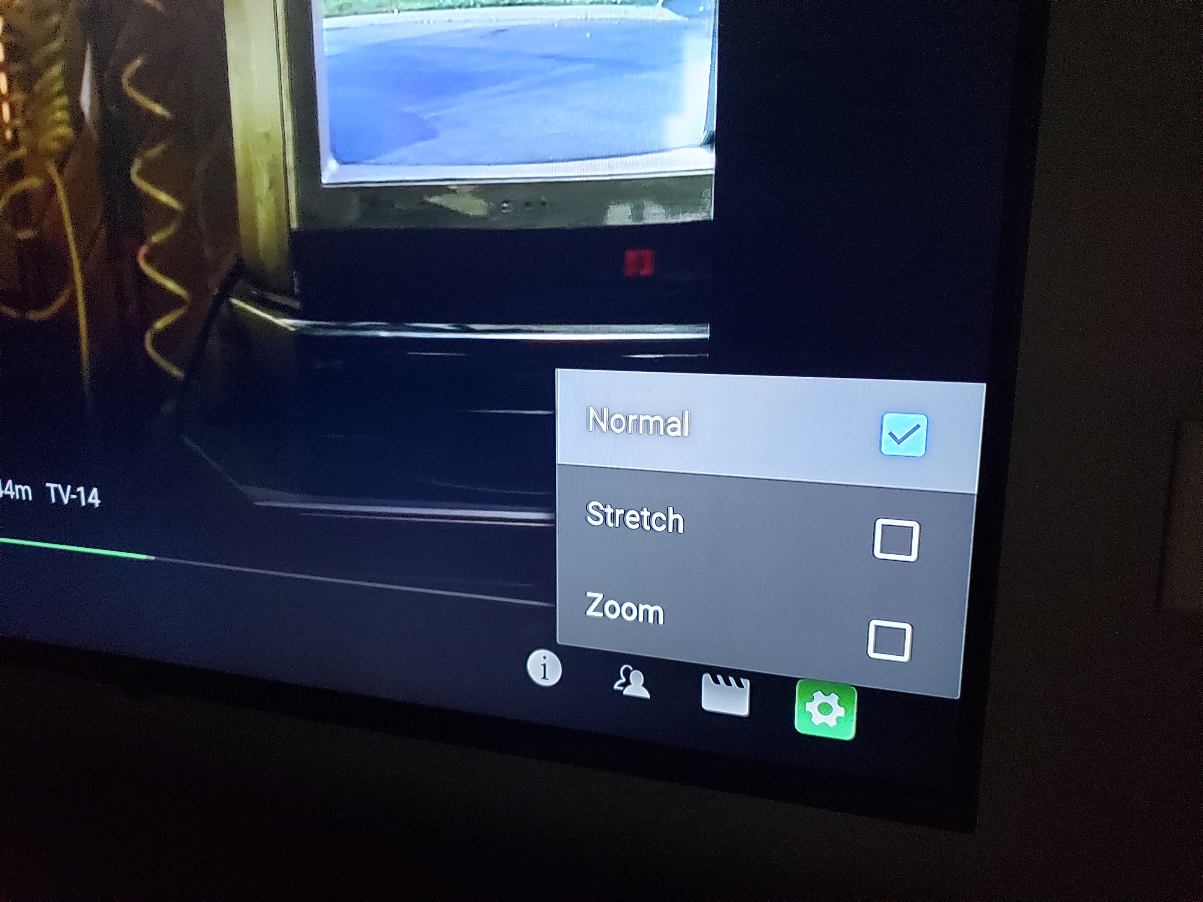

ebr 16337 Posted August 21, 2022 Posted August 21, 2022 Hi. If you go to the "cog" menu and select "Zoom..." what is that set to?
leejohns1972 7 Posted August 21, 2022 Author Posted August 21, 2022 Zoom is set to normal. I see this issue on all 5 of my AFTVs

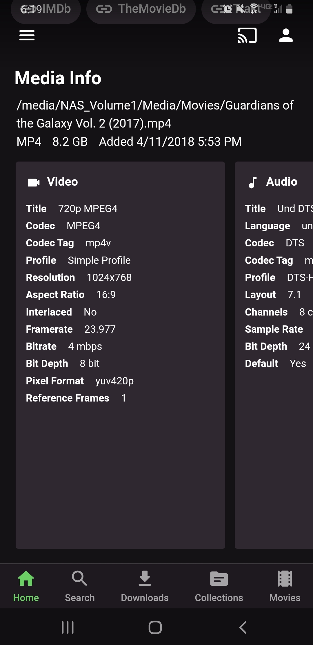

ebr 16337 Posted August 22, 2022 Posted August 22, 2022 I'm going to guess this is related to the encoding of item. Specifically, the pixel aspect ratio perhaps...

ebr 16337 Posted August 25, 2022 Posted August 25, 2022 Your sample is displaying fine for me on my Fire Stick: I do notice, however, that both our thumbnail generator and the Windows one (that shows a thumb in file explorer) think this video is 4:3 so there must be something about it that indicates that. Perhaps it is your TV that is actually causing the distortion...?
leejohns1972 7 Posted August 25, 2022 Author Posted August 25, 2022 (edited) Thanks ebr. That's weird. Anything is possible I suppose. As mentioned, it displays correctly when a different front end client is used on the same AFTV hardware. I have 5 AFTVs and it does it on all five and they are all connected to different model and/or manufacturer TVs. I first noticed it with a movie back in July of this year. All of my AFTVs are the older gen, black square models so perhaps something in a client side update in the past inadvertently caused this to manifest with those files on that hardware? I have seen odd things with them before as they get left behind from a display standpoint. Edited August 25, 2022 by leejohns1972 info edits

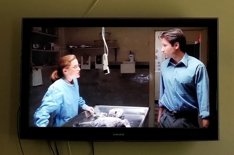

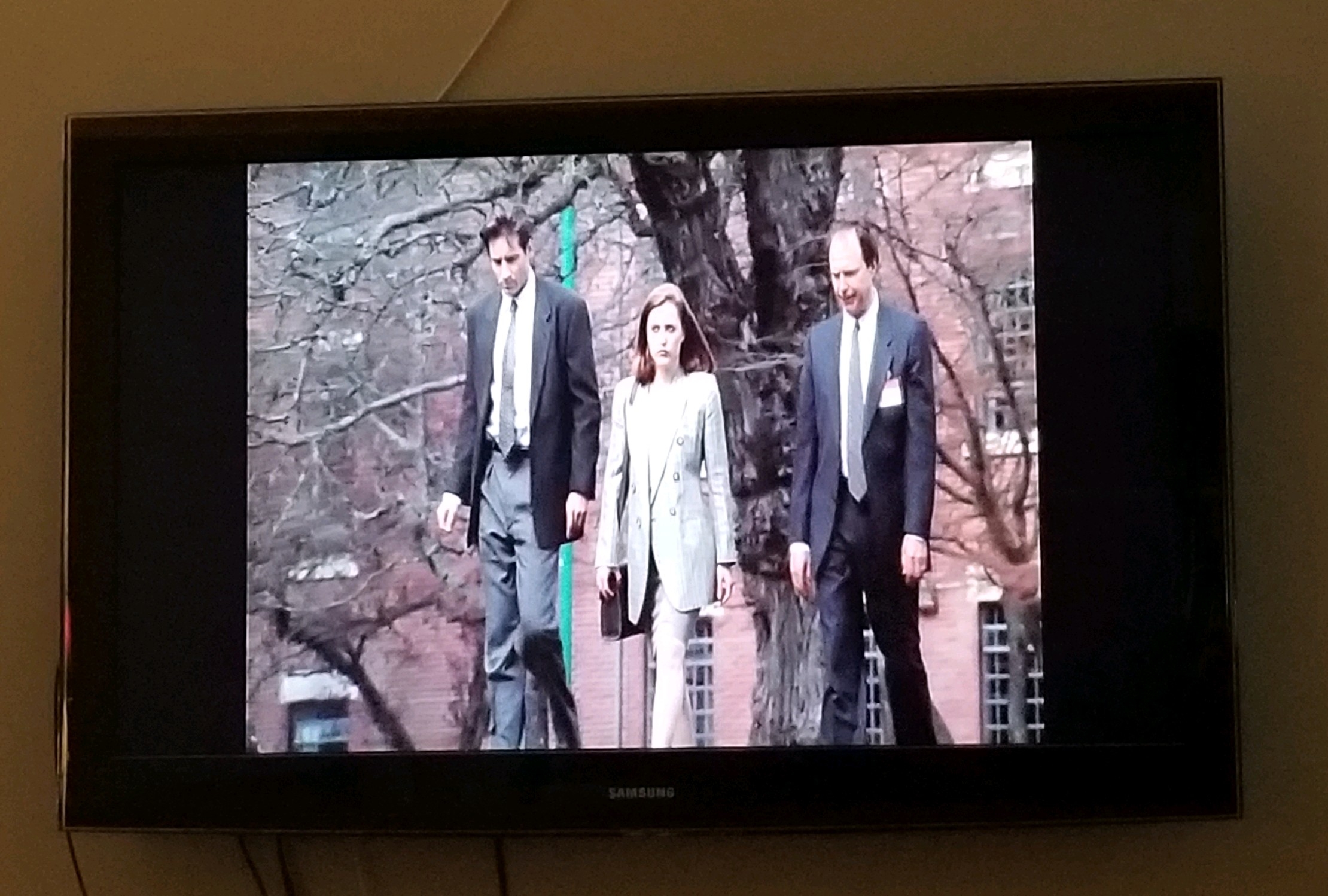

leejohns1972 7 Posted August 29, 2022 Author Posted August 29, 2022 Interesting update. My sister texted me last night...720p movie and the aspect ratio is wrong on the old, first gen AFTV.
leejohns1972 7 Posted August 29, 2022 Author Posted August 29, 2022 And I just had her try X-Files and it is wrong now too. When she first upgraded to the latest client, it was fine for a day, now it is wonky like mine
ebr 16337 Posted August 30, 2022 Posted August 30, 2022 Hi. Your first picture looks like bars are encoded in the video. On the second one, does she have a zoom option to correct it?

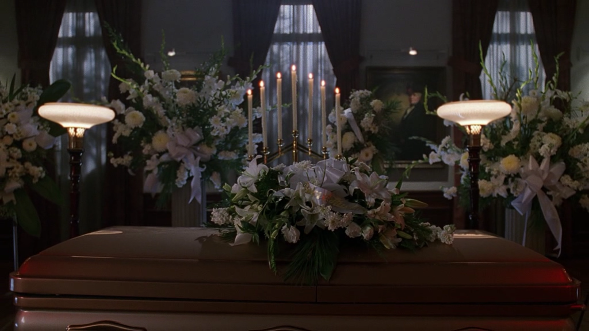

leejohns1972 7 Posted August 30, 2022 Author Posted August 30, 2022 She doesn't know how to set any of that , so none of her settings have changed since the other day when we first upgraded to the latest client and it appeared everything was fine. That hardware is really old and most people are not using it anymore, so I am not sure it is worth the effort to track down the root cause. I have switched back to Kodi as my front end client and going to set that up for her as well. Just as a reference, here is what X-Files looked like for her immediately after the upgrade to v2.077a the other day that she sent me.
ebr 16337 Posted August 30, 2022 Posted August 30, 2022 6 minutes ago, leejohns1972 said: Just as a reference, here is what X-Files looked like for her immediately after the upgrade to v2.077a the other day that she sent me. Is this the exact same file as the other image (with incorrect aspect)?
leejohns1972 7 Posted August 30, 2022 Author Posted August 30, 2022 I am not 100% sure. I know I have randomly tried various episodes across multiple seasons and they all exhibit the issue.
