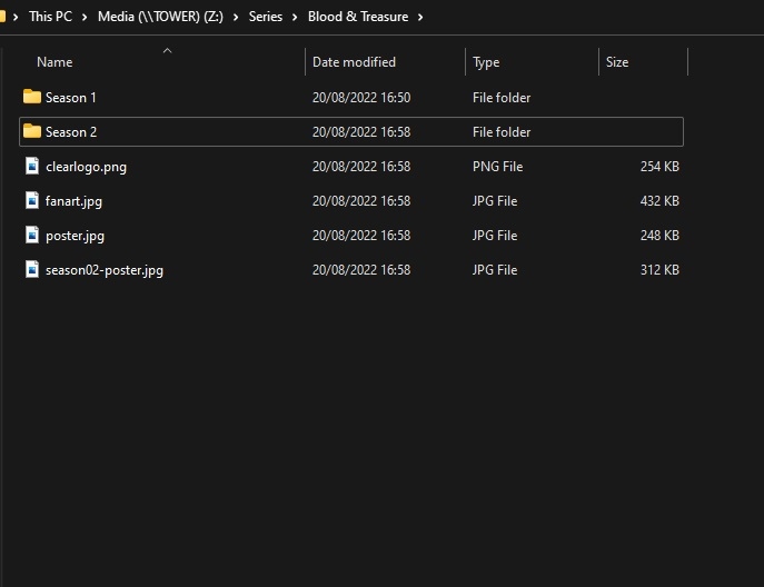

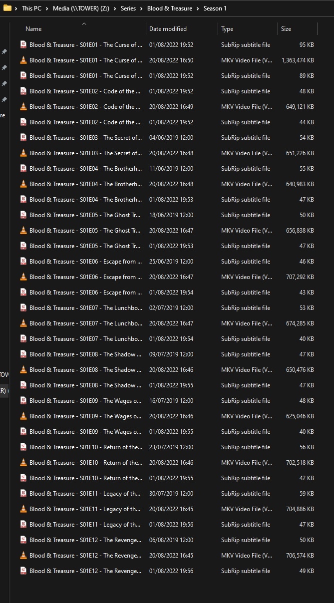

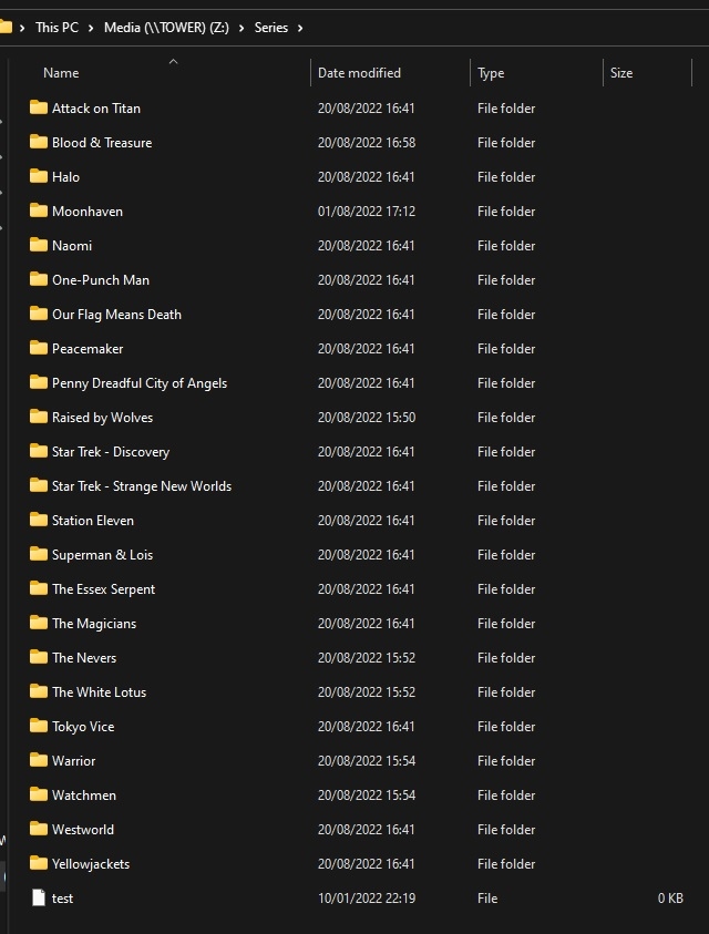

So I have Emby running on unraid, it finds all of my series and movies. Altough there are problems with 2 series, it wont find most of the episodes. The series in question are Blood & Treasure and The Essex Serpent, from the first it only detects the 6th episode of season 2 and for the other it only finds the 6th of season 1. Tried renaming the folders and moving them but no luck. Added folder structures and the logfile

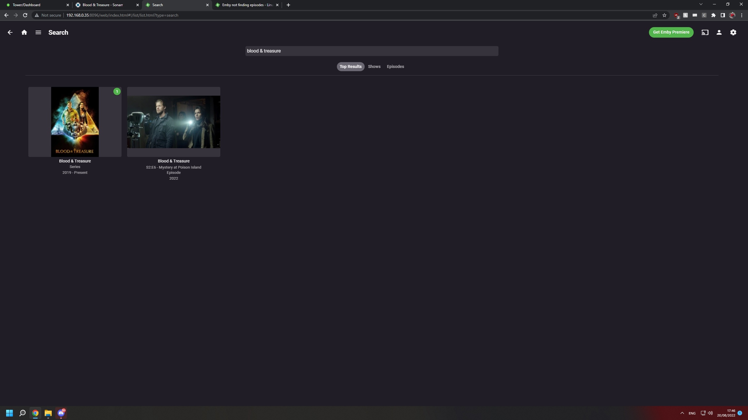

Ah nope it only shows that same episode s02e06, nothing else
What did it search for?
This is what I get
