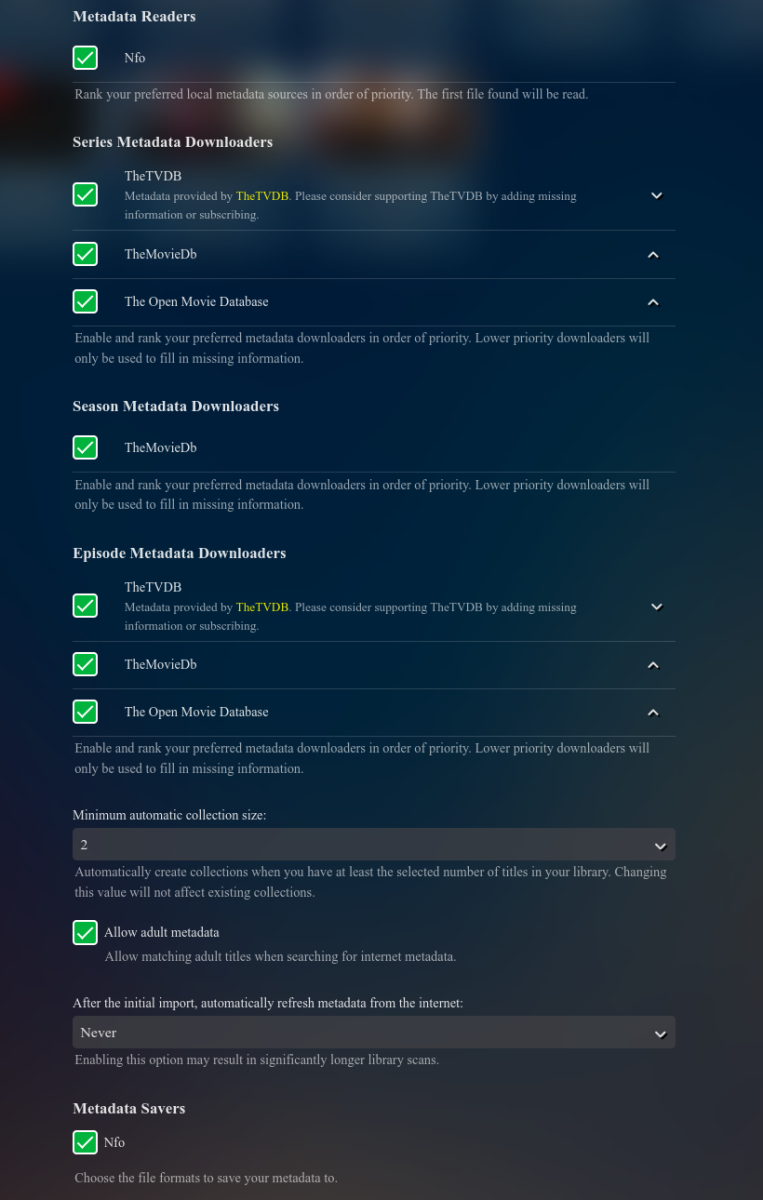

Luke 42245 Posted October 11, 2022 Posted October 11, 2022 In the options for the library, what series and episode metadata providers are enabled, and in what order? Can you please show a screenshot of that? Thanks.
Normanos 13 Posted October 12, 2022 Author Posted October 12, 2022 @Luke Default is TVDB P.s. In settings its have this: "Metadata provided by TheTVDB. Please consider supporting TheTVDB by adding missing information or subscribing." But TVDB Plgin don't have any configuration options.
