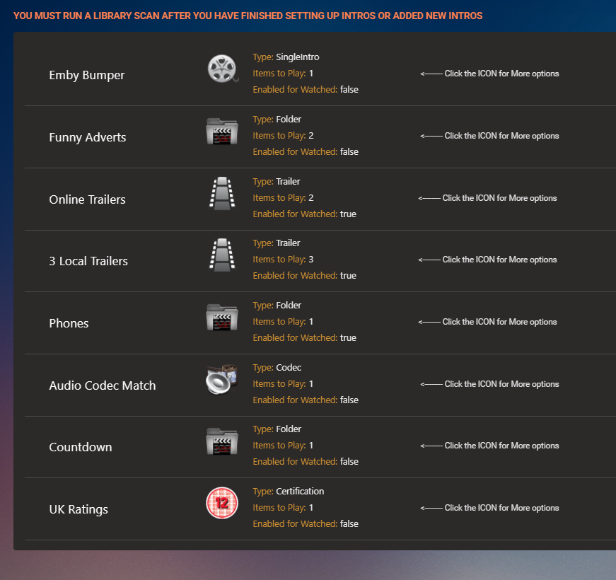

Eigeplackter 92 Posted December 29, 2022 Posted December 29, 2022 Okay I got it setup with 3 Intros 1st one custom intro 2nd Audio Tag Intro 3rd Video Tag Intro All are set to play, even with status watched. Problems: - In Webgui 1st intro stops playing at 0:10, but the full video is 0:19/0:20 long, movie doesn't start at all - In Emby Theatre App 1st intro plays full length, but as I use MPC-HC as external player, nothing else happens. I have to manually exit the player than movie starts playing - In Kodi (emby-next-gen BETA 7.13.3+ MPC-HC+MadVR) Cinema Intros, after syncing, doesn't work at all, I get pushed back to main screen. Opening playback w/o cinema intros takes like 30 secs for opening (regulary in under 10 secs) and plays no trailer at all, movie just starts. Any insights on that ? Maybe point me in the right direction ?
Cheesegeezer 3106 Posted December 29, 2022 Author Posted December 29, 2022 2 minutes ago, Eigeplackter said: Okay I got it setup with 3 Intros 1st one custom intro 2nd Audio Tag Intro 3rd Video Tag Intro All are set to play, even with status watched. Problems: - In Webgui 1st intro stops playing at 0:10, but the full video is 0:19/0:20 long, movie doesn't start at all - In Emby Theatre App 1st intro plays full length, but as I use MPC-HC as external player, nothing else happens. I have to manually exit the player than movie starts playing - In Kodi (emby-next-gen BETA 7.13.3+ MPC-HC+MadVR) Cinema Intros, after syncing, doesn't work at all, I get pushed back to main screen. Opening playback w/o cinema intros takes like 30 secs for opening (regulary in under 10 secs) and plays no trailer at all, movie just starts. Any insights on that ? Maybe point me in the right direction ? Can you set your server logs to debug. Then rotate the log in the schedule tasks. Then post the log for me or PM me if you have sensitive stuff you don't want others seeing. I can take a look. But i can tell you that these might be bugs in the Clients. I have noticed that when some stuff i'm getting playback stops also on Beta Server 4.8.0.21, however i would suggest you stick to Release versions. All the plugin does is put together a playlist in well under a second and then the clients honour that playlist before the movie/episode starts as you can see here in the log. 1

Tremas 205 Posted January 17, 2023 Posted January 17, 2023 (edited) I am wondering if anyone else is having this problem. I use local trailers exclusively and every time the plug-in generates trailers it always starts by showing a trailer for the movie I am watching. In other words, if I click play on Casablanca I get all of my intros as expected but when it gets to the trailers section it always starts by showing the trailer for Casablanca. This wasn't happening when I first installed the new Vantage Point - I think it's only been since the 2.1.0.5 update (but I can't say for sure). Edited January 17, 2023 by Tremas
Cheesegeezer 3106 Posted January 17, 2023 Author Posted January 17, 2023 5 hours ago, Tremas said: I am wondering if anyone else is having this problem. I use local trailers exclusively and every time the plug generates trailers it always starts by showing a trailer for the movie I am watching. In other words, if I click play on Casablanca I get all of my intros as expected but when it gets to the trailers section it always starts by showing the trailer for Casablanca. This wasn't happening when I first installed the new Vantage Point - I think it's only been since the 2.1.0.5 update (but I can't say for sure). I will take a look and see if i can reproduce. Cheers
Cheesegeezer 3106 Posted January 17, 2023 Author Posted January 17, 2023 @Tremas so i have set up my 3 intros same as yours and plugged it into my line up. I can confirm that i can reproduce this issue, i will try to take a look today, no promises tho

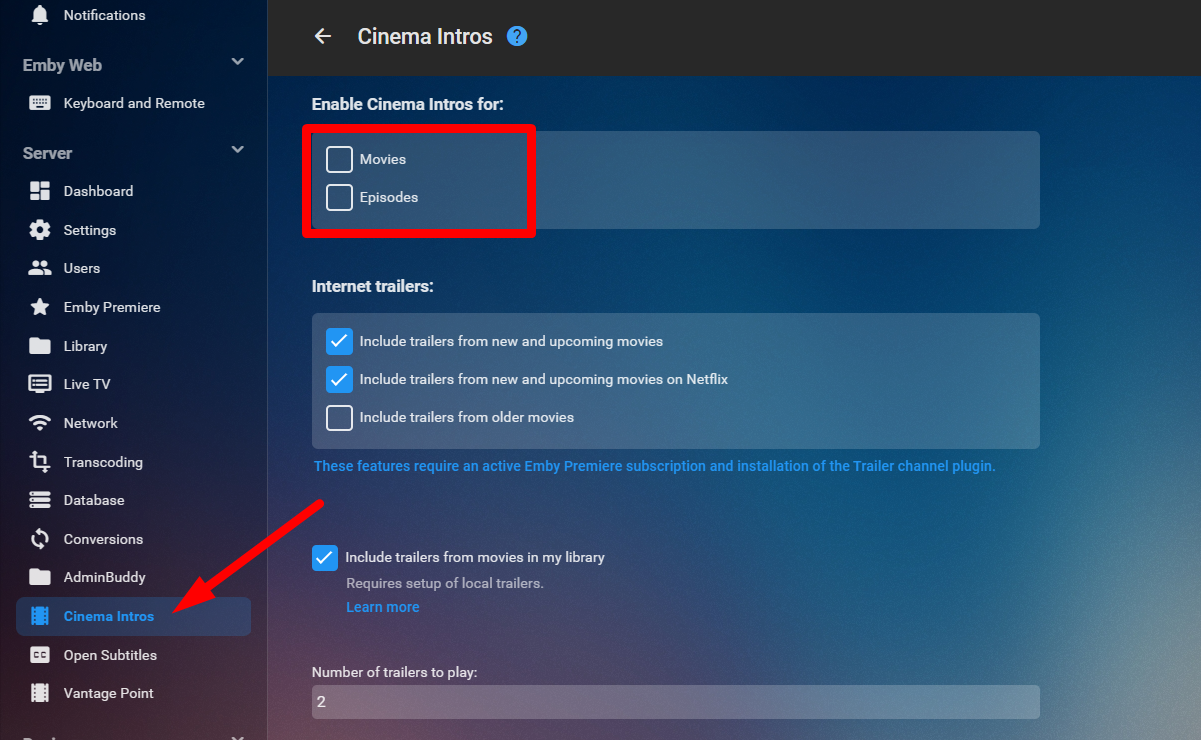

grid-hibiscus-pancake 6 Posted February 7, 2023 Posted February 7, 2023 I am having trouble getting anything to play for some reason. I got the starter pack etc... Cinema trailers are enabled in the playback page and the plugin is enabled too, however just the main feature plays. Any idea? No matter what I do, in the browser, no preroll play.
Cheesegeezer 3106 Posted February 8, 2023 Author Posted February 8, 2023 (edited) 2 hours ago, grid-hibiscus-pancake said: I am having trouble getting anything to play for some reason. I got the starter pack etc... Cinema trailers are enabled in the playback page and the plugin is enabled too, however just the main feature plays. Any idea? No matter what I do, in the browser, no preroll play. A server debug log would be helpful. do you have the cinema Intros plugin installed also? This needs to be installed but disabled for both movies and tv episodes have you run a library scan after adding your intros? ill run a test now myself. cheers EDIT: THESE ARE MY SETTINGS CINEMA INTROS PLUGIN NEEDS TO BE INSTALLED BUT DISABLED PLAYBACK MENU: ENSURE THAT "ENABLE CINEMA INTROS" IS CHECKED SETUP YOUR VANTAGE POINT INTROS FINALLY GO TO THE SCHEDULED TASK MENU AND RUN THE LIBRARY SCAN TASK: To create a Debug Server Log... Follow these steps. Go to the logs menu and ensure debug logging is enabled. Then go to Scheduled tasks and Rotate the log Then go and play a movie. Your intros will be created before even the first intro has completed. Finally one last thing. Check settings for a played movie for each intro. You need to set enable for watched content to on if you want these intros to play for already watched items. Edited February 8, 2023 by Cheesegeezer
