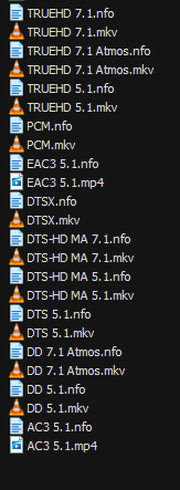

amateurgod 33 Posted December 28, 2022 Posted December 28, 2022 (edited) Im having an issue at the moment where it will play all of the intros just fine except for the audio codecs, this is how i have my audio codec intros names, is there a specific way i should be naming these for it to work? or could it be something else Edited December 28, 2022 by amateurgod
Cheesegeezer 3106 Posted December 28, 2022 Author Posted December 28, 2022 50 minutes ago, amateurgod said: Im having an issue at the moment where it will play all of the intros just fine except for the audio codecs, this is how i have my audio codec intros names, is there a specific way i should be naming these for it to work? or could it be something else Hi there is needs to match the codec property what emby shows on details screen. Or the embedded title 1
amateurgod 33 Posted December 28, 2022 Posted December 28, 2022 51 minutes ago, Cheesegeezer said: Hi there is needs to match the codec property what emby shows on details screen. Or the embedded title Thank you, i shall upload some that match the codec from the details section exactly ie DTS.mkv instead of DTS 5.1.mkv 1

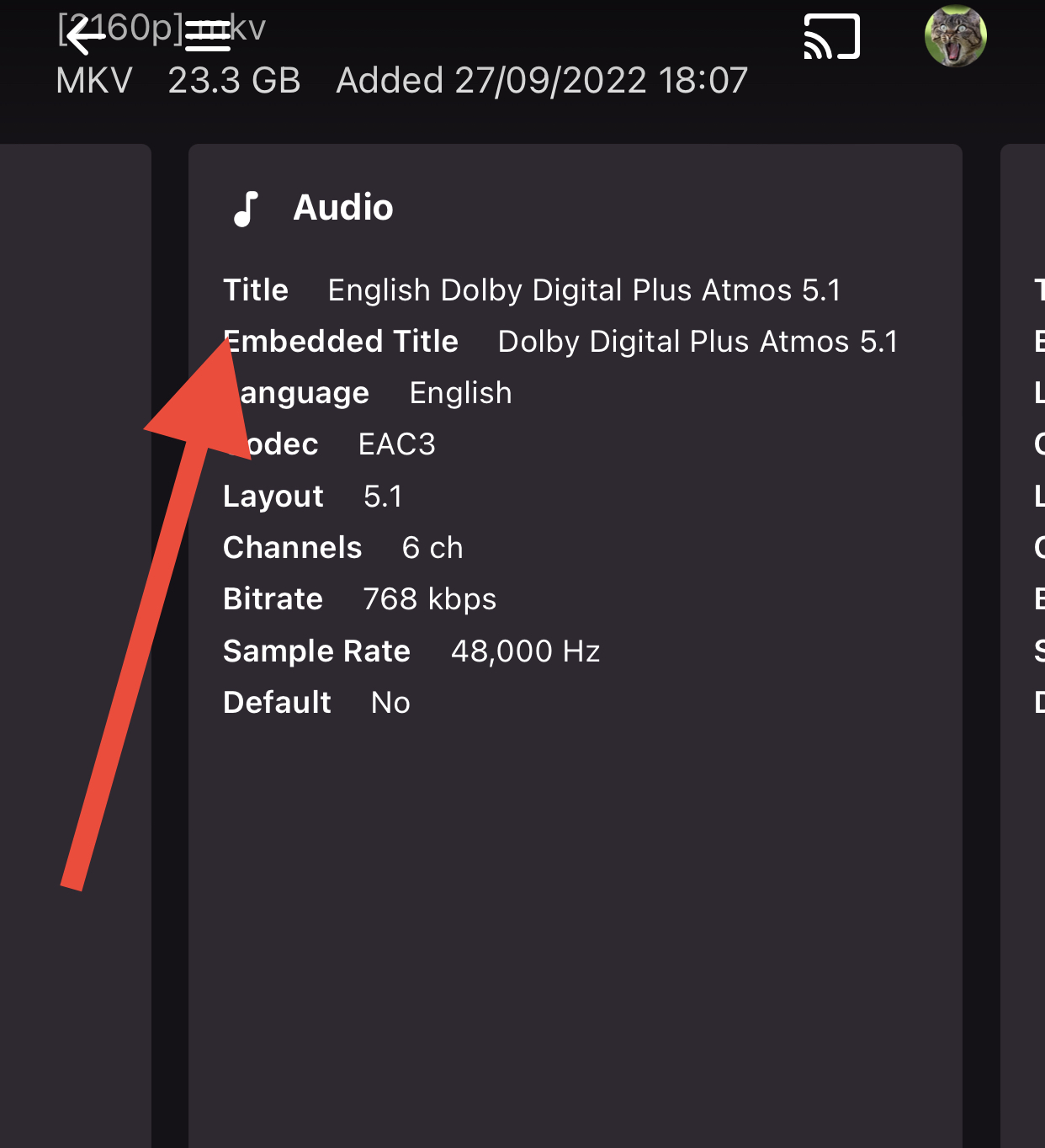

Eigeplackter 92 Posted December 29, 2022 Posted December 29, 2022 Is there a problem with multiple audio tracks in 1 file ? Can't get an Codec-Intro running: English Dolby Digital Plus Atmos 5.1.mkv is the intro name PS: Can we have an EDIT button for VP ??
Cheesegeezer 3106 Posted December 29, 2022 Author Posted December 29, 2022 3 minutes ago, Eigeplackter said: Is there a problem with multiple audio tracks in 1 file ? Can't get an Codec-Intro running: English Dolby Digital Plus Atmos 5.1.mkv is the intro name To answer this question. The plugin actually only looks for the First Track in video, audio streams of the media item. So even tho you have your atmos track named correctly, it is actually the 2nd track so VP would never choose it anyway. Which Audio Track do you have when you select the Movie? to play By that i mean selection on the detail page I could maybe check the streams that are being sent in playback manager, but i would need to get my head around that also, so wont be on the priority list. As I have other things i'm working on. 3 minutes ago, Eigeplackter said: PS: Can we have an EDIT button for VP ?? I have thought about it but it's a lot of extra work for very little gain. The thing to do is delete and make a new one. for a few hours work for me (my Javascript is not good at all) against about 2mins work for the user, i decided not to do it. 1
