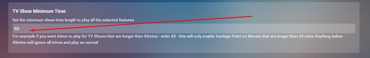

Cheesegeezer 3106 Posted October 22, 2022 Author Posted October 22, 2022 @unisoft just a quick one, is the time frame for the episode set above the episode runtime
unisoft 355 Posted October 22, 2022 Posted October 22, 2022 2 minutes ago, Cheesegeezer said: @unisoft just a quick one, is the time frame for the episode set above the episode runtime yes was 10 minutes but tried changing to 20 to see if that change did anything. Looking though the emby log right now there is nothing beginning "Vantage" apart from recording of the Vantage plugin version number.
