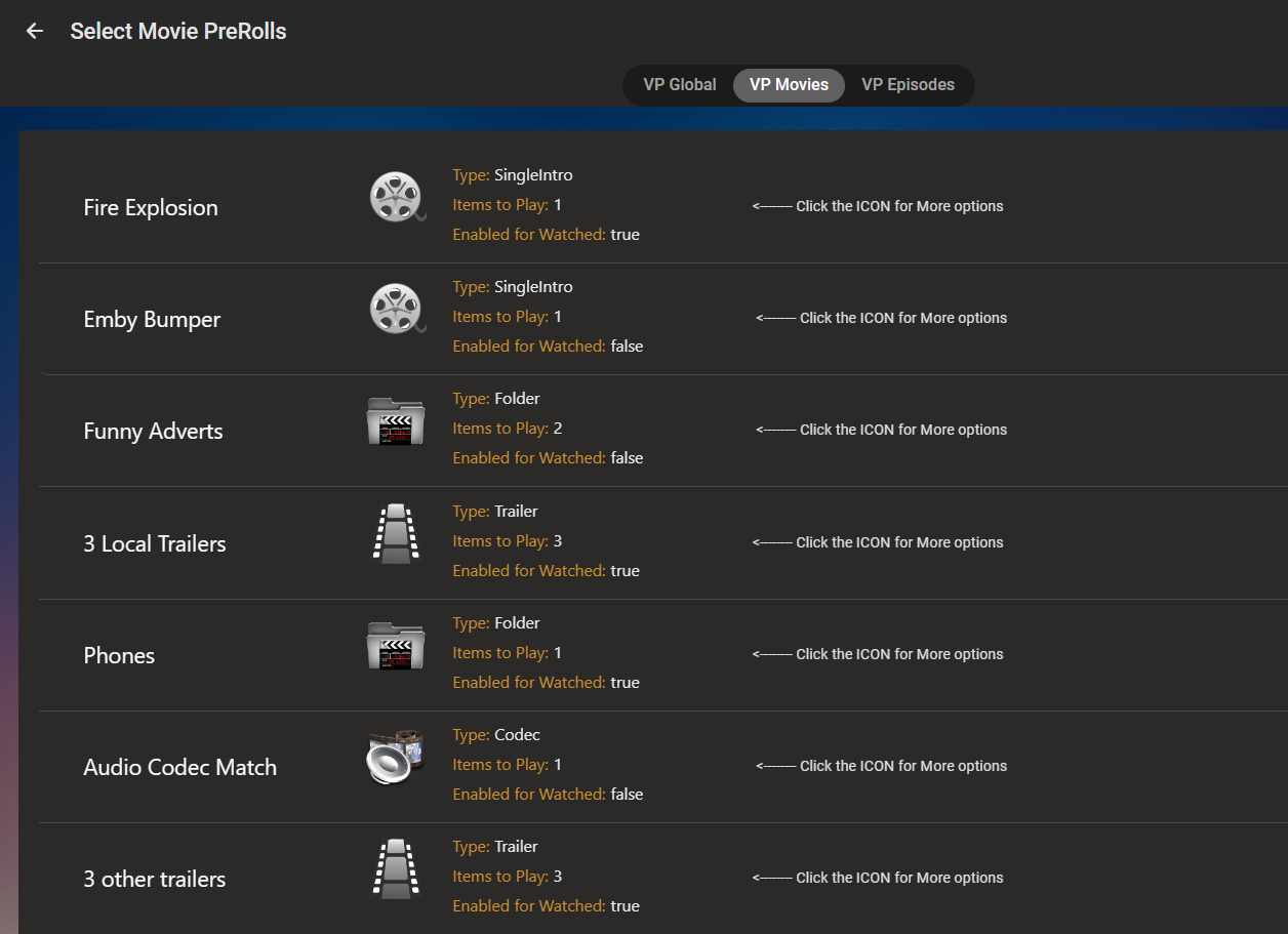

Spaceboy 2573 Posted March 12, 2023 Posted March 12, 2023 Hi, sorry but i can't get Vantage Point to play back any intros. Cinema mode works fine and the config of VP works fine but the intros never play. the log is from a beta install but i get the same results on stable. i'm just asking it to play back one single named intro for testing. the intro plays fine in emby embyserver(17).txt cheers

Cheesegeezer 3106 Posted March 31, 2023 Author Posted March 31, 2023 8 minutes ago, Spaceboy said: hi dave, just wondered whether you'd missed my post above or assumed that i was also running beta, but for some reason i cant get VP to work at all for me on stable. However there is no rush and if you would prefer to wait until 4.8 goes stable and look at all of these issues then that is fine with me. cheers Sorry Buddy, i really did miss it, let me take a look at your post. In the meantime can you, set log to debug, rotate the log and then play your movie. also send me the config file (in PM if you wish) and the log. i wanna see what it's wants to do against what its actually doing.
Cheesegeezer 3106 Posted March 31, 2023 Author Posted March 31, 2023 you've already given me the log hahahaha so only 1 intro and thats the fire explosion one and it doesn't want to play.
Spaceboy 2573 Posted March 31, 2023 Posted March 31, 2023 25 minutes ago, Cheesegeezer said: you've already given me the log hahahaha so only 1 intro and thats the fire explosion one and it doesn't want to play. no worries at all. yep - its weird, i can't see why it won't play. the video plays fine when added to emby as part of a normal library. i've also tried it on a couple of beta installs that i run but no go there either. can provide the vid if you want, but i don't think its that
Cheesegeezer 3106 Posted March 31, 2023 Author Posted March 31, 2023 8 minutes ago, Spaceboy said: no worries at all. yep - its weird, i can't see why it won't play. the video plays fine when added to emby as part of a normal library. i've also tried it on a couple of beta installs that i run but no go there either. can provide the vid if you want, but i don't think its that i have had this before with another user, he had a video file that didn't want to play either. Send it over anyways and i'll test on my system. I'm on windows 10, 4.7.11 server release and scratching my head lol
Spaceboy 2573 Posted March 31, 2023 Posted March 31, 2023 9 minutes ago, Cheesegeezer said: i have had this before with another user, he had a video file that didn't want to play either. Send it over anyways and i'll test on my system. I'm on windows 10, 4.7.11 server release and scratching my head lol windows 11 for me but same server version. vid is attached, its just one of the intros someone uploaded 6months or so back. i'll be honest, most of my testing has been done on beta because my large library and associated 90min scan times make testing it on my stable install a challenge . but i'll set up another stable instance with almost no media and see what i get there Emby-Fire-Explosion.mp4
Cheesegeezer 3106 Posted March 31, 2023 Author Posted March 31, 2023 (edited) Works perfect for me. One thing you do need to have is CinemaIntros Plugin installed (Tested just now with V1.0.44) But make sure that the movies and tv show boxes are not ticked. That might be it Edited March 31, 2023 by Cheesegeezer 1
