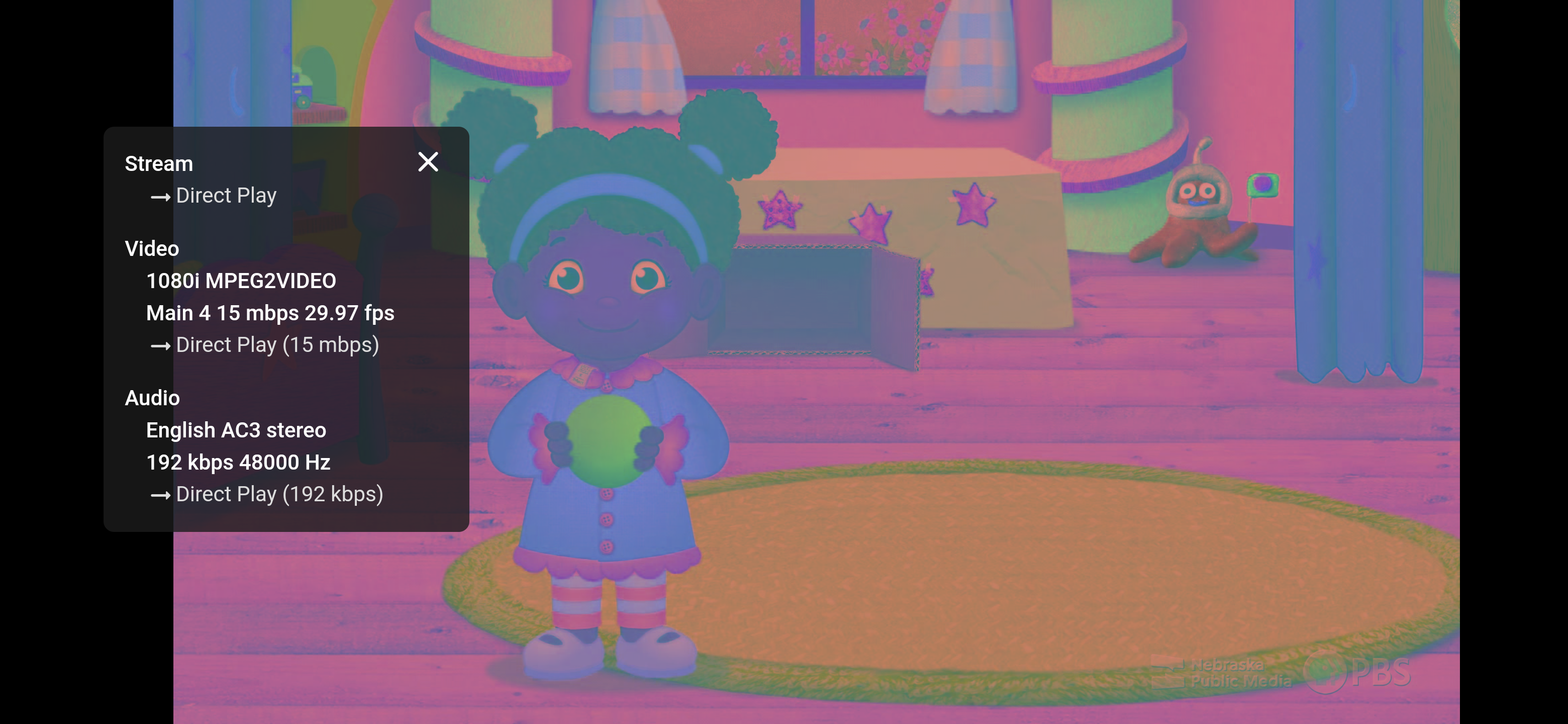

rdunsirn 2 Posted August 13, 2022 Posted August 13, 2022 (edited) On my Pixel 6a running the latest Android 13 beta 4, when playing Live TV or recorded TV using Direct playback, I'm seeing an issue where the colors are messed up as seen in the attached image. The video plays fine and the audio is fine, it's just the colors. When I manually tell the app to transcode by changing the quality setting, the problem goes away. It's only happening when using Direct play. This problem doesn't occur when using the Chrome browser, however I believe Chrome always forces the server to transcode in Android for live TV or recorded TV. I can grab some logs when I find them. Thanks! Edited August 13, 2022 by rdunsirn Added photo showing the stats for nerds 1

troyhough 61 Posted August 25, 2022 Posted August 25, 2022 Mine is doing the exact same thing. Pixel 6 Pro. Android 13. If I enable external video players and choose VLC it plays fine. If I force transcode, it looks fine. Plays back fine in VLC, Channels DVR, and HDHR app.

lightsout 156 Posted August 26, 2022 Posted August 26, 2022 I saw someone complain about this same issue with Facebook "reels" on a 6a. They had a screenshot and it was looked similar to the above shots. 1

Theogeek 6 Posted September 3, 2022 Posted September 3, 2022 (edited) This happens to me as well on a Pixel 6 and only with live TV. It also works if I use an external player like VLC. That's a non starter though because external players don't save progress. Edited September 3, 2022 by Theogeek 1

kdesloover 2 Posted October 8, 2022 Posted October 8, 2022 I have this issue as well, Pixel 6 Pro, Android 13, quality change is a workaround. 1 1
swhiting 3 Posted December 4, 2022 Posted December 4, 2022 I have a similar issue with my Pixel 7 Pro (Android 13). Every time I play a video through the app, I get the weird discolored look. The only solutions I have found so far are either setting the In-App settings for video playback to a lower quality which fixes the color issue but increases buffering since it now needs to be transcoded further, or accessing the videos via a web browser. Please fix this. 1
